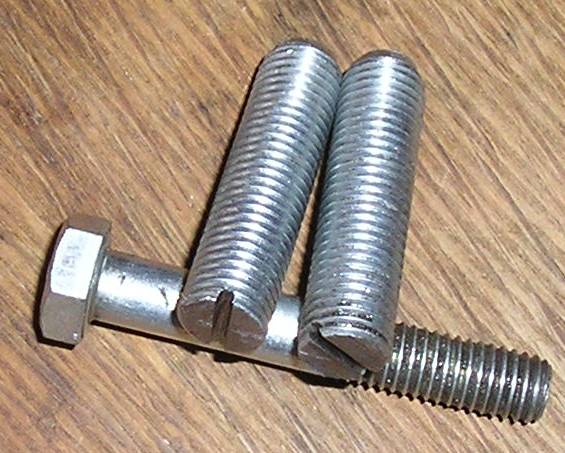

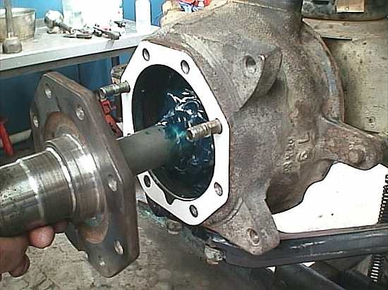

The other addendum I'd add is from Norm's web write up I used many moons ago when that was the only one on the web. It makes doing the rebuild solo much easier and I've used these buggers dozens of time. I don't have a pic but this would be during the rebuild pics in post #19. Place the headless bolts in the knuckle housing at 10 and 2 o'clock and re-assembly is SO much easier. The bottom bolt is threaded into the end of the axle stub to pull it out for the snap ring.
Ken, yeah, I figured if I actually took the time and read the entire thread it was all in there. Just like all the photos are somewhere between here and Morgan's or Norm's rebuild links in the Tech section.
This is the shot from Norm's rebuild and I'm fairly certain these are 10-mm x 1.25 pitch but I'll check. I made them using a dremel to cut the heads off and make the screwdrive slot.
edit: checked and they are 10-mm x 1.25 pitch and the length is 40-mm
The local Ace Hardware in town has automotive studs in 10-mm x 1.25 pitch and the length of 42-mm, where the bolts and screws are.
