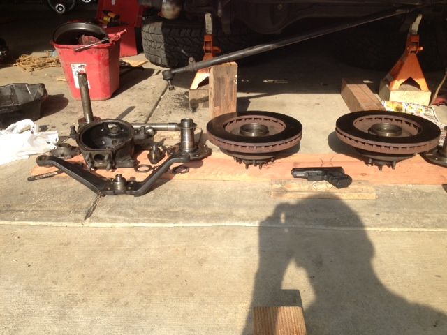

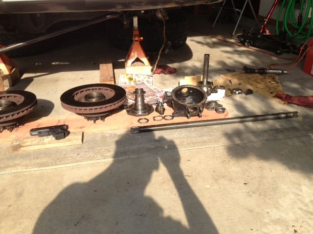

More LC porn Inspection
See what Goober did to the axle lock nuts and washer thing-ma lock...No proper tools and the play in there was very noticable. This thing has 190,000 miles and looks like this is her first time with a gentle fellow.:mad:
I would just clean any burr of it with a fine file, you will be ok, uh do you live in a nasty neighbourhood? that is a different tool than i used when i did my front axle!
Cheers P ;)
Thanks...BTW, the knuckle arm on the passenger side should be orientated short end front? Correct. Oh, that tool...it is a great tool for anything. :-)
Cheers P ;)
What, you've never been to Bakersfield? That's a front yard necessity my friend ;D
They issue those to you when you buy your tenth slurpee I hear...
