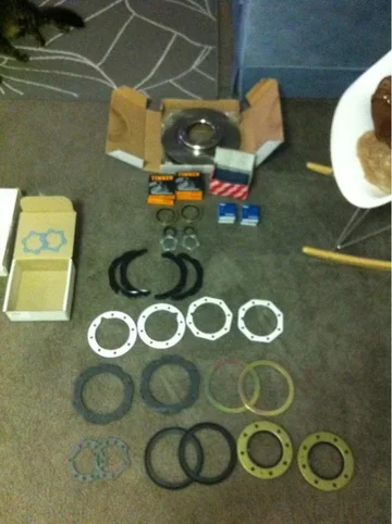

Here is the kit I ordered. What are the C clips that I am missing? See anything else I might need?

There are 2 sets of c-clips:
1. 90520-31007: outer c-clips that go outside of the spindle and underneath the drive flange.
2. 90521-34005: inner hole snap rings that keep the birf attached to the axle shaft.
You can probably reuse the outer ones.
The inners either get damaged or destroyed when separating the birf from the axle shaft.
