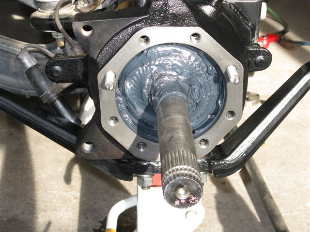

Some birf porn
I figured this could very well be my last birf job. I guess I could always break a birf but have done that already the chances of twice (Im hoping) would be rare.
I always take my time to make sure everything is 110% this time I just took a little more. :)
birf1-jpg.508937
birf2-jpg.508938
birf3-jpg.508939
Nice to see no corrosion on the swivel balls, is that due to the location (s) or did either poster above clean them up?
