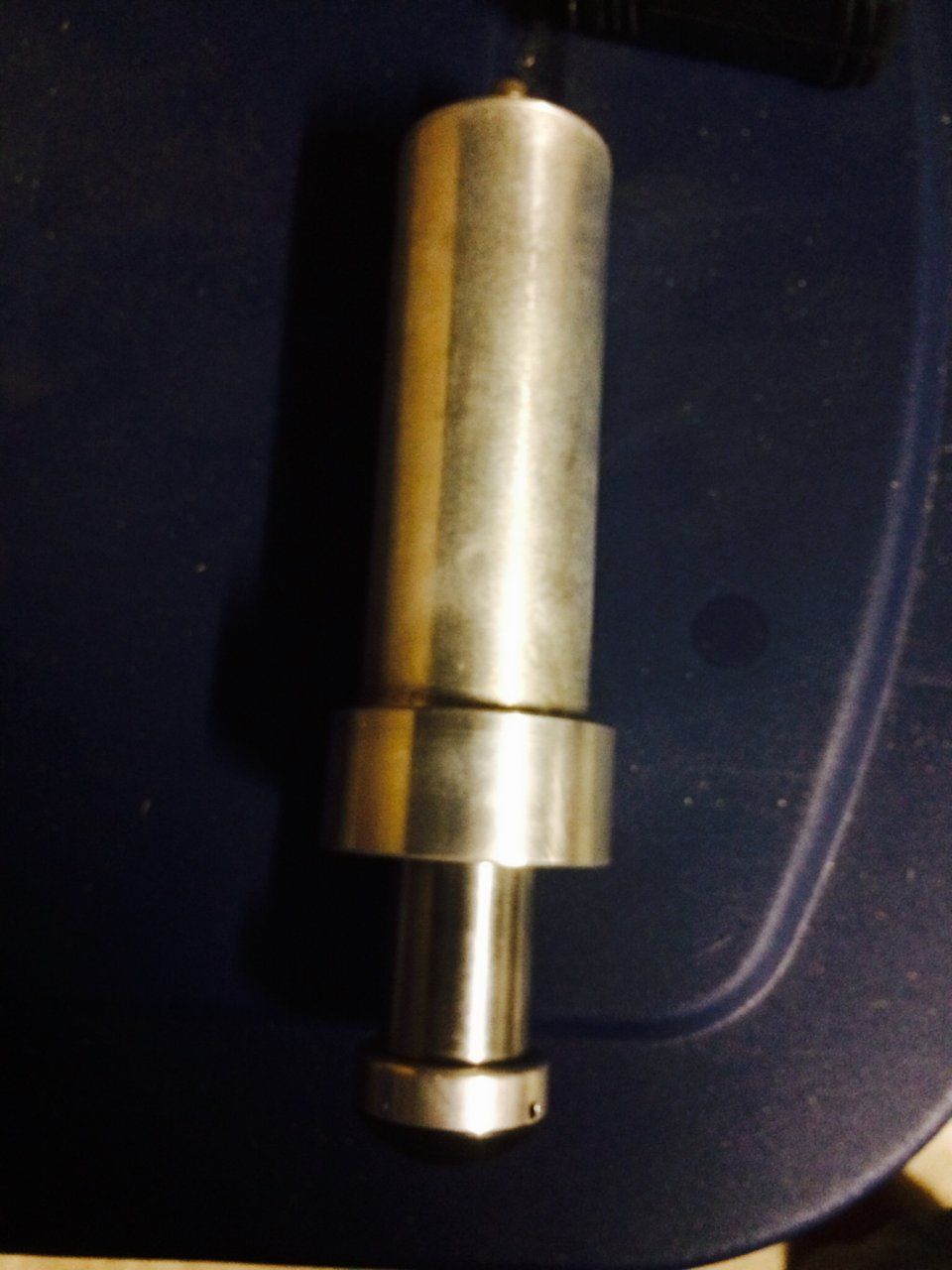

Well to answer the question at hand.. this is the entire reason i opted for air bumps. I have used standard poly bumps on past rigs and couldnt stand when the suspension would max out resulting in a hard bump. Since installing these, it has probably been one of the single greatest mods i have ever done. On road, you cannot feel or hear anything from the air bumps.. even if they are making contact. As well as, offroad it feels smooth until the air bump is maxed out then a nice transition into body roll. So with comparison in mind, night and day difference, even when rock crawling. Just my 2 cents.
They're expensive little fxxxers, but you're description is the reason I'd be considering air bumps. I freaking hate the feeling of hitting a poly bump.
