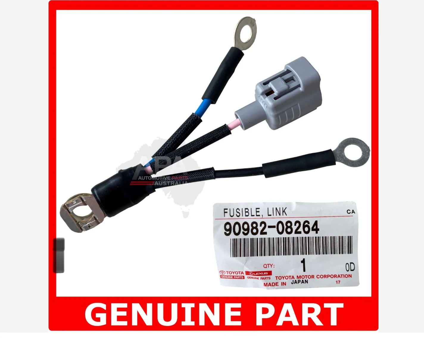

Matthew, great to see you onboard here. I like your one wire FL replacement. Please tell us why Toyota combines 3 wires in their FL design?

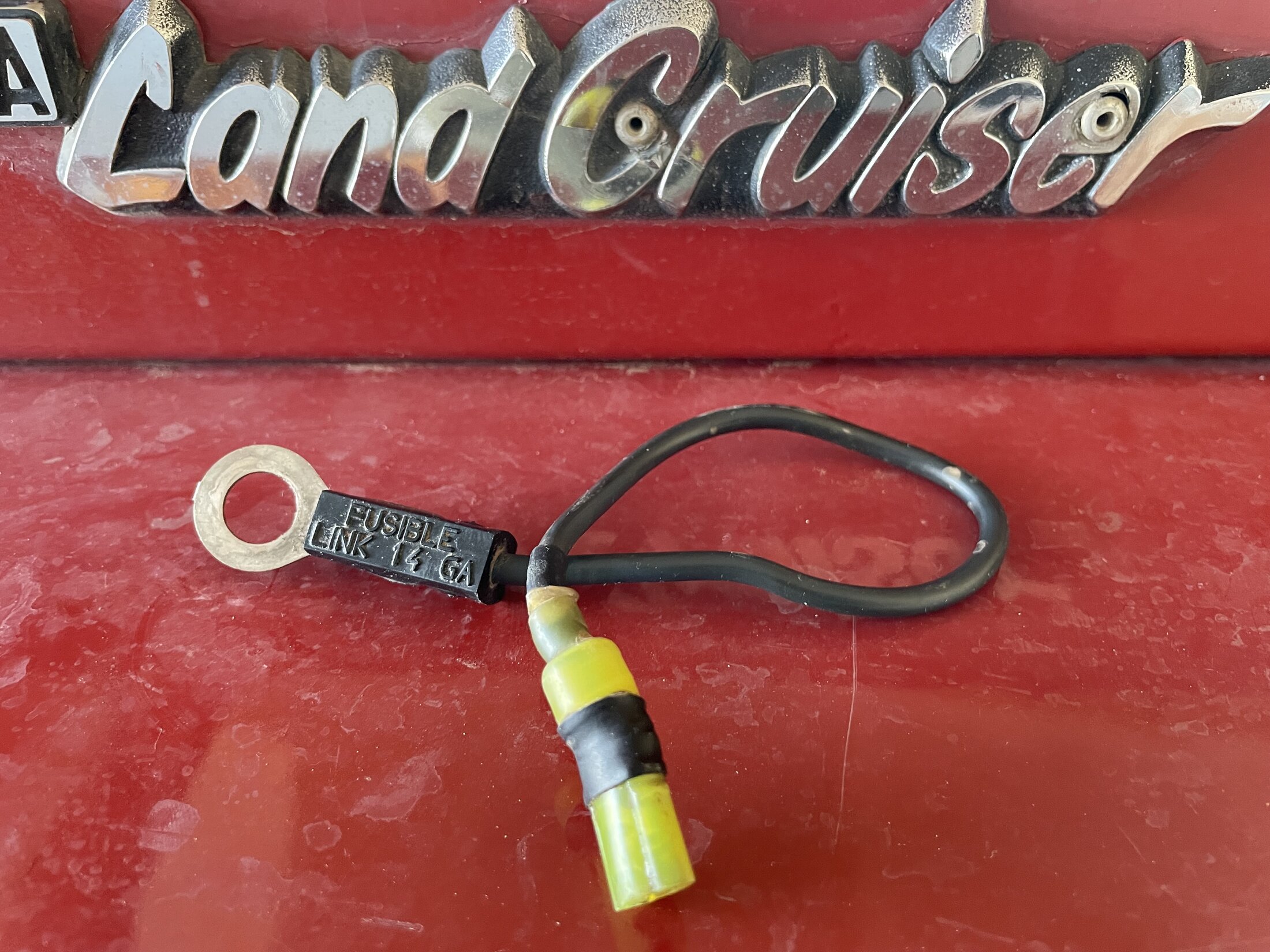

And if I have your attention, what FL is appropriate for a 1981 FJ43 which didn’t come with one? I added a 14G link wire.

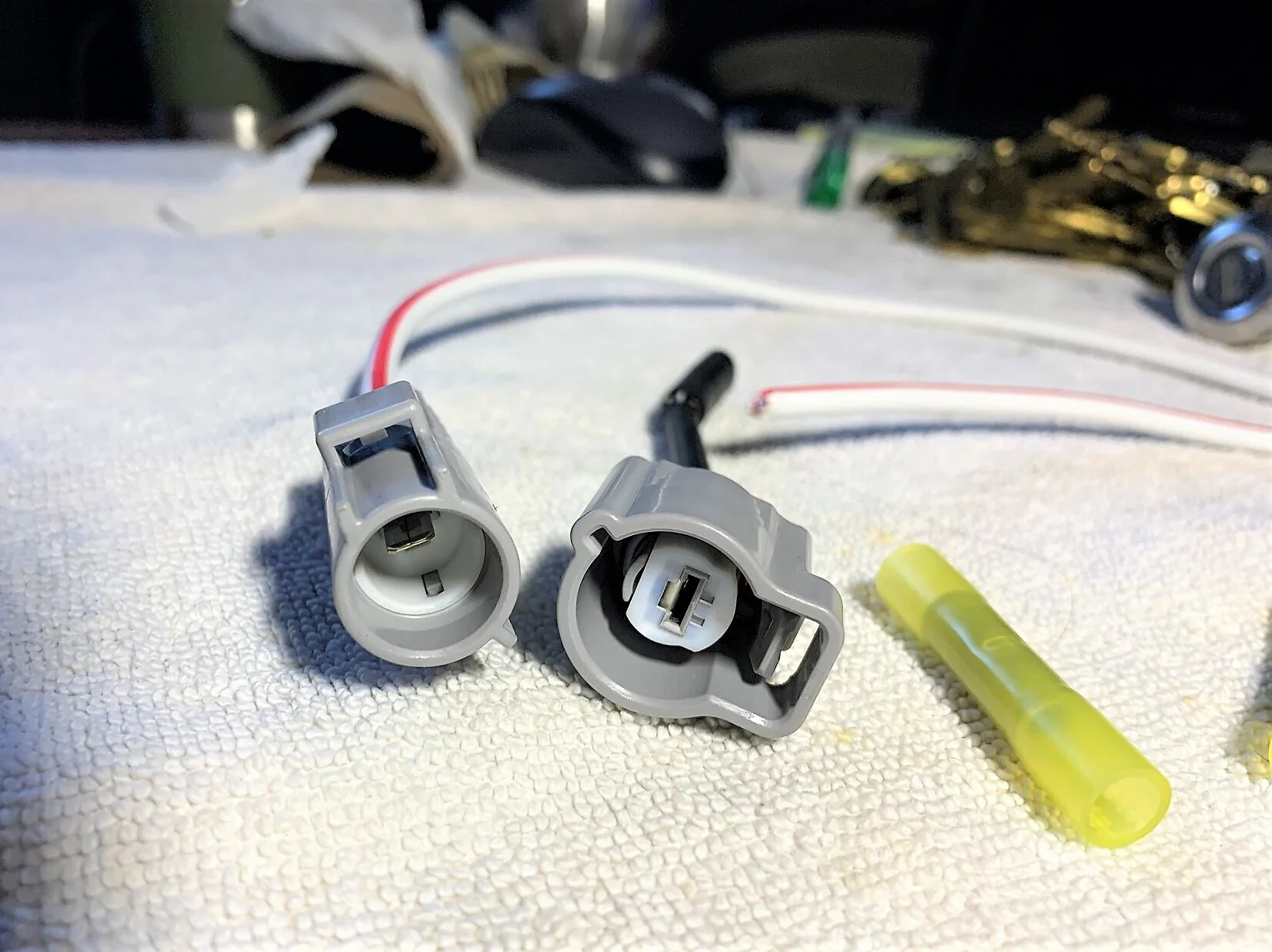

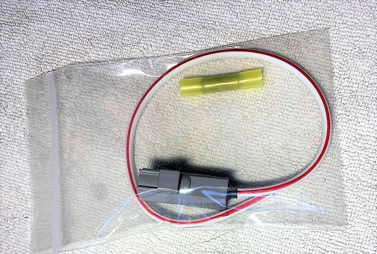

Thank you mr Bob , nice to see you again sir ....:)
My 90982-00080 kit-form-kit is NOT a fusible link , it is simply the main engine bay wire harness side correct OEM mating and matching connector plug , i crimp the correct 10ga oem color coded Tracer Striped wire on as a service pigtail assy and include a 3M crimp heat shrink adhesive lined butt connector too , this is the absolute BEST way to repair a BURNED up connection point of the main 90982-08264 fusible links grey plug and the one on the harness side by the FS , Factory Fit , Form and Function .......
- i will circle back later tonight and show more tech pics of what is going on inside that OEM harness side plug and what should be expected and needed in this critical connection point where details matter and matter do details
