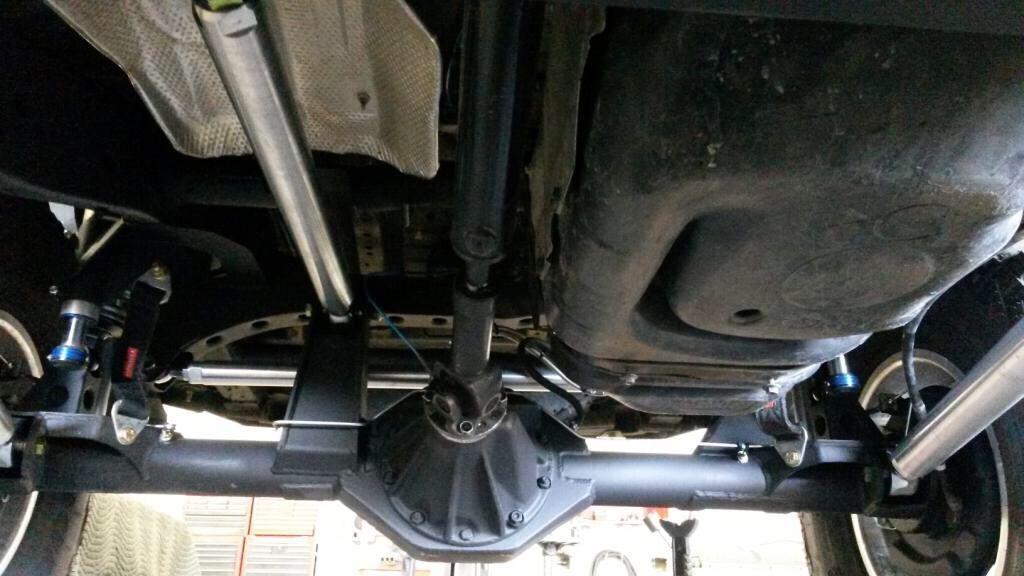

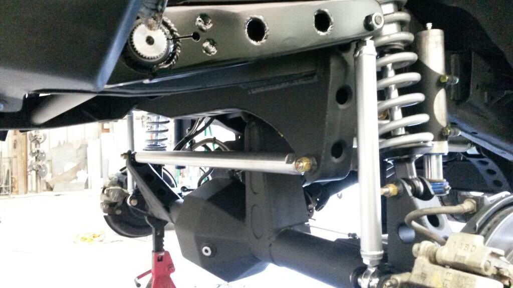

I got to drive my FJC this afternoon. OMG! Completely blown away with how it drives. With and without the swaybar it handles amazing. No brake dive, no over or under steer, no roll steer, no wandering or boating. Absolutely driveable without the swaybar and turns into a slot car with the swaybar connected. The wider spring track front and rear makes a huge difference in stability. The coilovers in the rear just flat out work.

Did you bend those A/C lines by hand, or sneak a big fuel/brake line bender in there?

Potentially dumb question, but is there no reason to truss an RS housing, even with a 6,000lb fat ass riding on them?
Well thats a Diamond axle not a RS but regardless, Not really is the answer. Or at least not unless you're racing.
It all depends. People seem to forget that spring / coil locations and link locations will change the loading of the housing.
