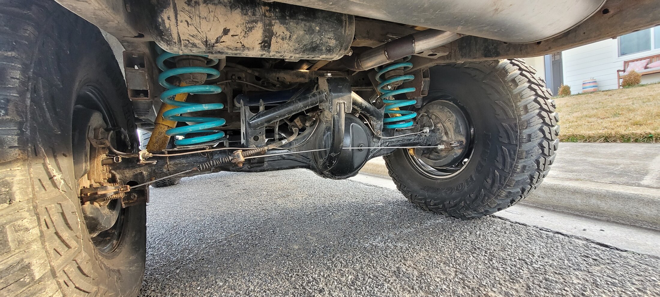

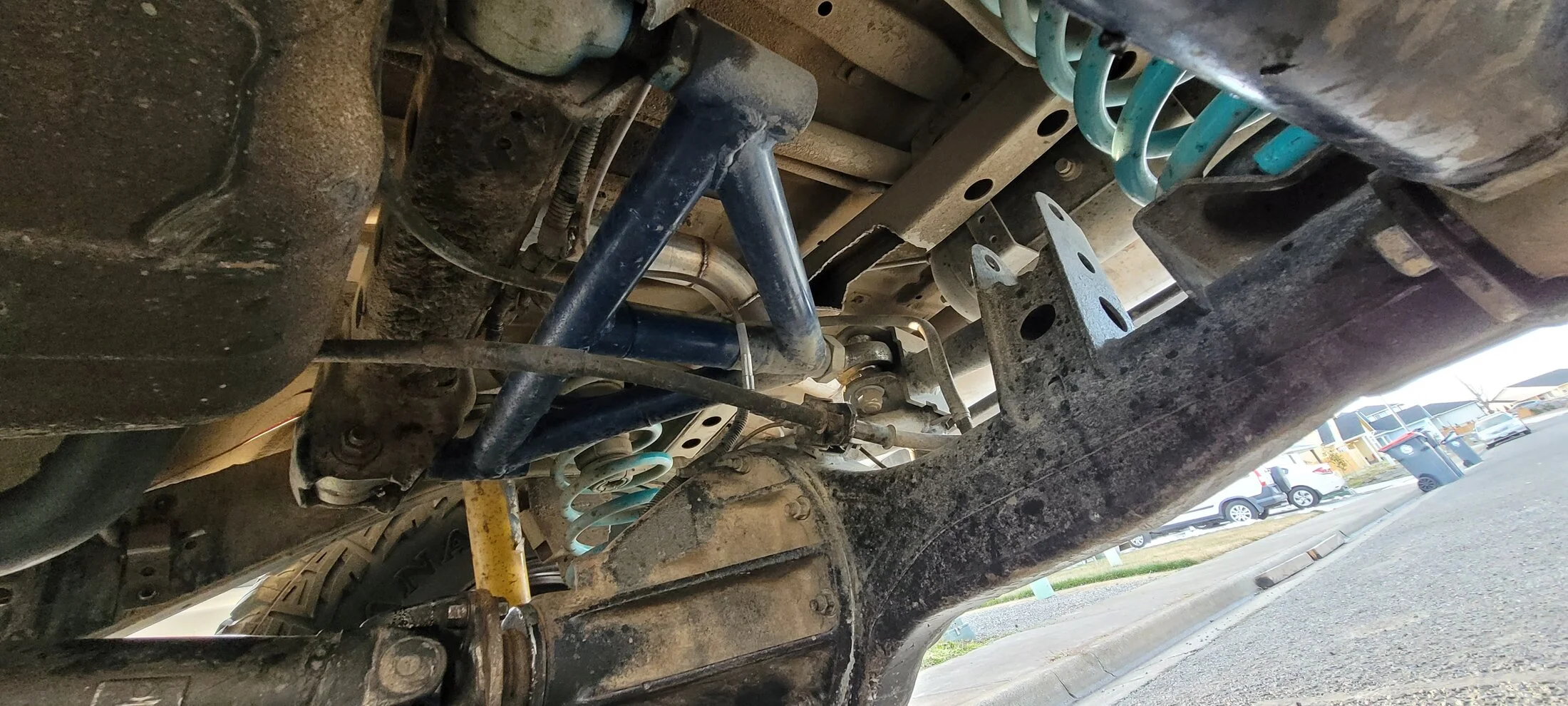

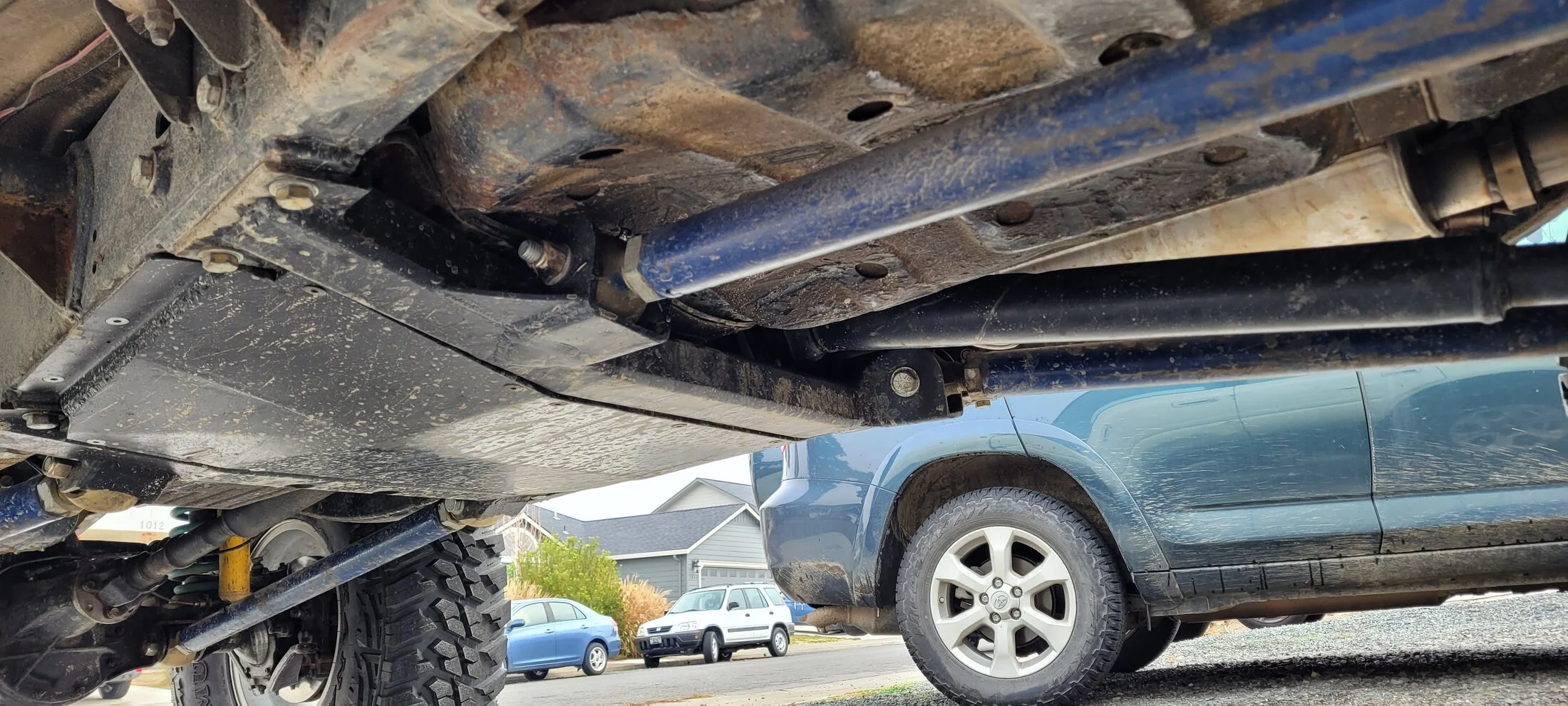

I duplicated Nukegoats with some number changes for my lift and it works really well, much nicer than factory for my use. Yes, I'd like longer uppers, but don't and still don't have the motivation to deal with the fuel tank.
I looked and looked for details on your setup after seeking photos of it in the Kanati tire thread….I ordered those same tires as you put on yours after seeing those pics. Bitchin truck. Can you share some photos of your rear setup?
After ditching the panhard, why not push the rear axle back to achieve your desired longer uppers?

I don't have a build thread going, basically it'd be a bunch of random photos that I upload and update every two years...
Someday I might, but at the time I didn't have the time to rework the rear body. Was planning in doing a ute chop with a flat bed, but every winter realize how nice it is to sleep inside the back :D. But I did tell my self it will happen when I blow out the third hatch window, which I am currently on..
Here are a couple of my rear.
