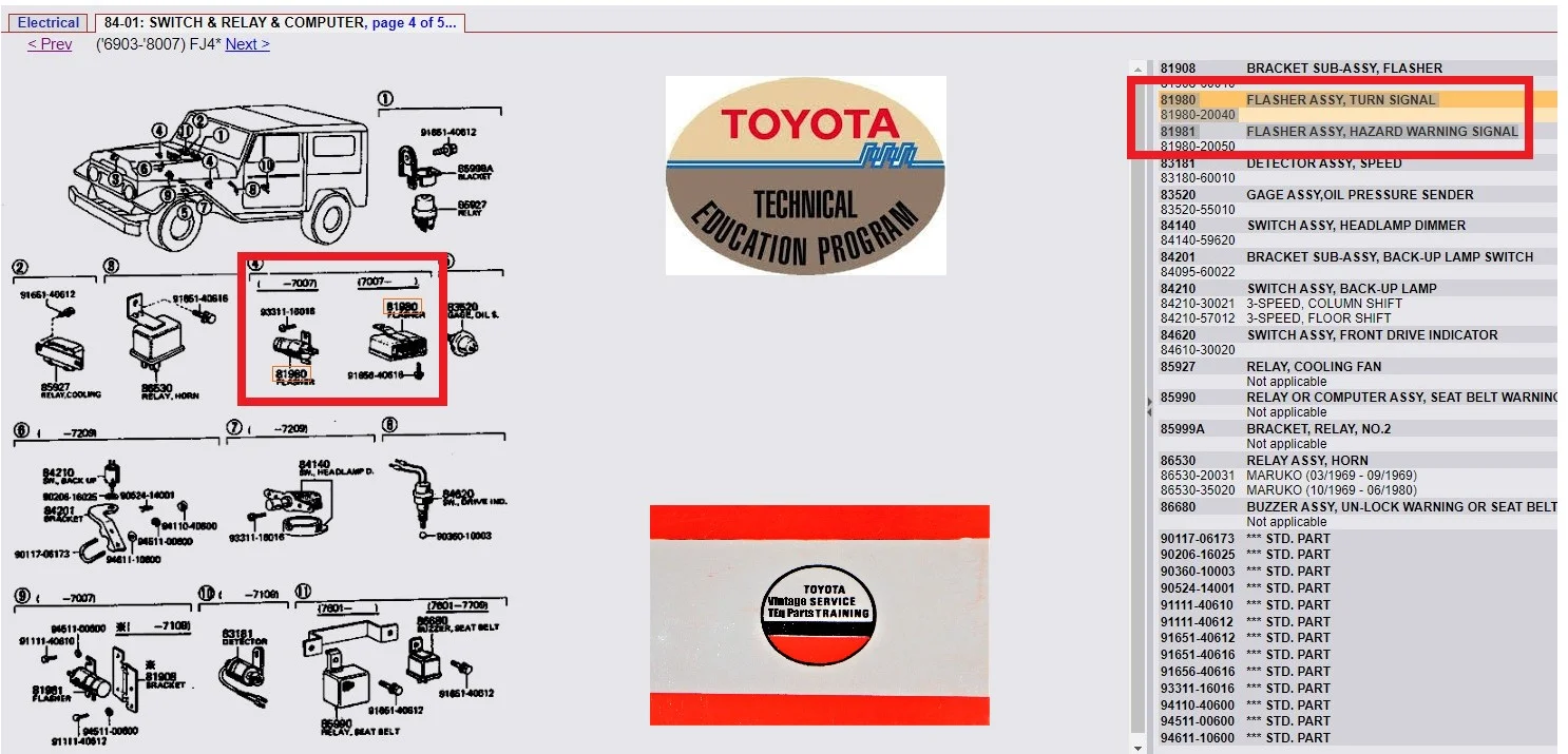

Do you have 2 separate OEM flashers ?
Should there only be 1 ?
The HAZARD switch circuit switch were optional From day 1
In 1962
You have the round can or square box ?
In 1962

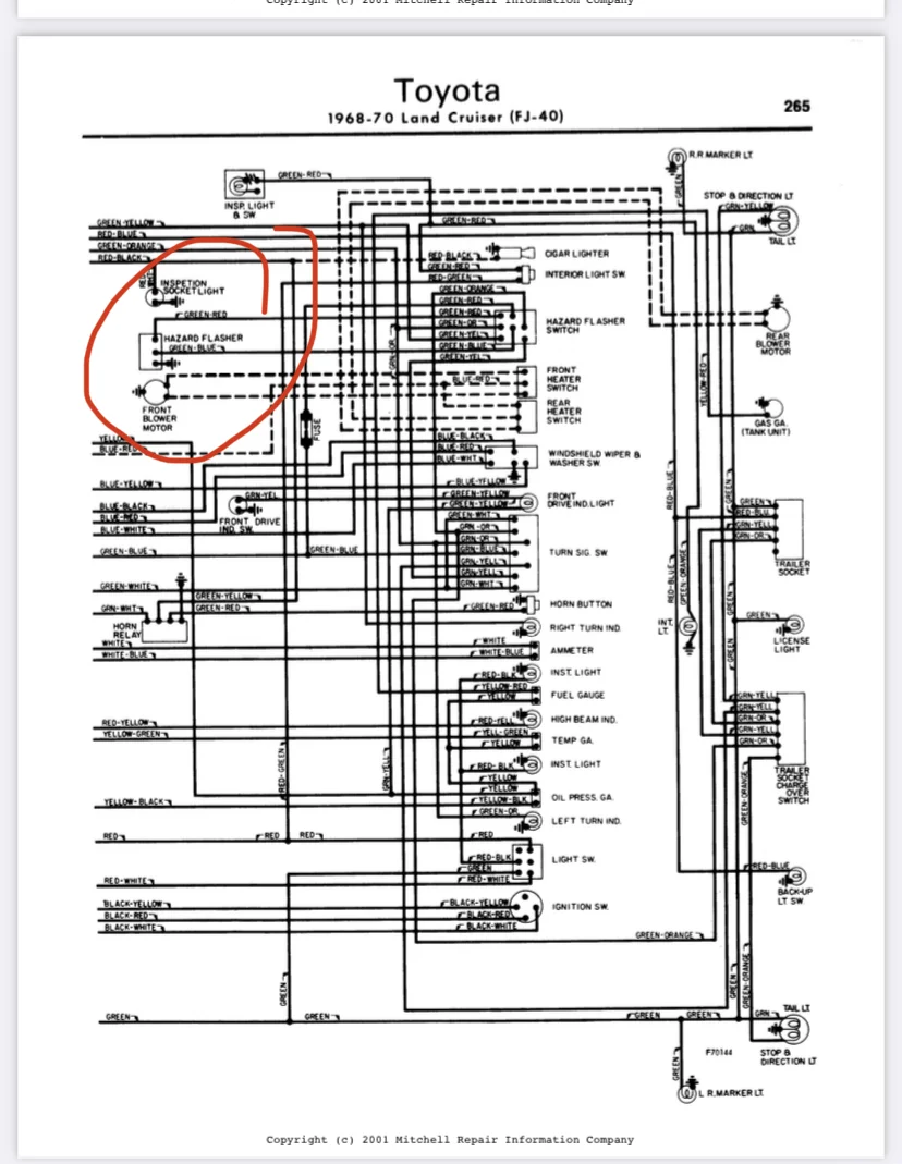

I assume I have two, since that’s what coolerman’s diagram shows. Otherwise I have the cylindrical one.

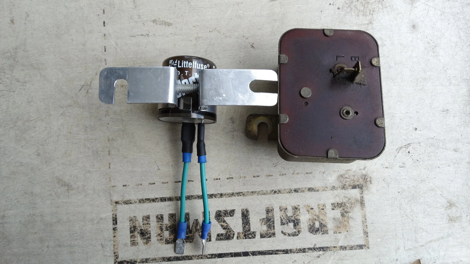

i only see 1 ?
where are you seeing a 2nd flasher ?

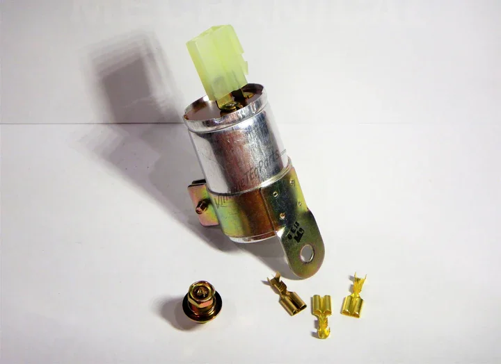

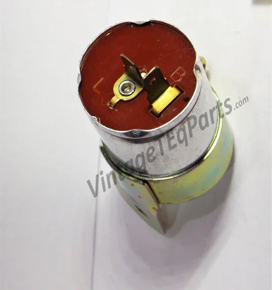

the square BOX that says hazard flasher in this Diagram is technically a ROUND CAN ...
like u have above ,
like these below ,
- you have a 23W standard
this is a ARCTIC SPEC. Heavy DUTY 27w watt commercial / military one below
works much better if you tow a trailer too ..... :)
- u can either use the included single TAB , or swap to your double tabs mount bracket , flasher cans same size round etc ......fyi
i simply adore the timeless older polished aluminum oem flasher cans ...........:D
i only see 1 ?

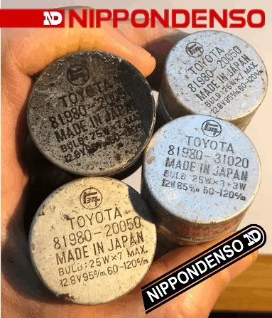

like u have above ,

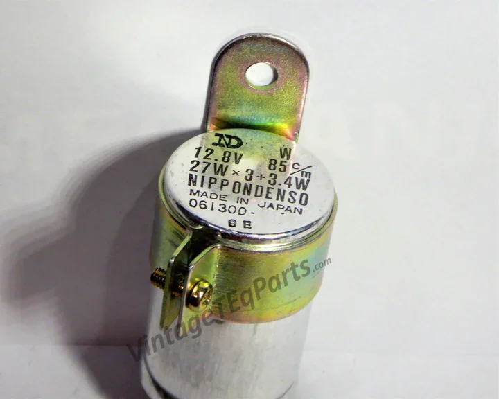

like these below ,

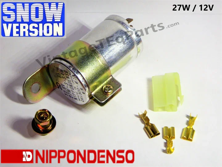

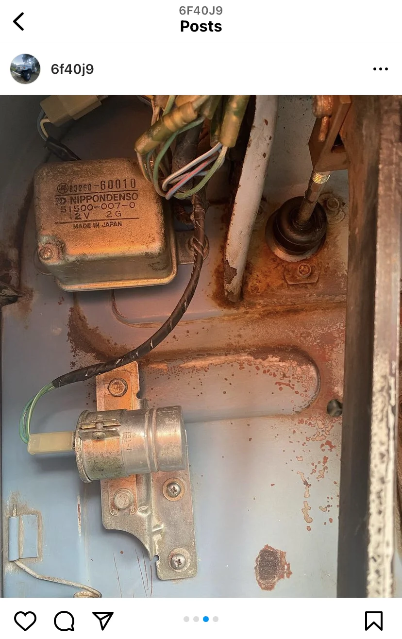

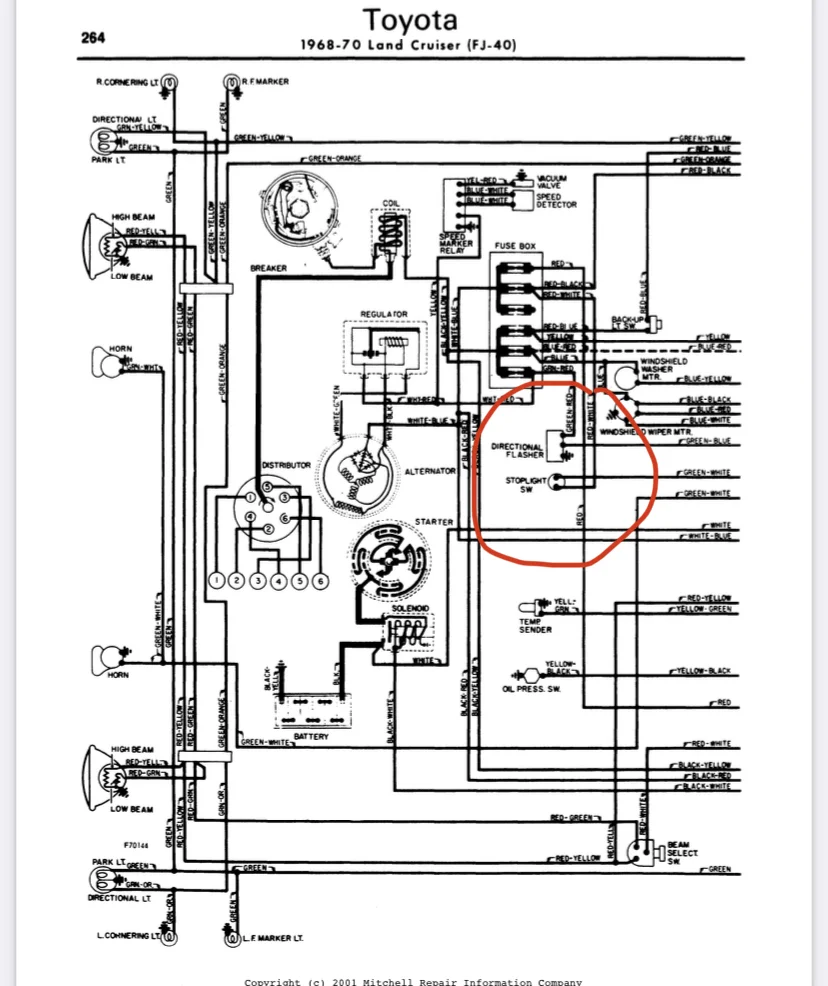

Thought I was going nuts for a minute. It’s on a different page.
If in fact there is only one, that’s great.
i see both are ONLY 2 wire flashers ....
i have NOT ever seen a add on 2nd one before ?
note the wire colors , BOTH are Green w/ RED tracer , and Green w/ Blue tracer .............
- this is ALL i know on this topic here ,
- perhaps a EXPERT like @3_puppies , can add to this topic ?
- see some NON-USA markets DID NOT have turn signals , so maybe this plays out here ?
- i DO have a ADD ON early HAZARD switch KIT wire sub harness section , but have no knowlege if a 2nd flasher was involved ......
- i DID find this , but ONLY confuses me more ?
For what it’s worth I have confirmed that this newer OEM replacement works for both my signal and hazard flasher. Mine is a 4/69, not sure if different than your 2/69
sure , that is a OEM dealer solution that WILL work in BOTH cases ,,,
but ,
the silver can sparkles much better ... :cool:
I’ve been using Coolerman’s flasher kit for several years w good results. I’d use his over OEM.
Then go to his flasher/relay page. Works w/ LEDs. YRMV…
