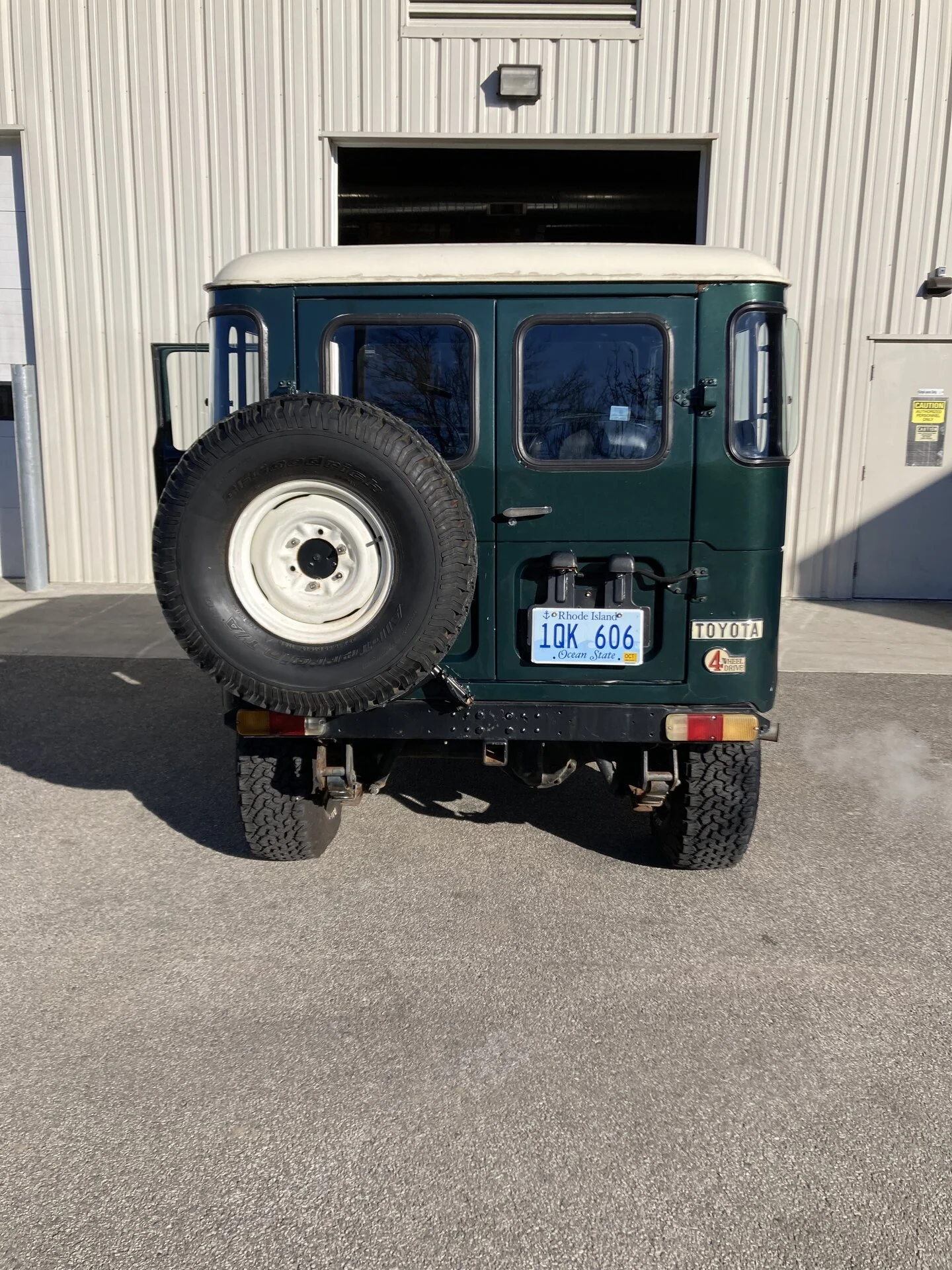

On the rear side panel there is the base ball of a whip antennae left over. May have to put a sticker or something over the holes for now. The fuse panel is right behind the holes.

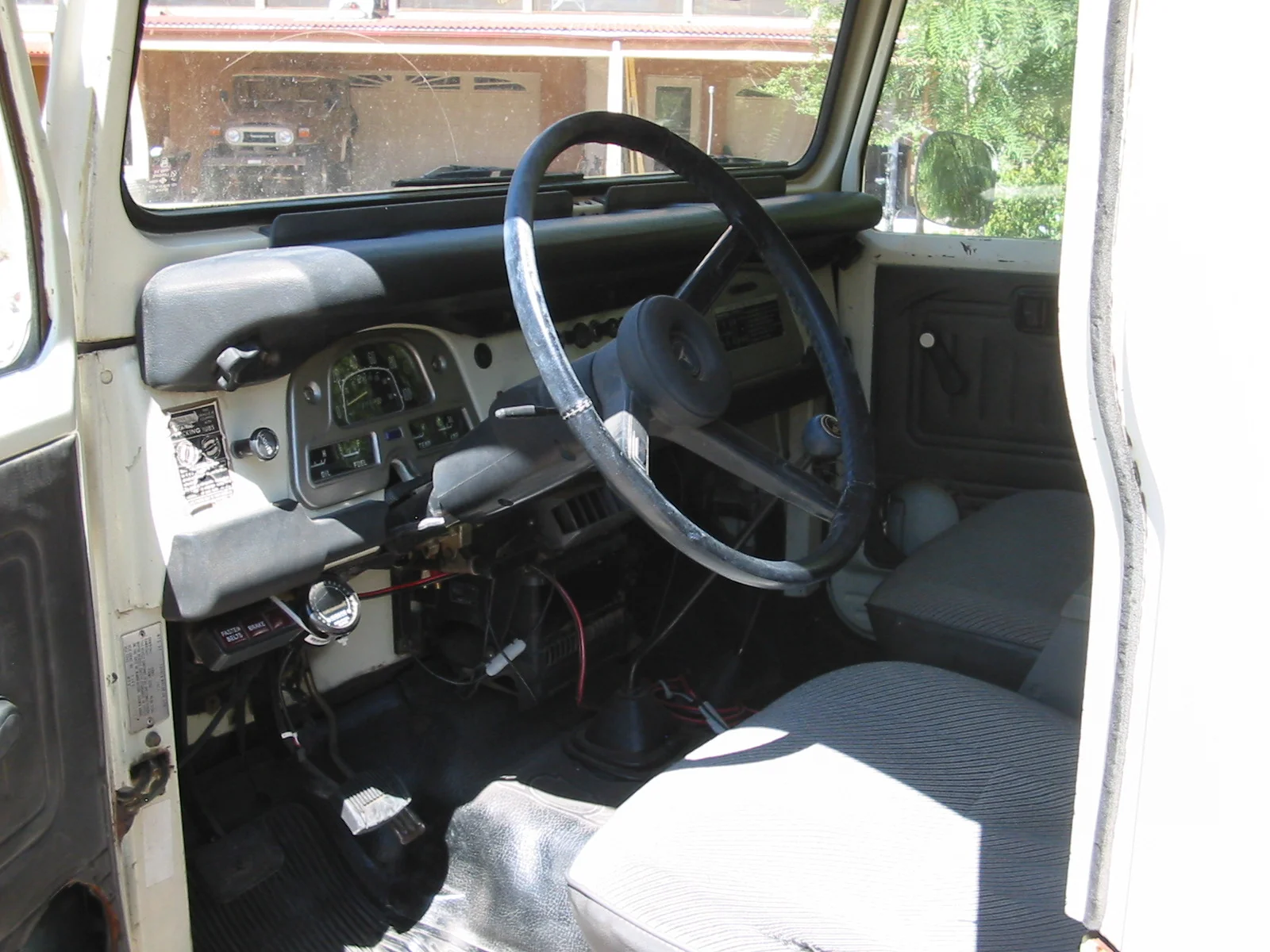

Whoa, Dude - where'd your headlight switch get moved to? There's a tach commandeering that dash spot! :hmm:
Edited to show where your headlight switch should be. By the way, should you find any comments, advice or wise cracks useful (or funny), click the like button in the lower right corner of our posts. Some of us enjoy getting Likes - I know I do!
Remove the gauge cluster in your ash tray so you can get to the relocated "LIGHTS" switch. Are there any wires connected to the switch? I don't see how the stock harness can reach over there; so my guess is they ran jumper wires from the stock harness, or there is nothing there. Why your lights don't work. Look under the dash in the vicinity of the tach, there you should locate the original Headlight harness that should be plugged into the switch. If the harness is there you can plug your "LIGHTS" switch in and you should have lights again. If you want to keep your tach there, you may have enough room to drill a new hole and mount near tach. Or you could lose the tach, weld that hugh hole shut, and drill in the stock spot to mount the switch.
