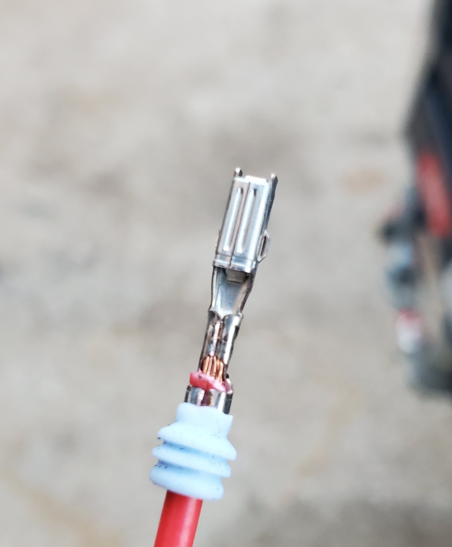

@ToyotaMatt sensors come with all new plugs and related hardware, Luckily I had a JST crimper on hand so I could make some Klean kirmps. Its REALLY IMPORTANT you put the rubber seals on before you crimp when applicable. Some of the plugs had larger inserts than my JST crimps were made for but I still made it work.
I found this out the long way, If your new inserts dont easily slide into the plug housing then make sure this yellow cylinder is pulled out, Its a locking mechanism of the sorts.
