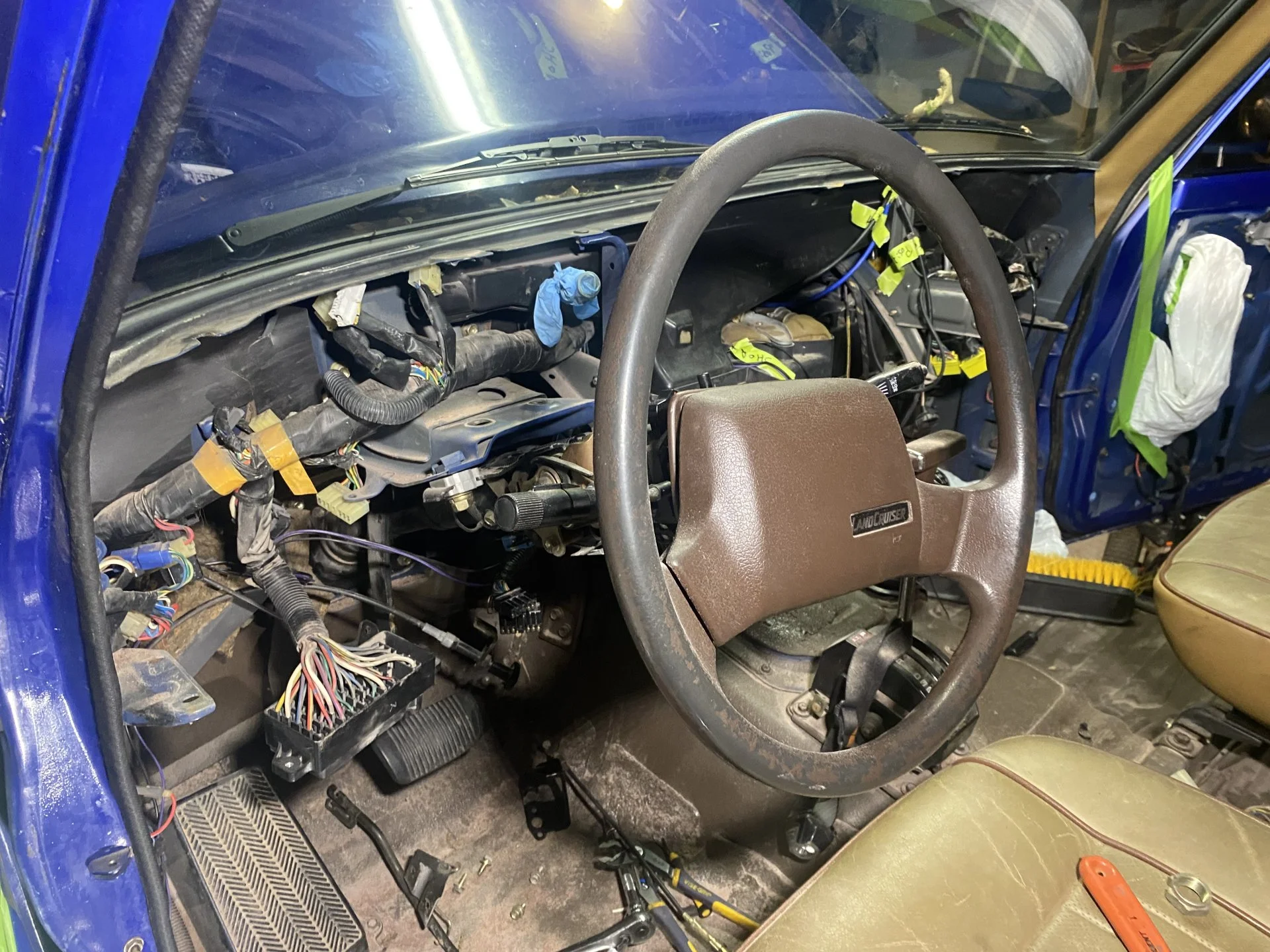

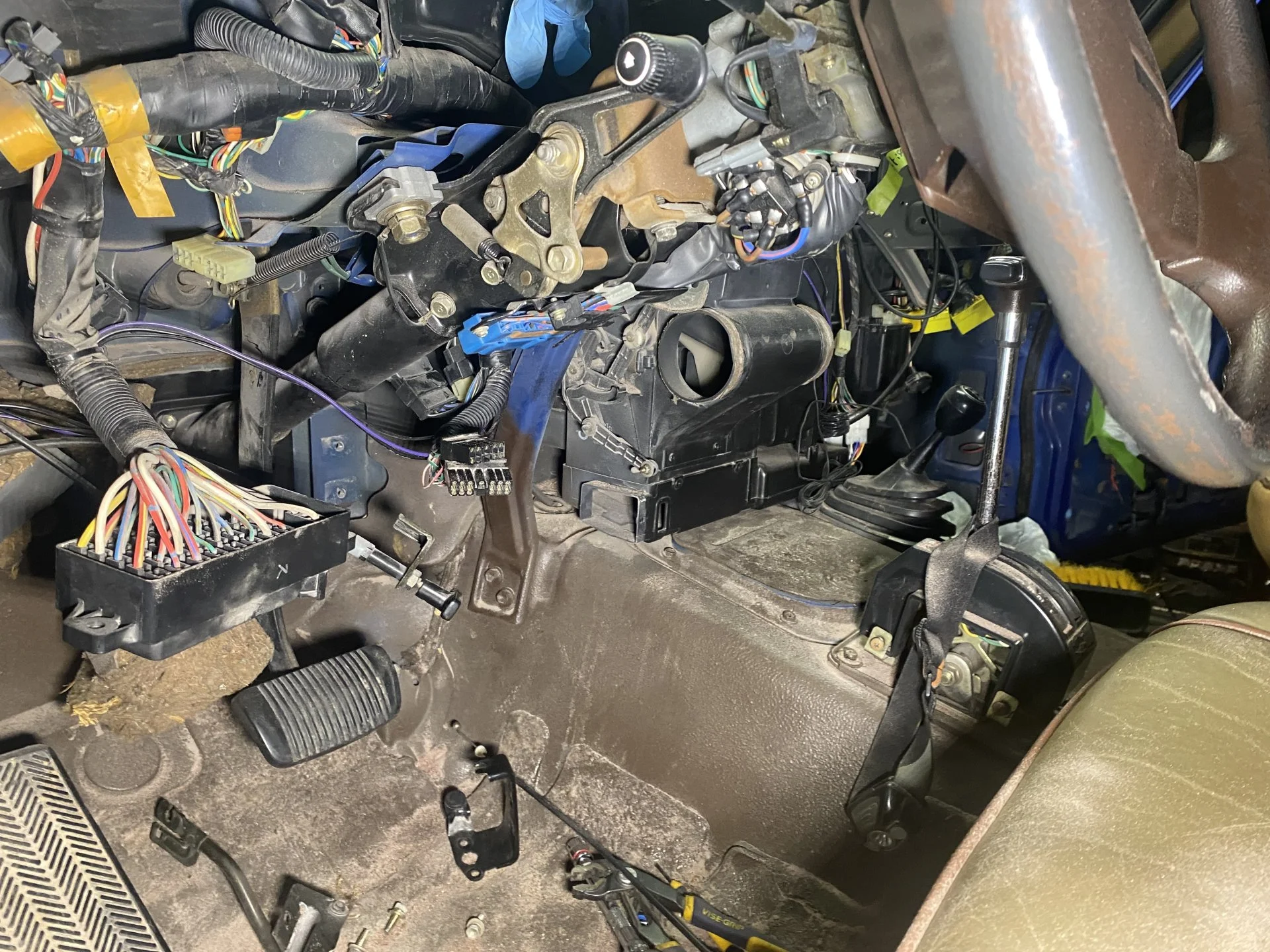

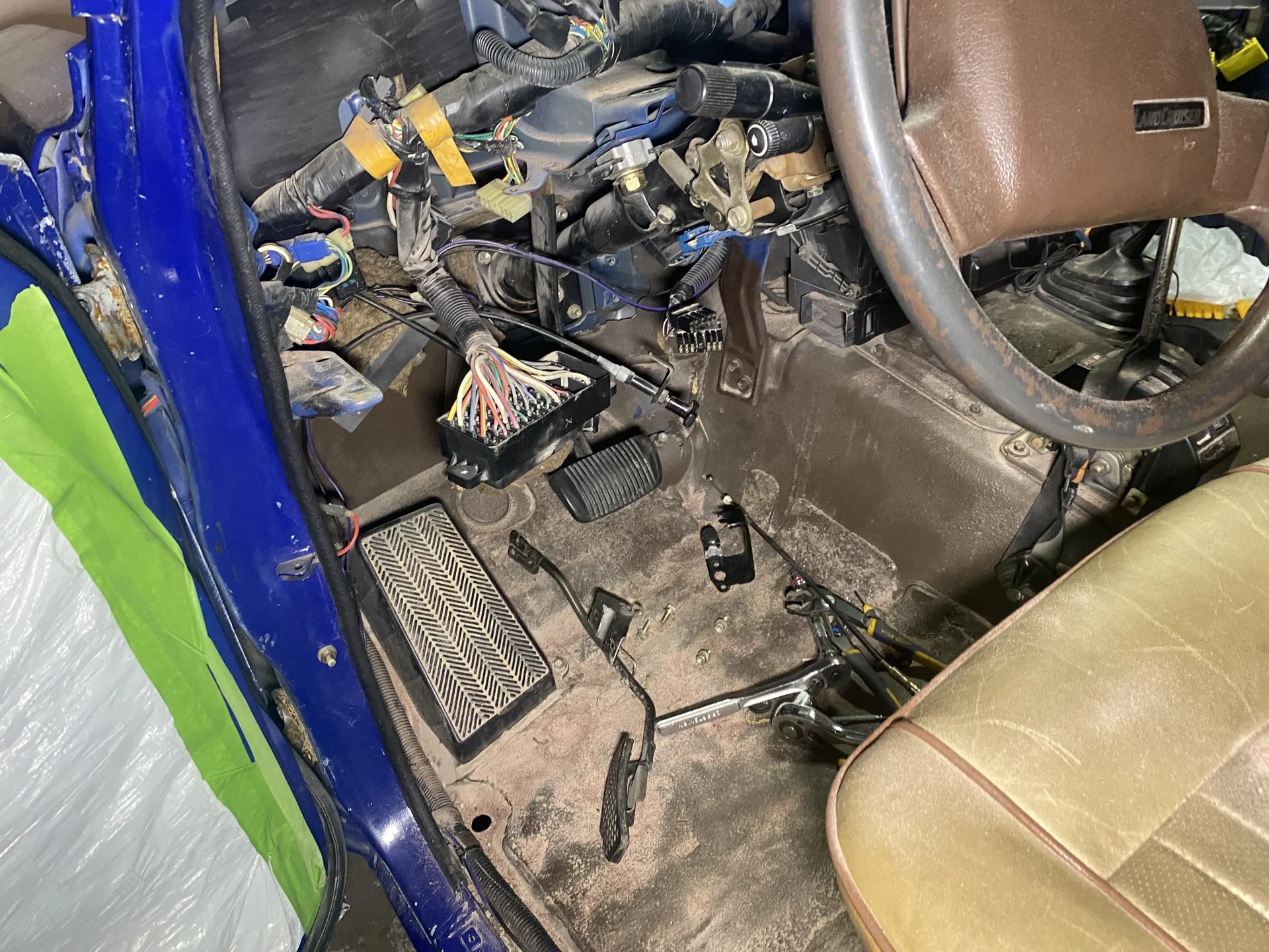

Hey LC FAM! My 88 FJ62 restoration is coming along nicely. After a bumper to bumper mechanical rehab, I have moved on to returning the interior to its original glory. I have completely stripped the interior out at this point with the exception of the ventilation system. I have collected ALL of the missing OEM interior parts which was a long list. I'm now in the process of refurbishing all of the interior parts to OEM condition. I have a few questions only the IH8 crew will know best.
For reference my 88 is Blue with the brown interior. Or so I thought. After taking the interior apart, I found that the rig originally came with the grey interior. One of the previous owners, went to a lot of trouble to change it over to brown. They did a pretty good job but missed a few details. I really like the brown interior, so I'm going to stick and take the color change all the way.
My questions are these.
1) Does anyone know if the dark brown color has a paint code, if so, what? This would be the color of most of the interior trim components, and the steel dash frame. I can try to match it and can probably get extremely close, but a paint code would be much easier because there are at least three sheens to the interior. 1) gloss for the the hard plastic bits like lock and window switches, Semi gloss for the others parts like the dash frame, and a matte for the some larger molded plastic parts like the kick plates, and steering wheel. **** the matte is probably a satin actually.
2) Like a lot of 60 and 62's, I have a plastic cap covering the original dash pad. The original dash pad was foam covered in vinyl. I'm not unhappy with the aftermarket cap, it makes the dash look great. My problem is that the foam that used to be trapped between the pressed steel frame and vinyl+ plastic cap top layer is breaking down and turning to a strange reddish brown dust. The dust is NOT trapped, and has covered the interior of every dash components, and will regularly make its way down to the floor boards and into the ventilation system. This is the reason I took the dash apart in the first place, to clean all this crap out. Putting the dashboard back in without a remedy will only yield the same result I fear. Any suggestions? Eliminating the original foam layer is the right way to go, but I'd have to tear the three layer dash board apart, strip the foam out, and then have to find a way to reassemble it without making it look like hell. I suppose upholstery shops may see this from time to time and have a solution? Any suggestions??? I attached a few picture of the very evil foam dust.
3) Lastly, with the dash disassembled, a buddy with an FJ60 suggested I rehab the heater core despite the fact I have not had problems with it. Great suggestion, as I don't want to take the dash apart ever again. Along this line of thinking, any other similar suggestions? Components to inspect, rehab, alter while the dash is out?

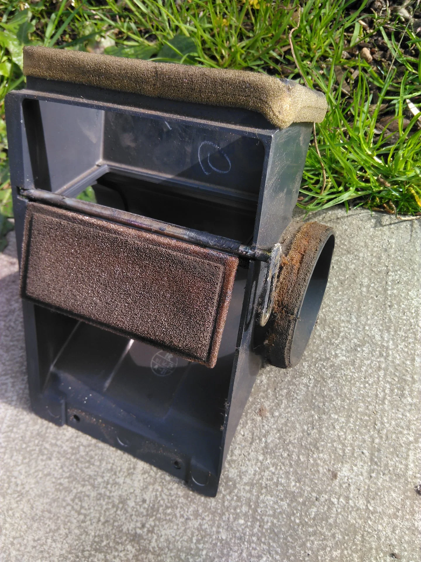

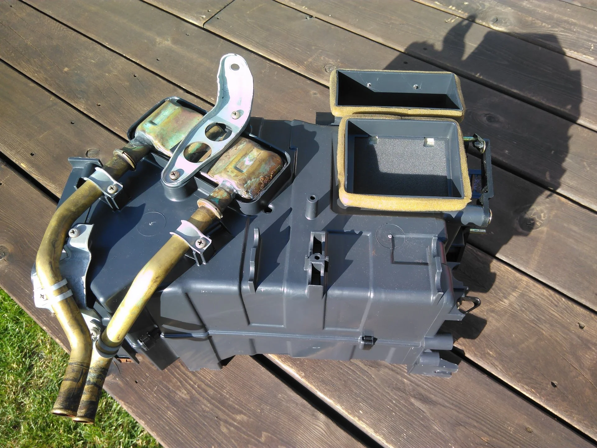

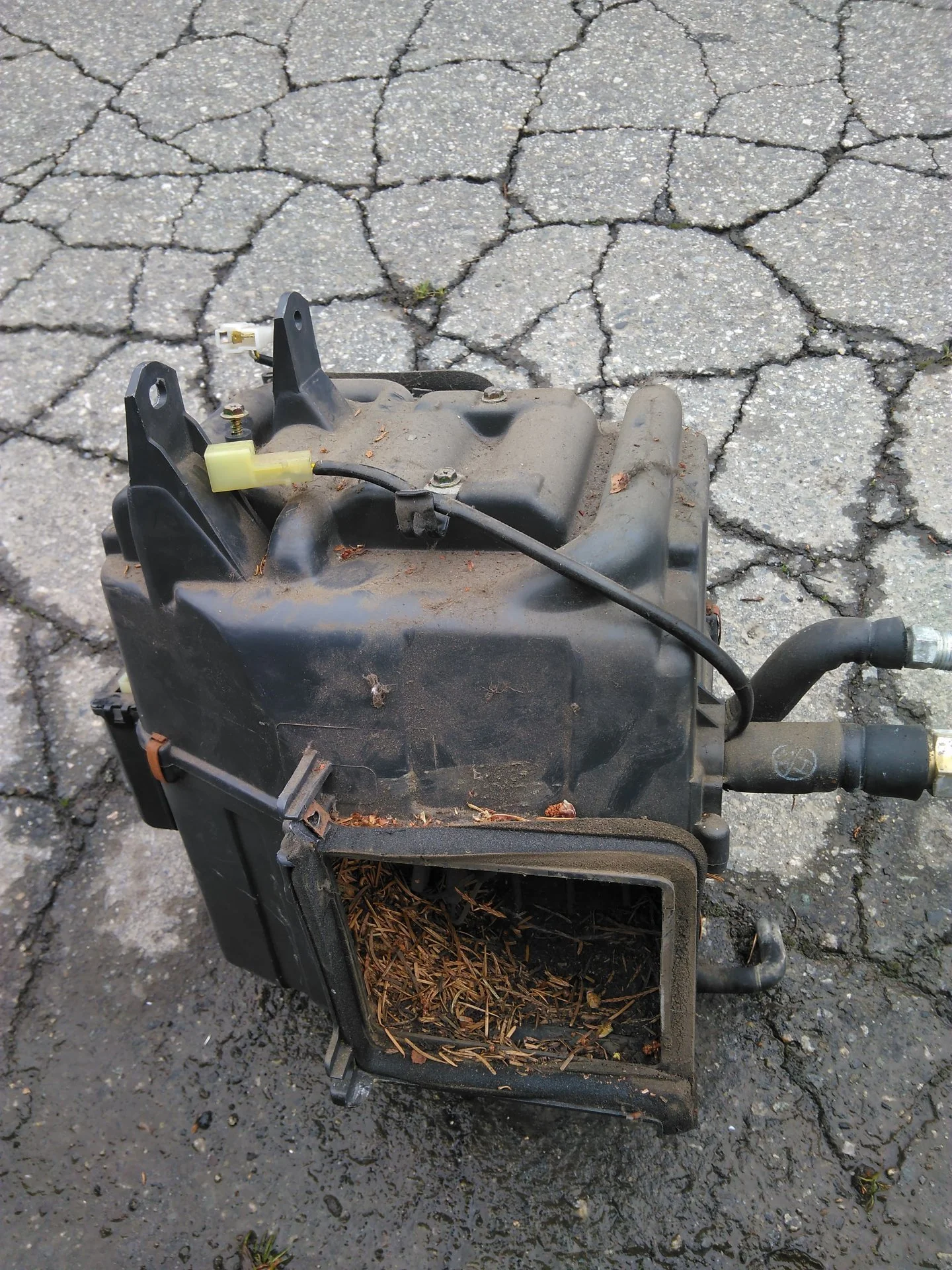

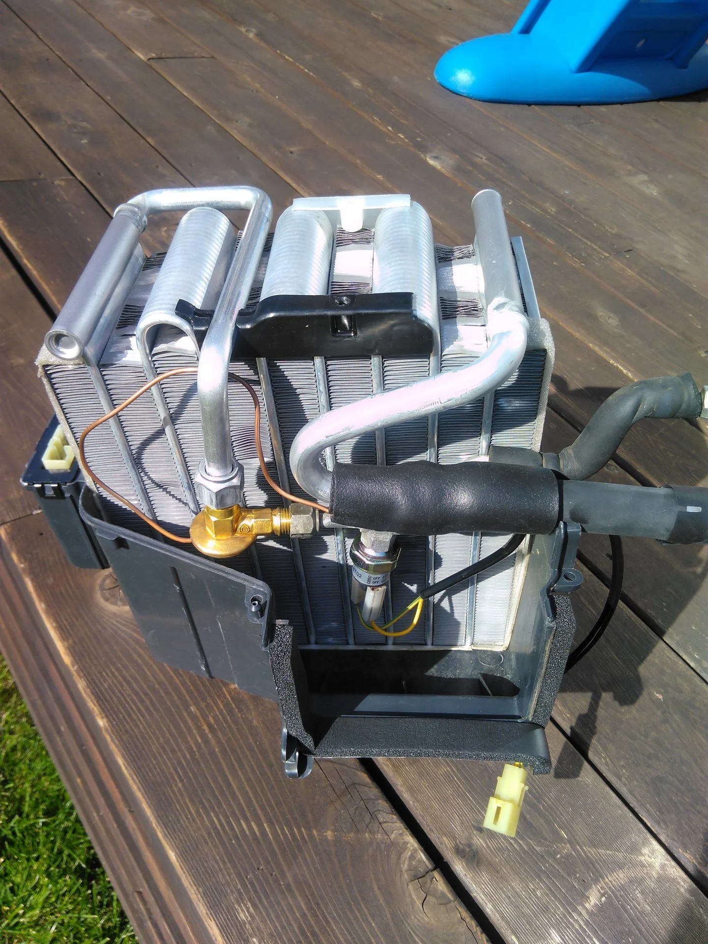

I would completely remove all the HVAC components/boxes, and clean and re-foam everything. I did mine, and it was time consuming and a bit tedious to re-apply all the foam to the different flaps, but it sure beats all the crumbling foam that was there.
You can also replace your AC evaporator and pressure switch too. Easy, to access now and relatively inexpensive.
Lastly, I would remove the wiring harness ground straps at each A pillar and make sure the contact surfaces are all clean and re-install.
Some would say sound insulation too, but the factory sound pad seems pretty good to me.

Any insights on the foam? What product did you buy/installation etc.
There is a good thread here detailing some of the work involved. I bought the foam on eBay, but can't find it now. I'll keep looking. To glue the foam, I used a spray adhesive after cleaning all the old foam off. Some of the flaps only have foam on portions of them so you may need to mark the flap before removing all the old stuff.
Here are a few pictures of when I did mine.

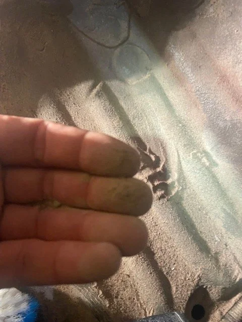

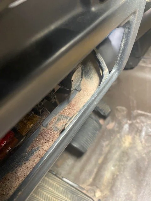

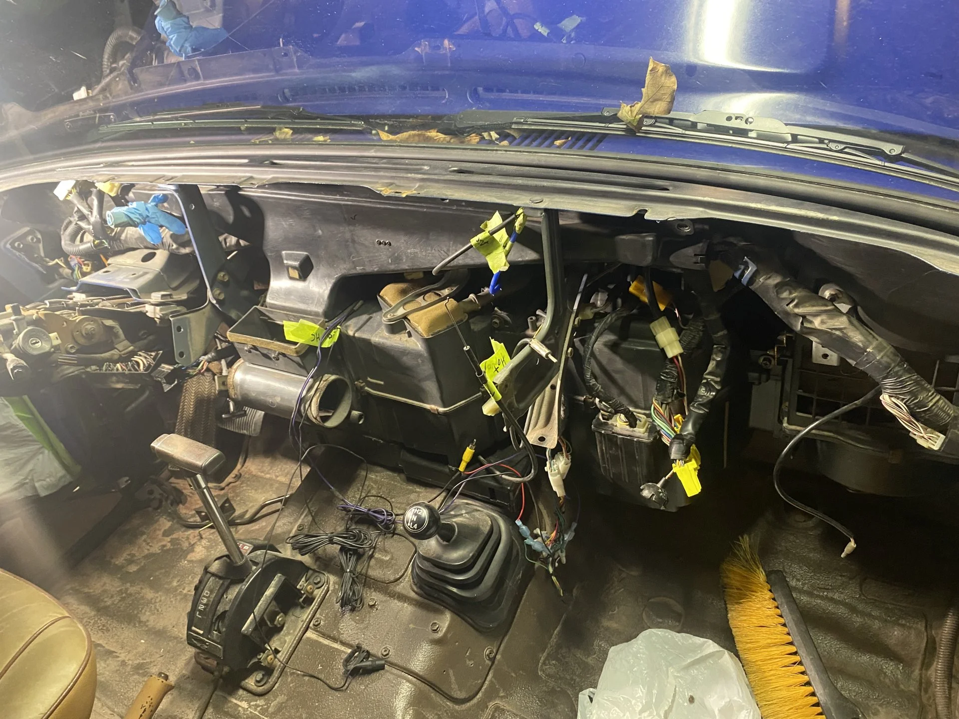

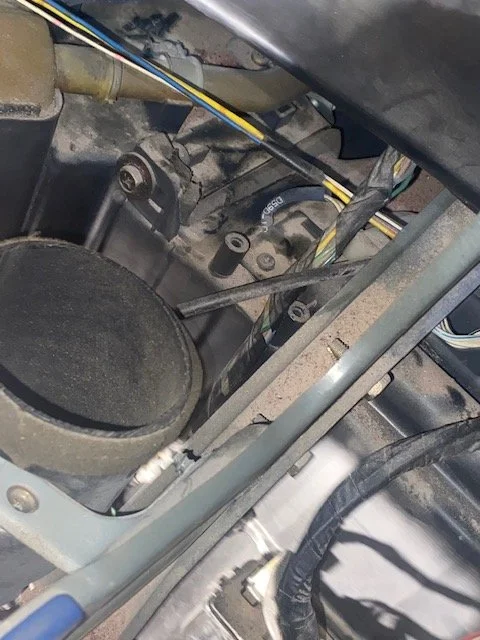

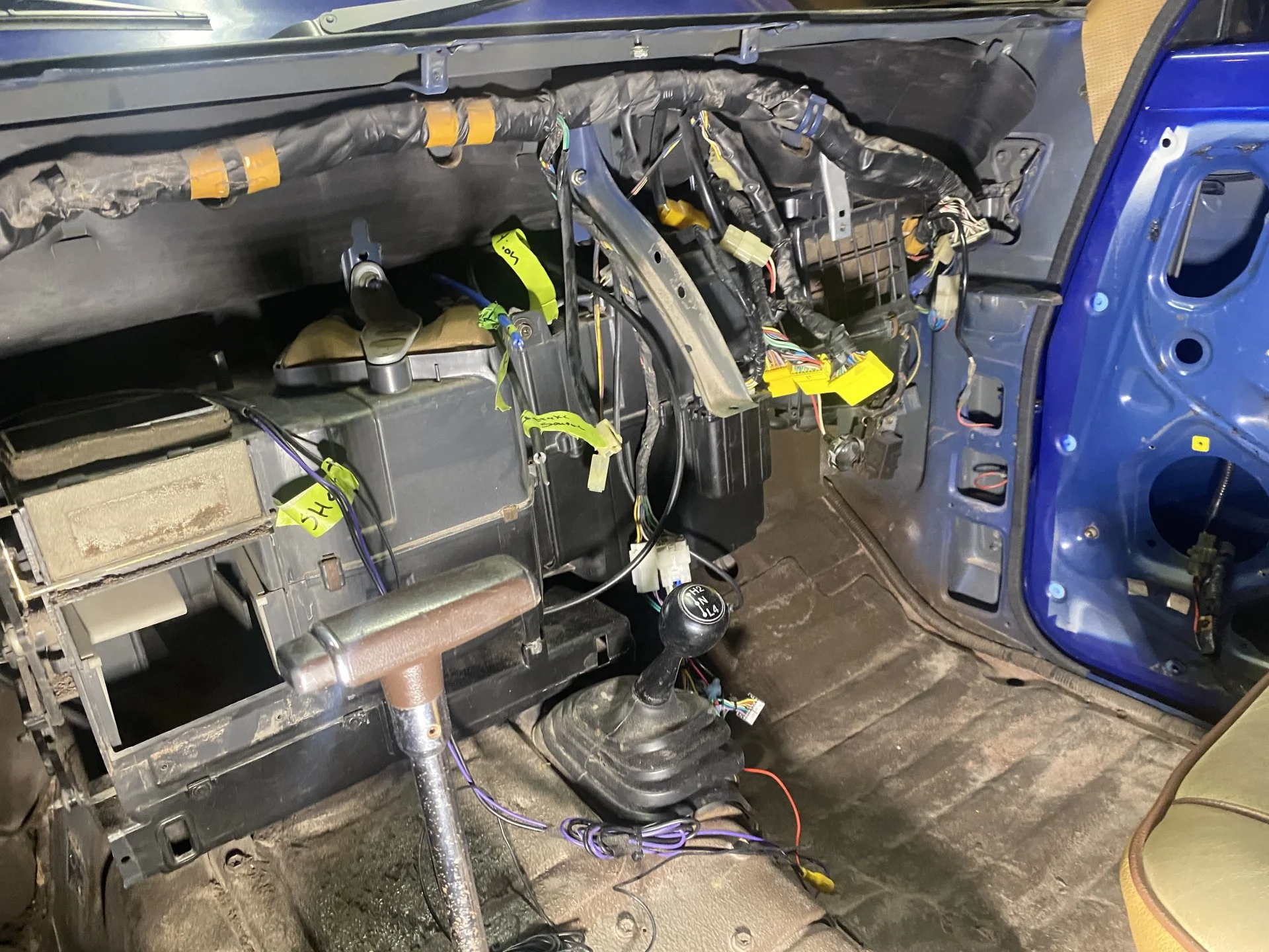

Tackling the teardown of the ventilation system this weekend. It’s turned out to be a big job with all that has to come out to gain access to the primary ventilation system components. Very glad I’m doing this. The more I take apart, the more foam dust I find. It seems the primary source of this foam dust my not be the dash pad, it may be the foam parts inside the system…likely a combination of both. I attached a few pictures of the teardown
Now that I have a lot more access to the OEM firewall heat/sound pad, It’s looking like a replacement is in order. The insulation layer is falling apart. Anyone know a source for these Firewall pads?
