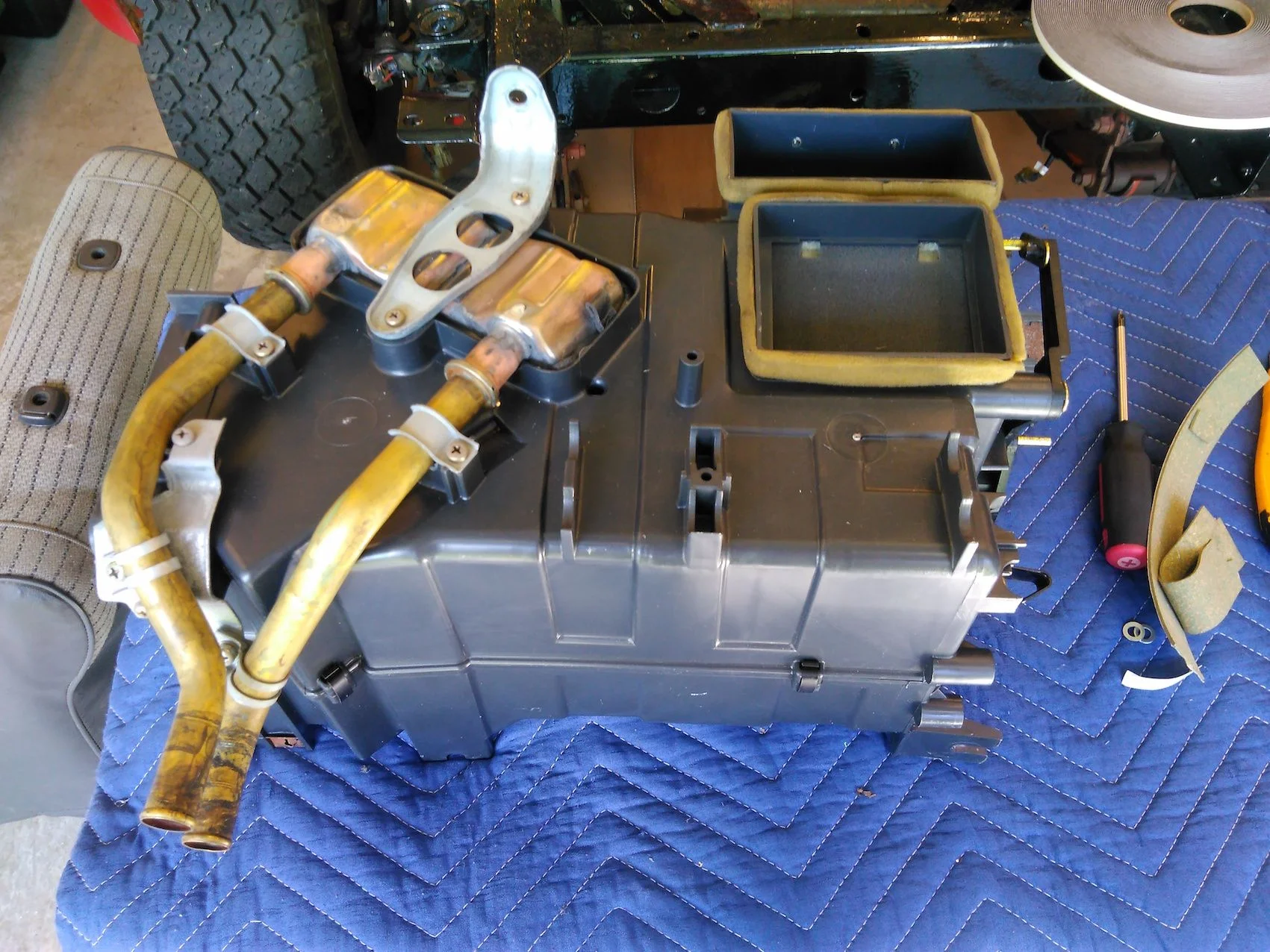

It would be fairly simple to remove the fan motor housing once the AC box is out. There are 2 flaps in the fan motor housing, and as I recall 4 in the heater core box. None in the AC box. I think it would be difficult to access the flaps unless the boxes were out of the truck. Really the heart of things are the in heater box.
Here are a few pics from when I did mine recently.
Here is the foam I purchased for the flaps.

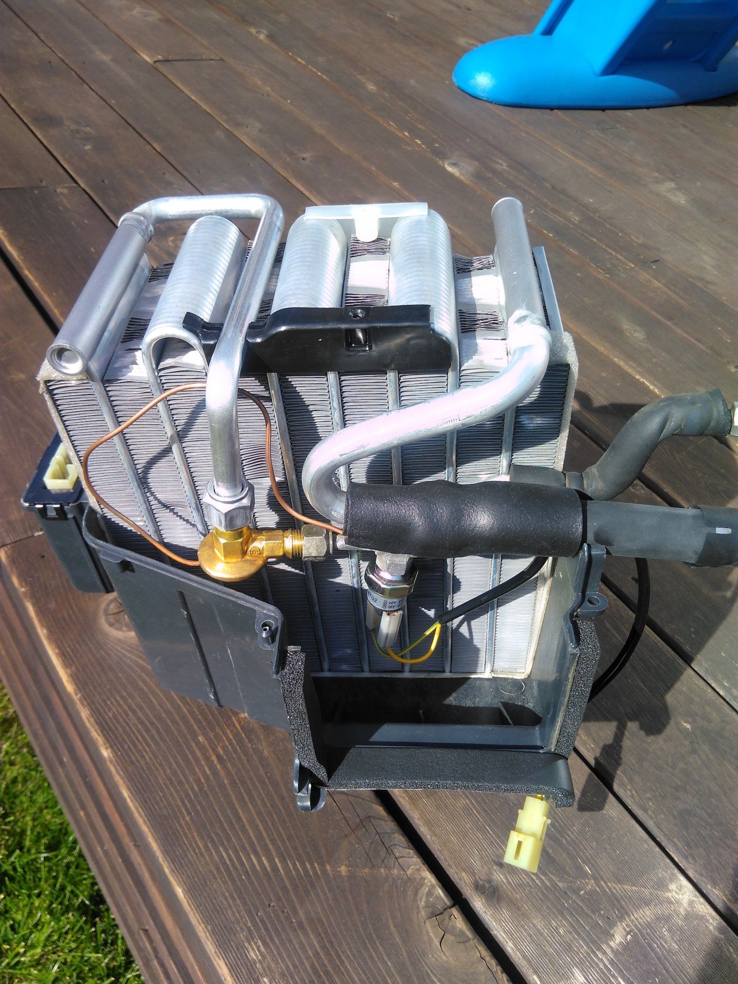

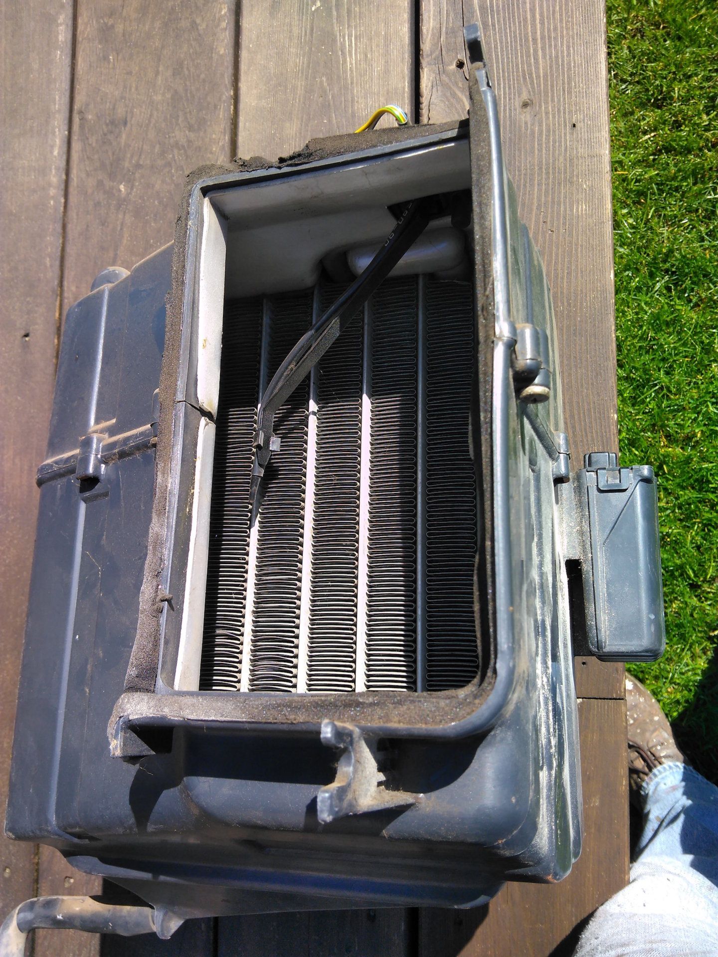

Just extracted my evaporator from the dash. Fairly easy, although the biggest hang up was the damn little pass. side floor heater vent. The inside of my heater core looks pristine, except the foam on the flapper is pretty shot as expected but it functions well and still seems to seal ok.
The evap, notsomuch...ugh!
If it's anything like mine, the foam looks good but crumbles when you touch it. But as long as it seals ok that's good. You don't really want to open the can of worms that is the heater core box. With the heater core NLA, if it ain't broke...

Hey! Yeah with the evap box removed the only flapper you could kinda sorta access is the flapper that diverts air to the heater core, and bypasses it. This is a very important flap of course. You may be able to clean it off and put new foam around the edges where it seals. If your foam is totally shot in this flapper then you don’t have much to lose, just will be a awkward job. :) The whole flapper is covered in foam which I never fully understood as only the outer edges of the face are the only real part that seal against a surface.

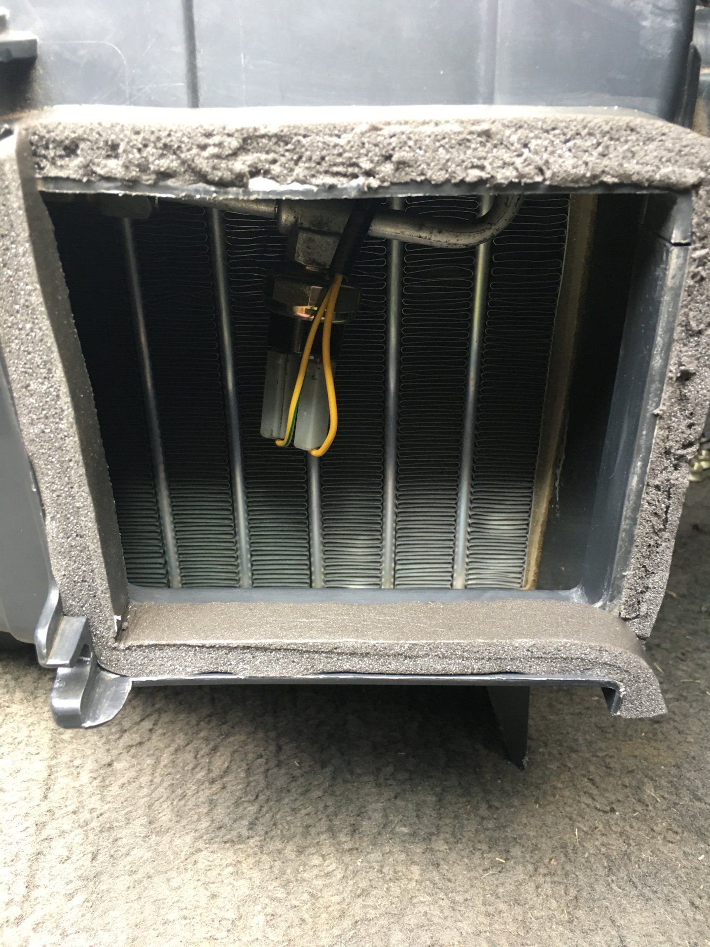

Interesting OEM foam pattern on the cold/hot flapper door. Not sure if it serves to insulate the cold from hot or works mostly as a seal around the edges..(?)..not sure.
As mentioned previously the foam on mine crumbled to the touch. I made no attempt to put any new stuff around the edges, that would have been a painful exercise under the dash and it seems to seal well enough and certainly works well in the cabin.
