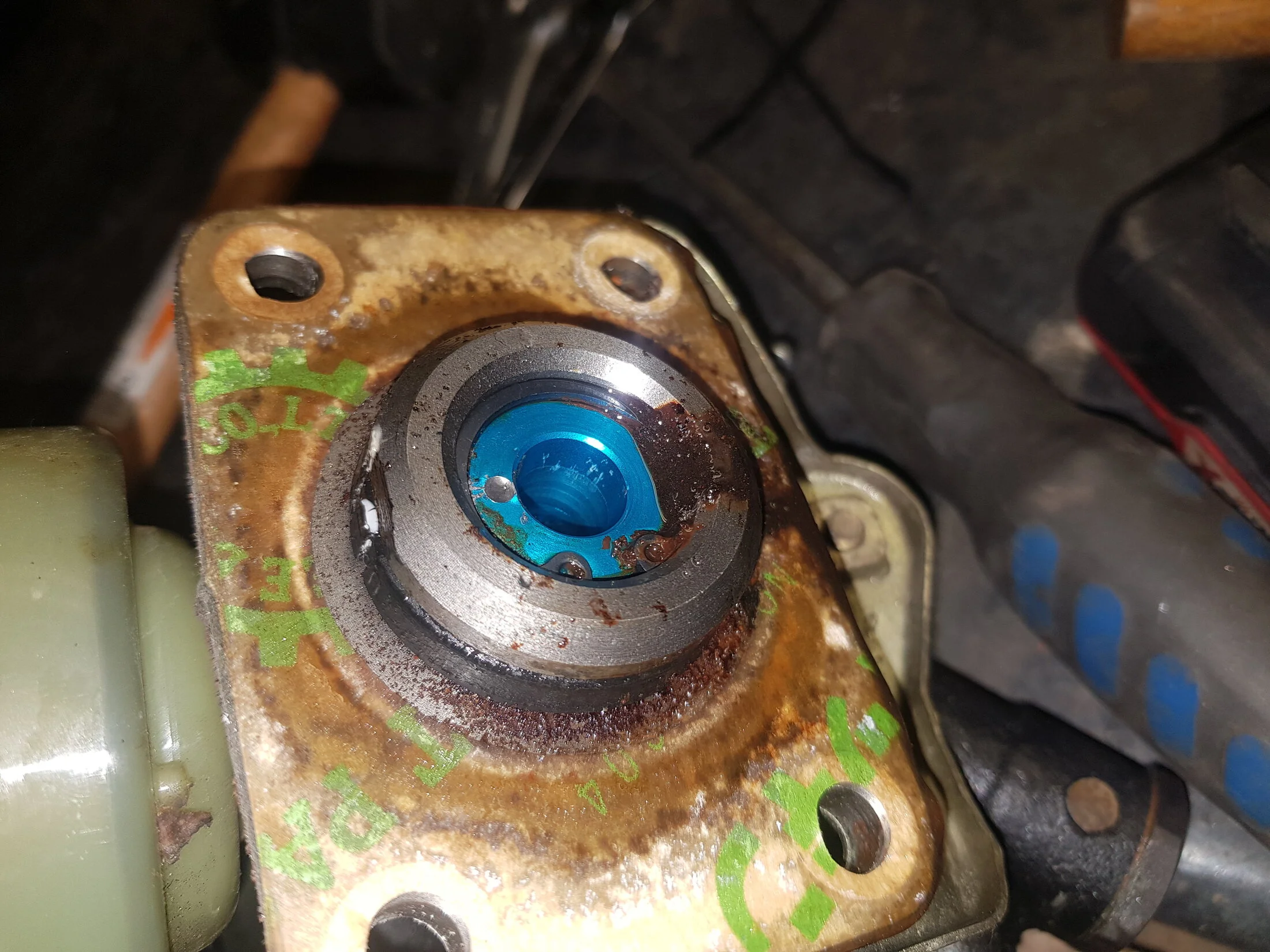

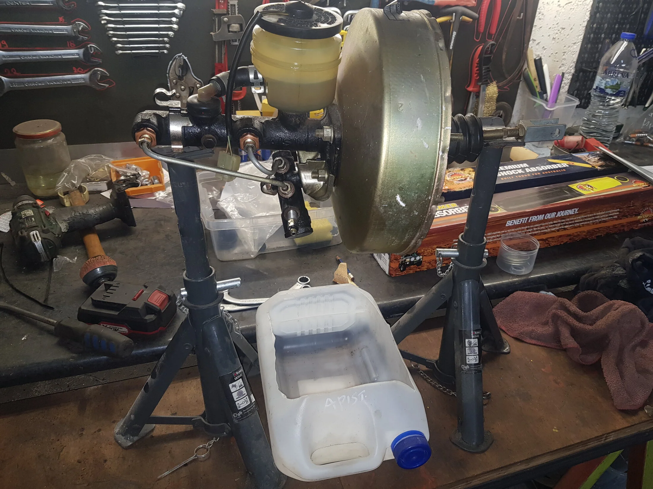

Another problem it is that after brakes front and rear bleeding and tested ..the next day found the refilling cap empty.!!

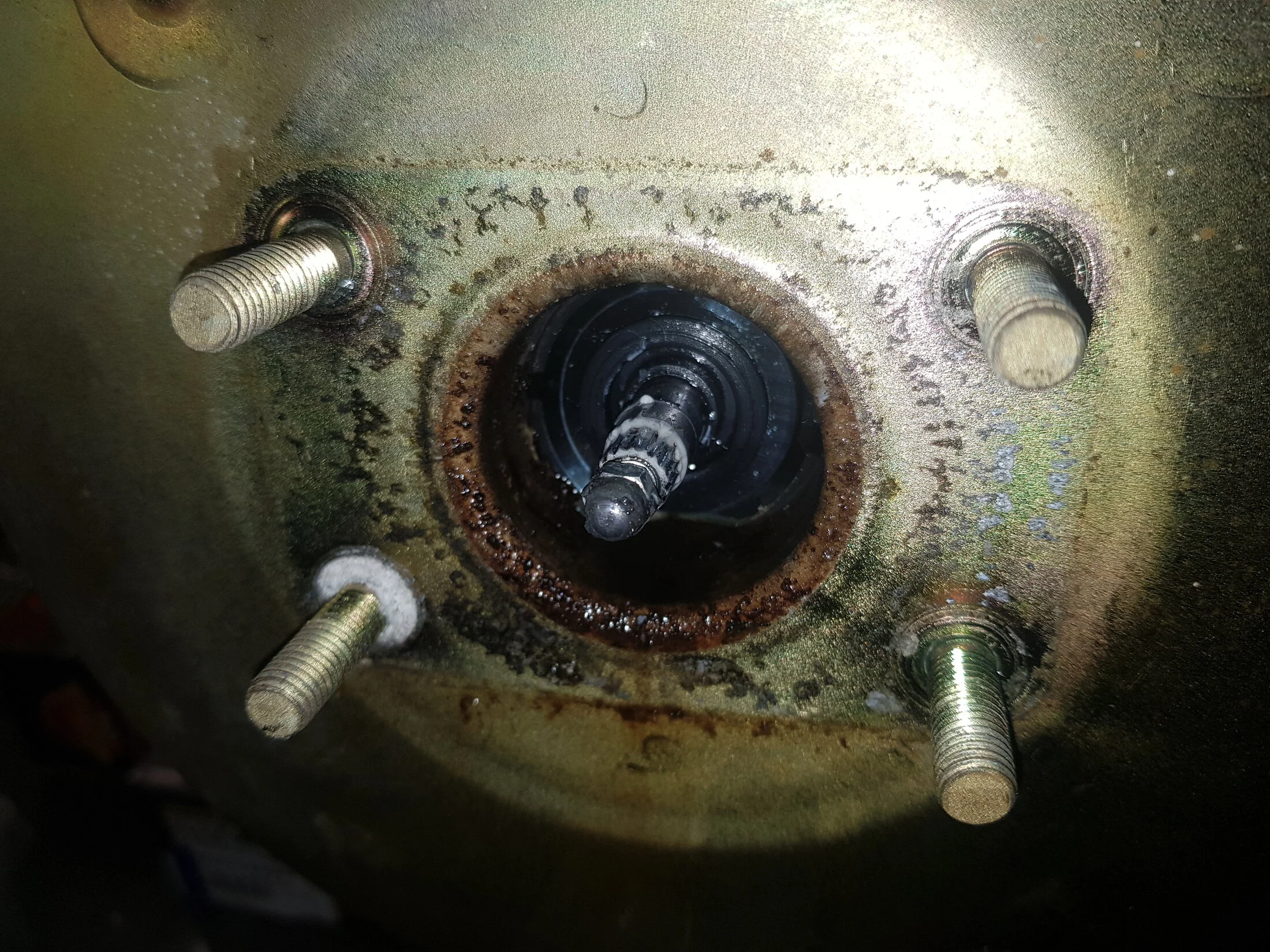

Remover the brake booster and master cylinder and found liquid to the brake booster.
Noticed that a lot of impurities and solid sludges found to the circlip to the side of the master cylinder
