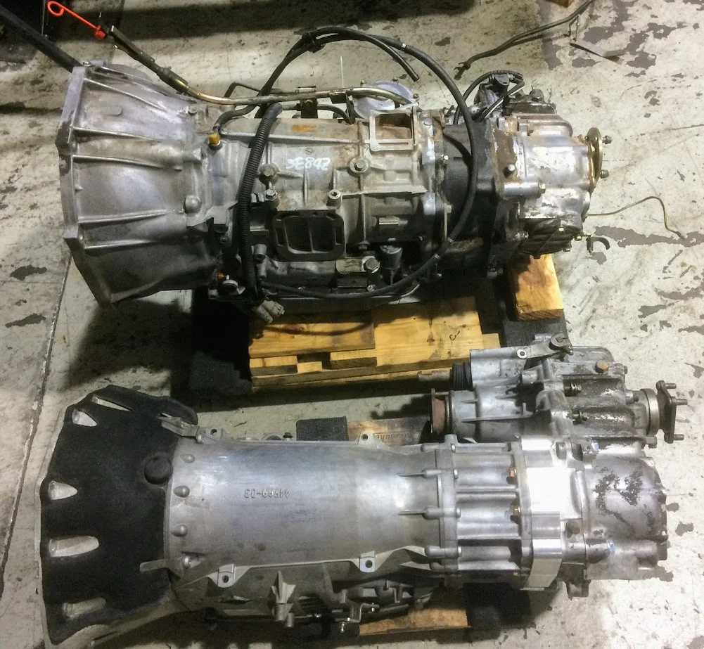

This is what I've done. The one on top is out of a Fj62, the bottom one is a 722.6 Mercedes 5 speed with a Toyota transfer case that bolts up to my Om606.

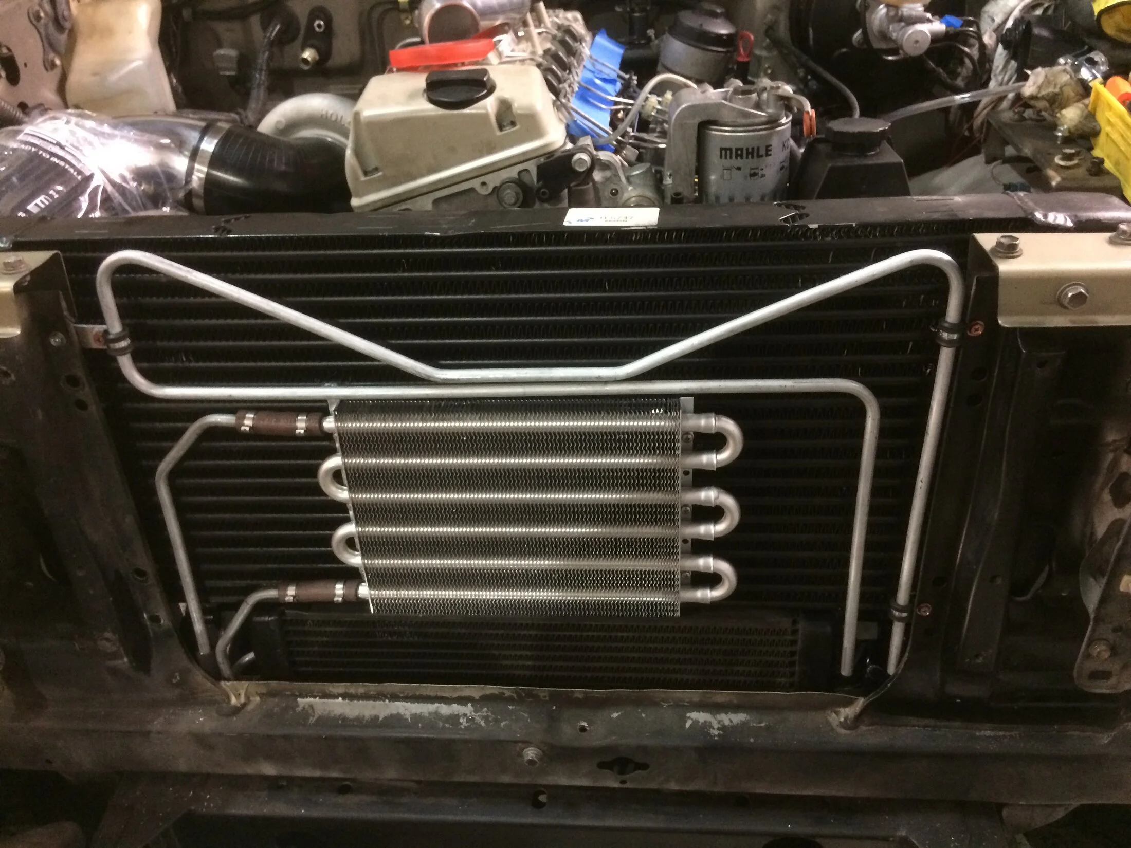

Super cool, if I was not a manual snob that would probably be the way to go. Did you stack the radiatior, intercooler, and oil cooler all in front of each other? That is the one packaging concern I have.
I hear you about the manual transmission, I do have an h55f behind an other Mercedes turbo diesel in my FJ40 and I love it.
