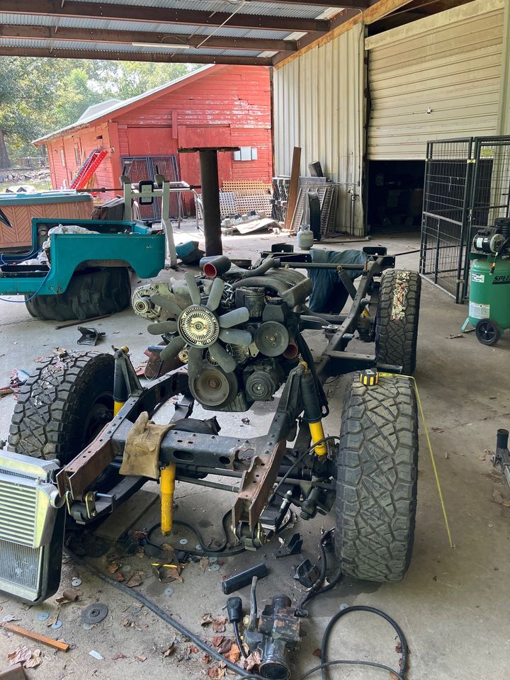

Trying to bring this thread back a little bit. I just got an OM606 and am planning on charging ahead with this swap into my 40. Does the OM606 to Chevy adapter put the correct angle on the transmission relative to the engine?
The engine will be slanted like normal for the 606. As far as transmission clocking, I believe 40s and early 60s had the trans level but 85+ were clocked down a bit more (?). I have not seen these adapters on person but assume they are configured to have the trans level.

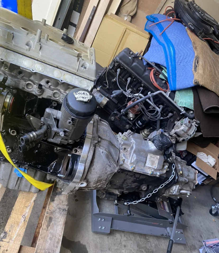

DPUK’s H55F adapter should work with an H41/2 or H55F if you combine it with the bell housing from an 2H series diesel powered 70 series. That’s what I’ll be doing for my swap. My adapter should be here in 2 weeks. I’ll bolt it all together and update here and in my build thread.
That would be amazing. Please keep us updated. I was planning on making my own adapter/flywheel but didn’t really want to if it’s not necessary haha
It fits
Amazing. Are you using the clutch fork, slave, and throw out bearing from the 2H as well? Or are you using your 2F parts?
Yes, you’ll need the bell housing, clutch fork, slave, pins and throwout bearing hub from the 2H for it to work. I got the later style bell from a 70 series which has the correct clocking of the trans to work with my late ‘85 FJ60 crossmember. The kit will include a bearing to suit the new pressure plate.

Separate question; does the flywheel look like it’s the stock automatic flywheel with an aluminum extension bolted to it with the 6 bolts?
Nice! It’s a thick, aluminum, one piece flywheel with steel ring gear and a steel insert for the friction plate. Bolts up to the crank like factory.
