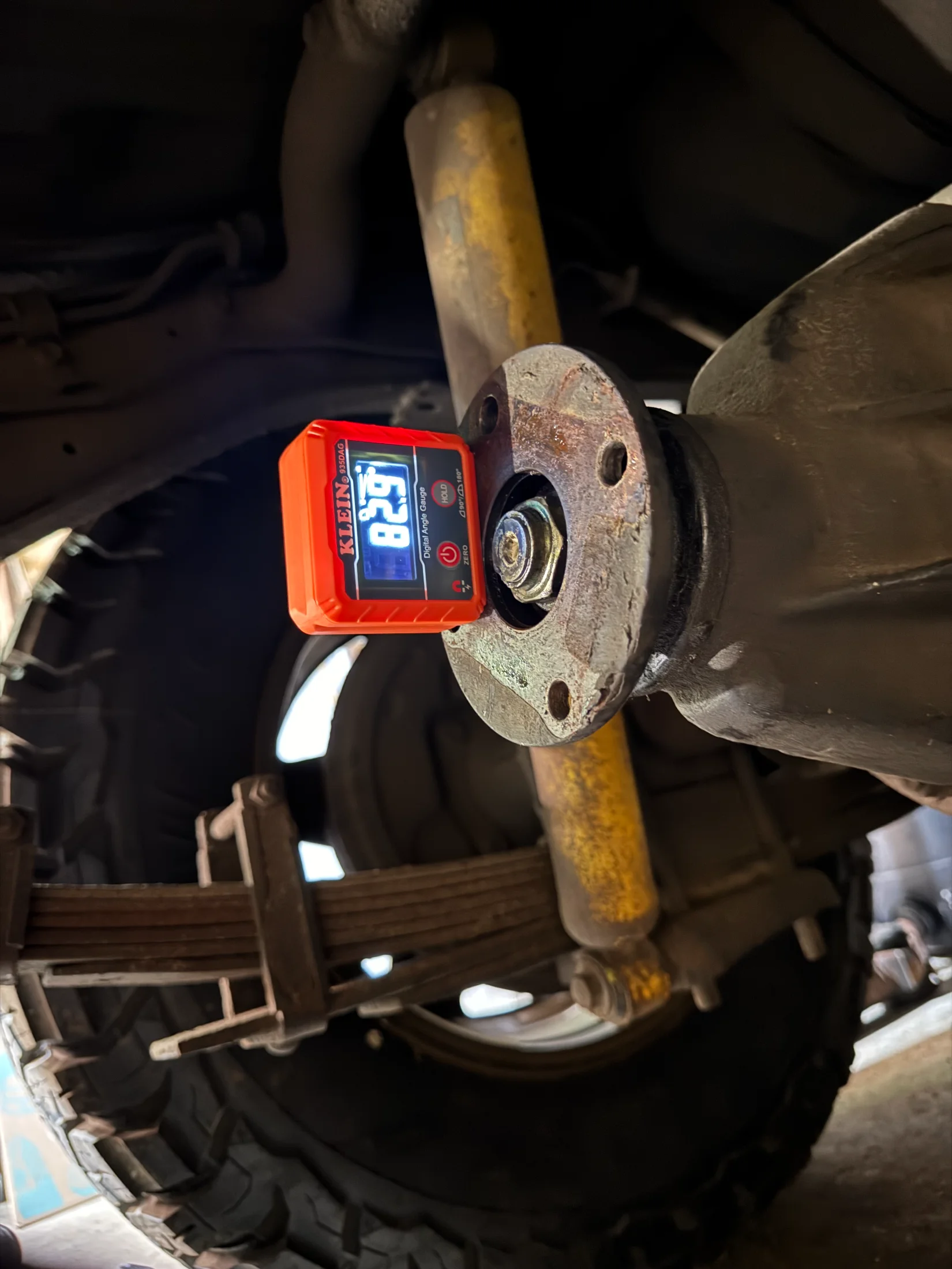

Any thoughts or advice appreciated on this issue.
I finally finished swapping out my A440 for an H55F (behind a 12HT). I’ll try and get around to posting some photos / thoughts on the trans and t-case rebuild and swap at some point, although those topics have been quite well covered here in other threads. After a few short test drives, I’ve noticed a SIGNIFICANT “clunk” / “thud” from the driveline, most noticeable when shifting into 4th or 5th or when suddenly accelerating or decelerating in either of those gears. I believe the same is present in 1st-3rd, but less noticeable.
A few details:
Using drive-shafts from a doner vehicle where I sourced the H55, they’re not in great shape, but the u-joints didn’t seem to have any obvious play in them or anything before installation
  • Vehicle has an OME lift from a previous owner (I think 2.5”, maybe 3”) – clearly some of the driveline geometry was changed when it was lifted.
  • Rear pinion angle is all wrong (flange is tilted up about 7 degrees). The t-case output flange is close to 90 degrees (maybe 1 degree down) … so at least 6-7 degrees off the pinon angle. I’m sure this is way too much; however, this wasn’t an issue before the trans swap, which is why I’m scratching my head now.
My leading theories:
  • Was the issue always there, but masked by the “cushion” of the automatic and torque converter? If so, still need to figure out the problem.
  • OR, the longer driveshaft behind the H55 has changed the drive-shaft geometry enough that now the screwy pinion angle is causing the issue (although I’m not sure it would contribute to this very loud and specific “clunk” noise
  • Or something wrong with the rear diff (not my area of expertise at all), allowing too much play and allowing for some “crashing” of driveline components more noticeable in higher gears
I’m hoping that someone has had a similar experience and can offer some advice. In an ideal world I’ll shim the rear axle to get the pinion angle correct, but unless someone can correct me, I’m not confident that’s the issue (though I’ll end up doing this job regardless).
If you’ve read this far – thanks in advance for any thoughts.
For completeness I’ll close out my part of this discussion by saying I’m 99% sure I’m chasing an issue in the rear diff (which I continue to diagnose when I have time). If it turns out this is actually directly related to the H55 swap I’ll come back and update … but no sense in having future transmission “swappers” chase any further down this thread. Thanks for the input everyone.
