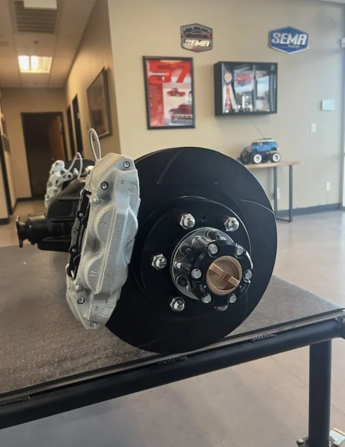

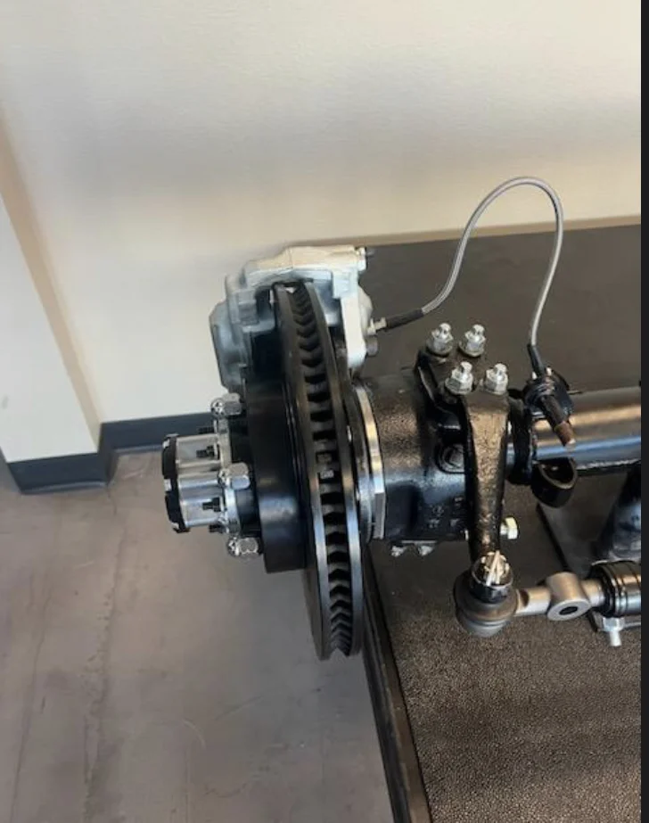

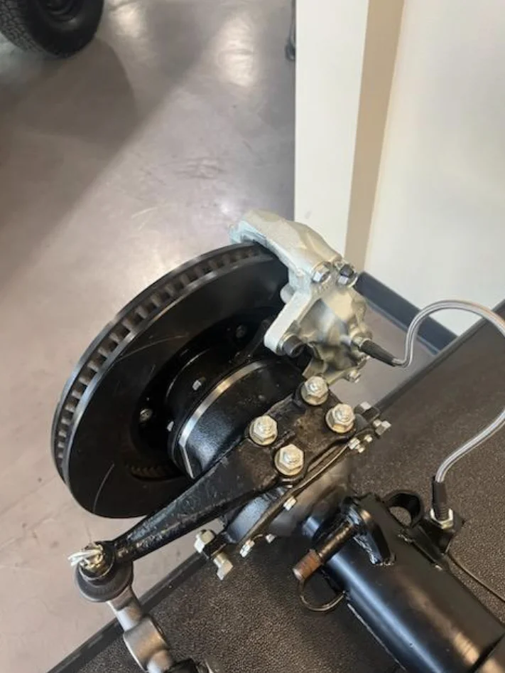

My setup is a 4BT Cummins turbo diesel with NV-4500 5 speed. I’ve got stock rotors and pads up front with an 80s axle and disk brakes in rear. With all the snow in Oregon I got gravel that got between the pads and rotor and scared up the surface of my front rotor. I called Man A Fre looking into buying new pads and rotors and he turned me on to the Man A Fre front Big Brake conversion. Ive had no braking issues but you know when somebody brings up an upgrade it’s great to do some research. Just testing the waters here. The price isn’t cheap. The rotors actually slid over their machined hub which is a nice upgrade. Looks like a beefy setup.
Yep, I've been running this setup (with my brackets) for 2 years
Does the kit use min truck IFS hubs which increase track width? Looks like you also have the cost of upgrading to 17" wheels if you're not already running them. Nice looking kit though.
The hubs they have on the site are the IFS hubs and would increase the track width about 3 in total.
