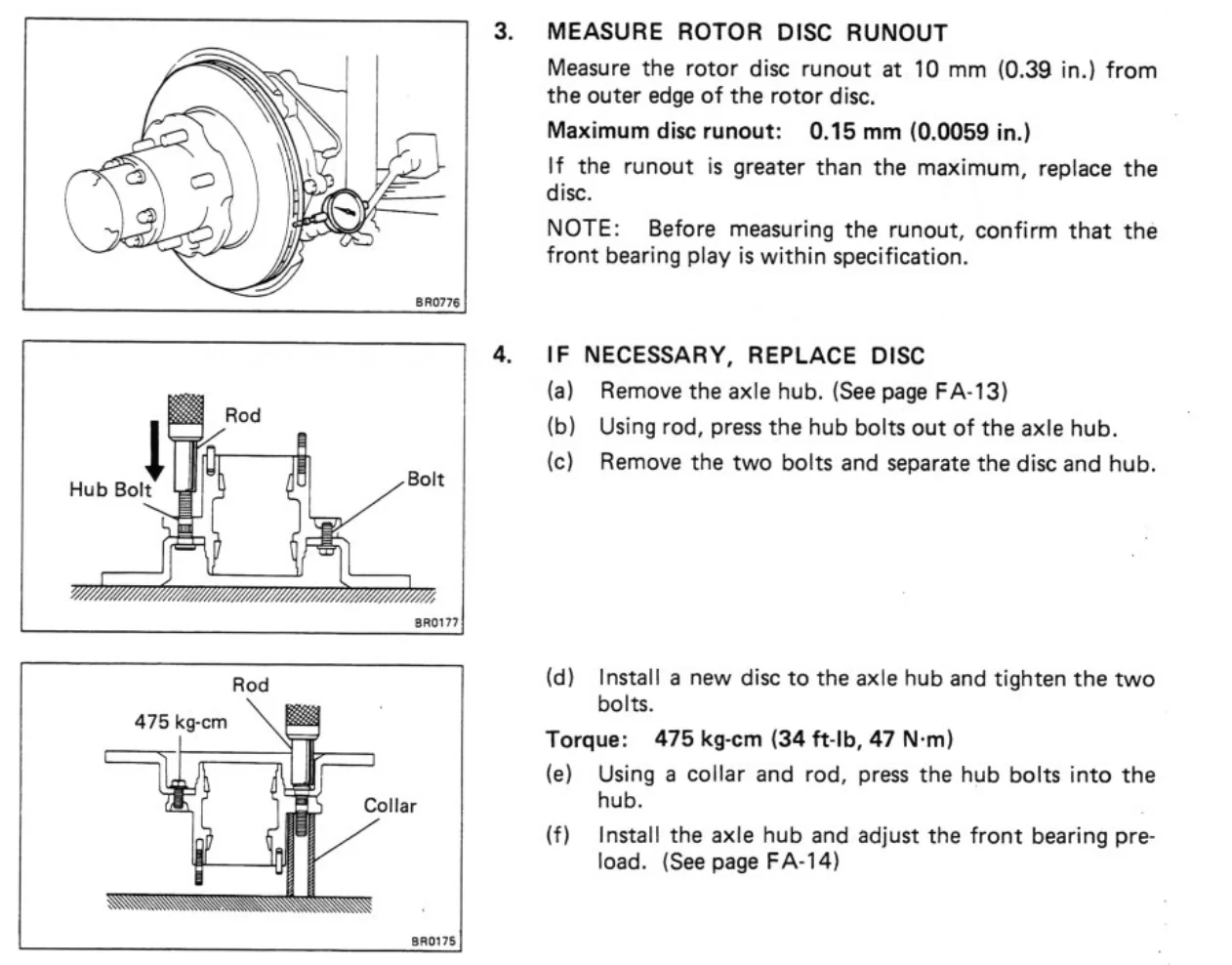

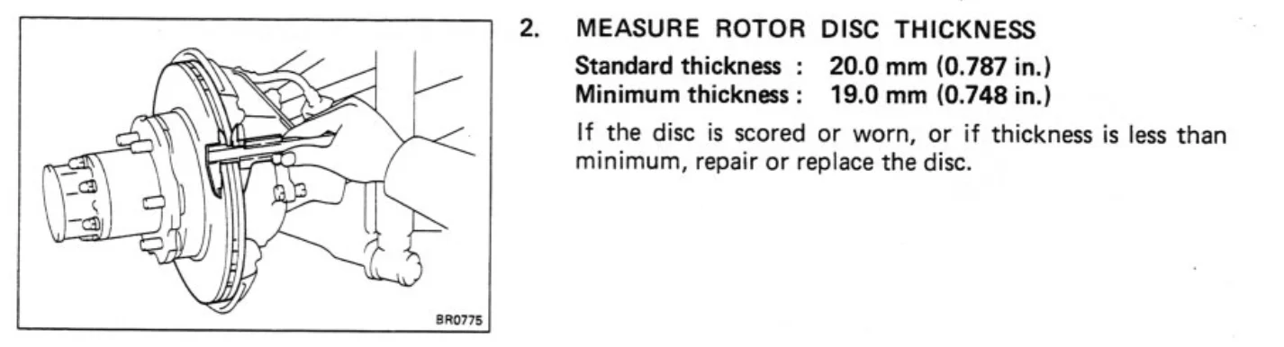

Does anyone happen to know the minimum thickness of the brake disc on an HJ60?
I’m measuring 19mm right now (so I guess it needs replacing?).

Yes, 19mm is the minimum rotor thickness recommended by Toyota.
To get the rotor off, you're going balls deep into the hub, so plan to do wheel bearings and related seals, and consider doing the entire swivel hub if it hasnt been done in living memory..
Its absolutely a job that a beginner will find very intimidating and daunting.. for that reason, its a great task for a beginner! Go for it.

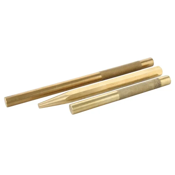

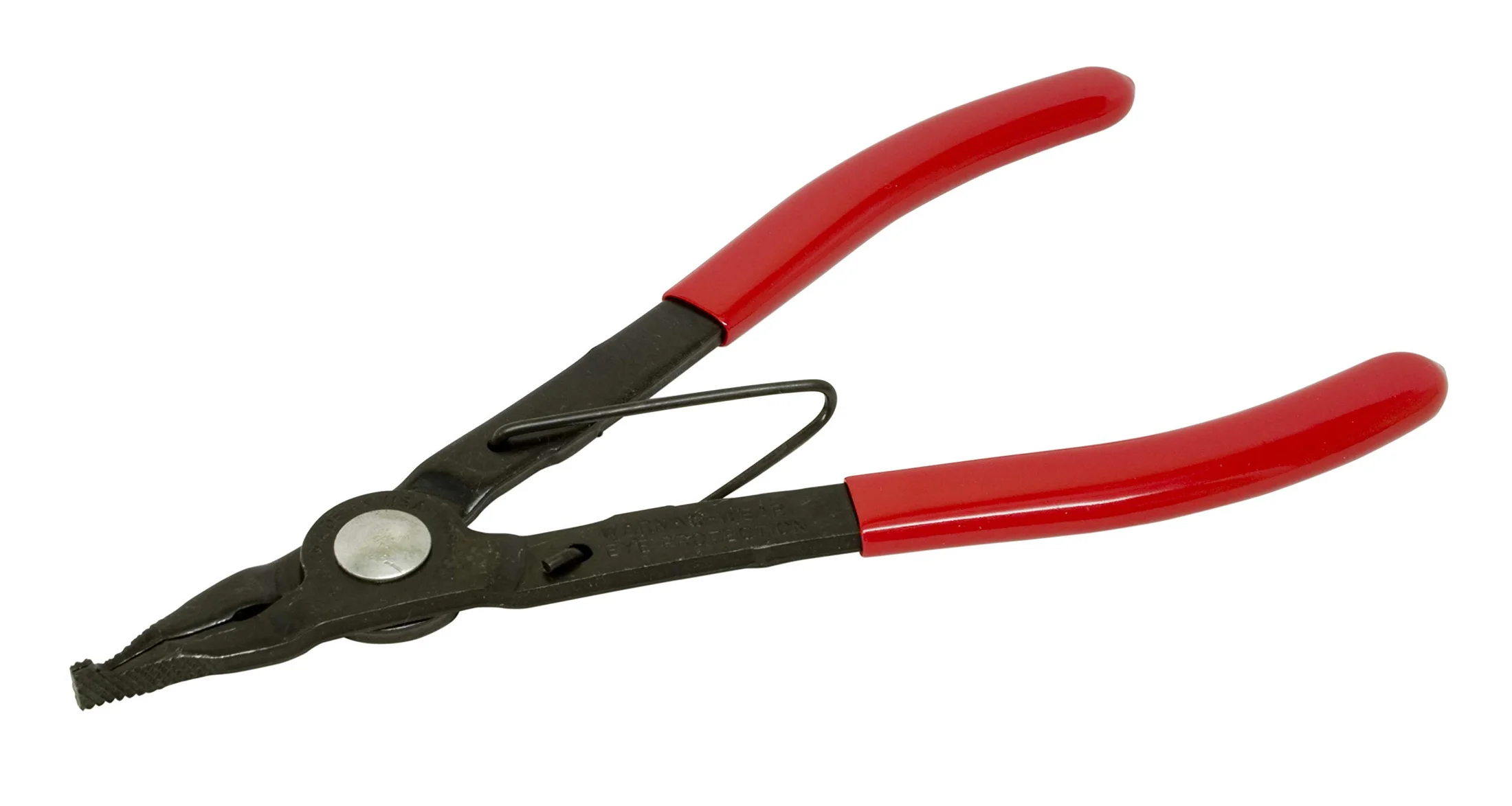

For bearing/hub/swivel hub work the other essential tools to own (in my opinion) are a good set of brass drifts, and a pair of duck bill snap ring pliers. As long as you have a reasonable tool set already (sockets, spanners etc) you wont need a great deal more.
