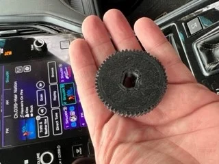

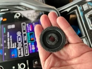

So, I needed a rear window gear...we found the most recent 3-D print file and made one. I have not tested this yet. want to do a little sanding between the teeth. It will be installed over the weekend and I will let people know how it goes. If someone else wants to be a test dummy let me know and I will look into printing a few more and will send them out for free in the US.

Got the rear window working the gear we 3-D printed. Works pretty well actually. The one thing I noticed is that going down, obviously assisted by gravity and the weight of the glass, it is as smooth as butter. Going up seems to put some strain on the motor. Honestly it would go up on its own, but I cannot help but to want to help it some. All contacts points have been lubed so I know it isn't that. It that what others experience? The stripping that the glass slides in is new and probably a little tight. Could it just be that the motor is old and that's just how it will be?
I figured mine was the screwed felt due to lining on the driver's side track. IF yours are new I agree they may be little tight. Outside of that if everything lubed up it may just be the way it is. Congrats on your victory!

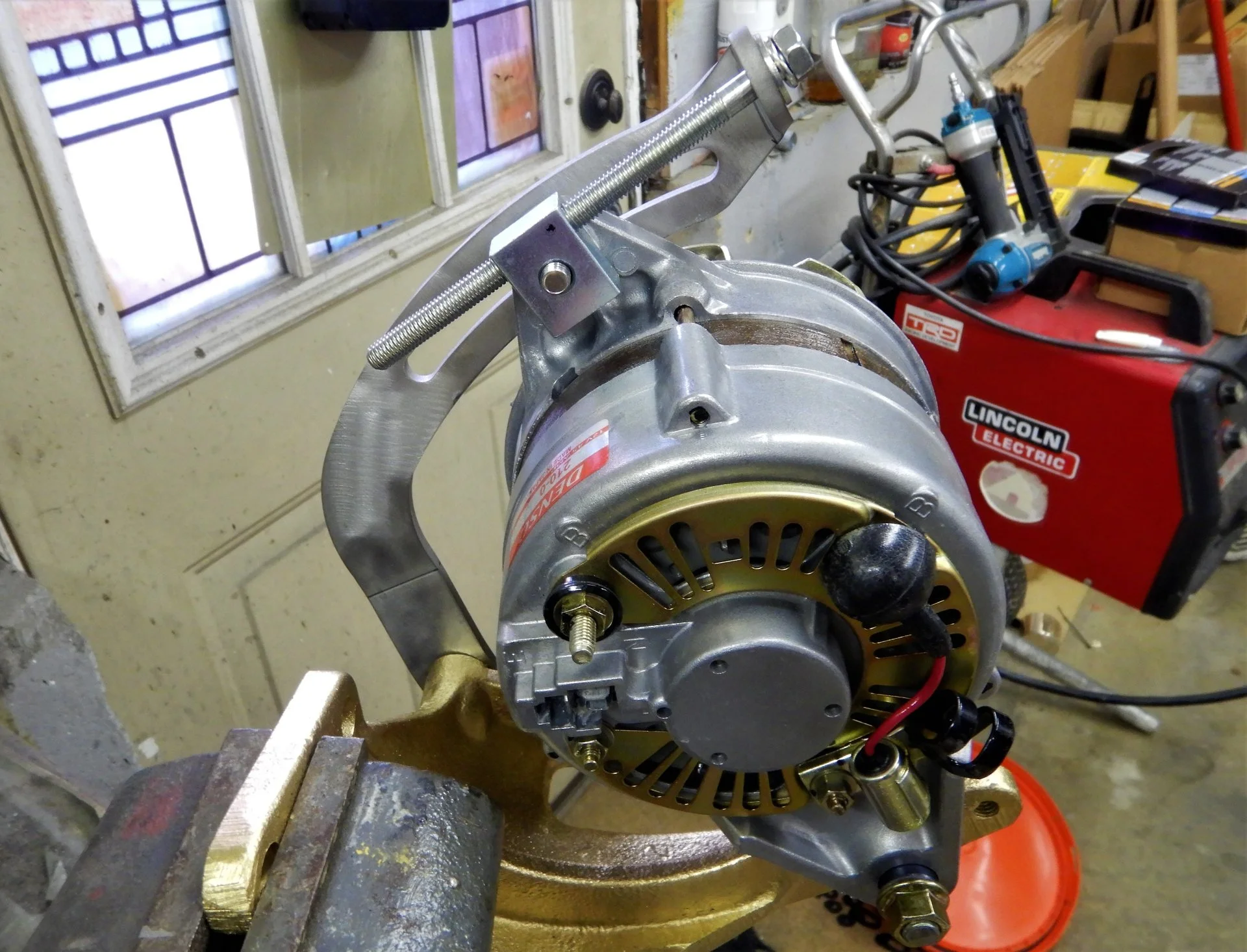

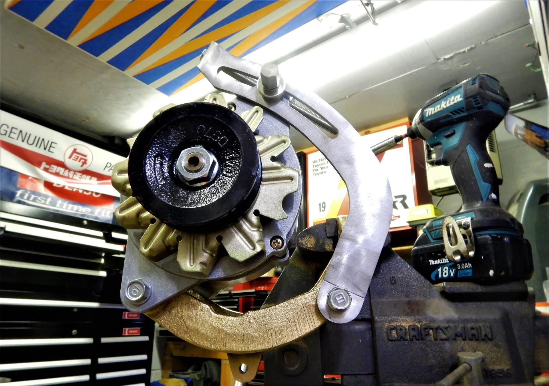

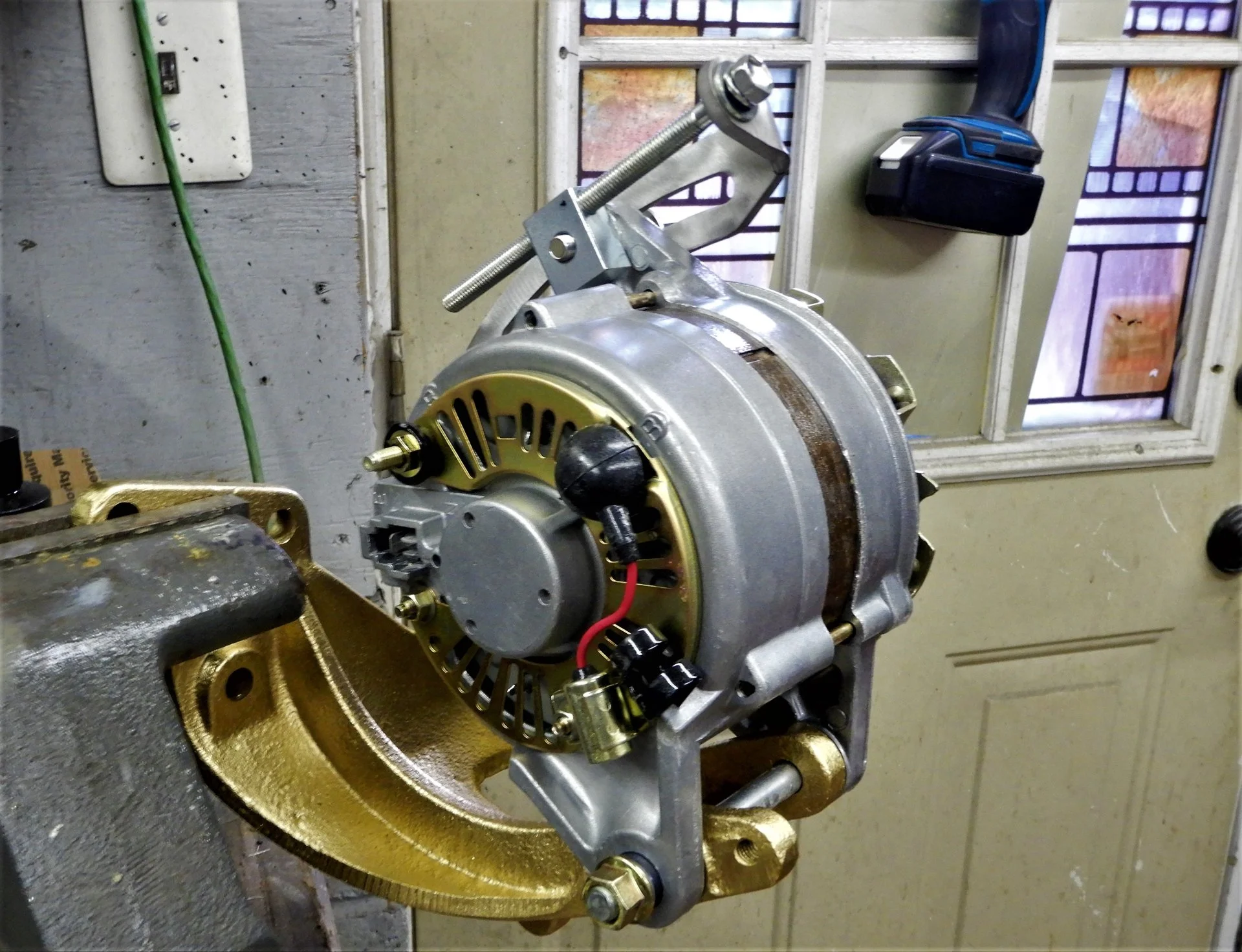

That looks amazing…you’re way out of my league on the fabrication….great job
thanks ,
i just spec'd it
i out sourced the actual metal work
its all about the initial idea you bring to the table
and yours is indeed TOP SHELF !
matt
