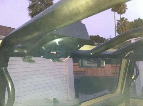

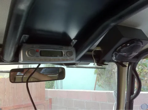

I used a boat stereo with remote head unit. Main electronics are in the pocket. Control unit is on a panel on the roll cage.
Speakers are waterproof marine speakers mounted in Radio Shack project boxes. Two QuickFists are used to mount the boxes to the cage.
