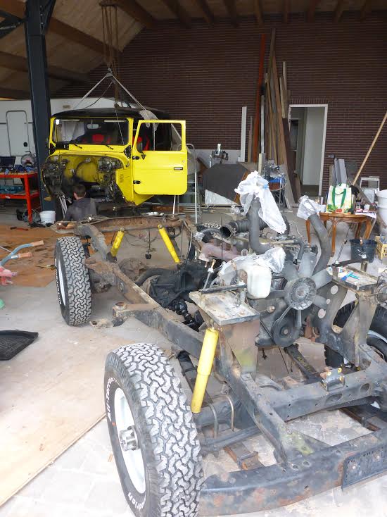

after having raised some questions(AM I AN IDIOT?) and doing some soulsearching, I've bit the bullit and started the frame repair on the sponge.
The plan is to strip down to bare frame, weld and replace where required then send to be mediablasted and powdercoated. I thought about galvenising or "schoperen" bur the costs were what held me back. BTW schoperen is a dutch word for the proces wherby they shoot molten pellets of aluminium on the frame thus coating it in aluminium.
By creating this thread I hope to keep track and get a solid platform questions I am undoubtly going to haveo_O
"The shop"...thank you ED en LOEKI
How it sits after a day of hard work

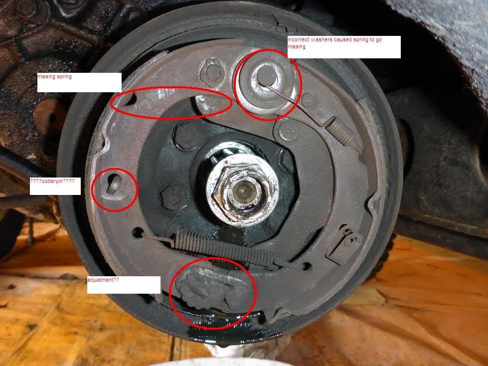

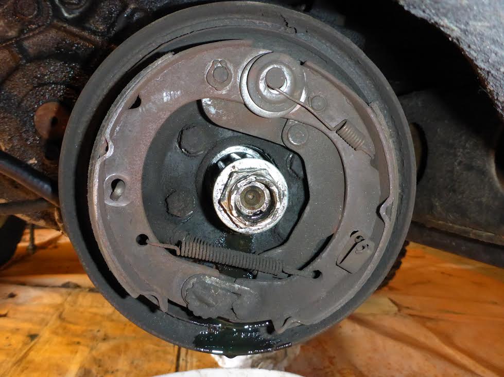

Thanks to the tip, I got the nut off. Her's what it looks like
also note the LH shoe retainer....yes that is half a cotterpin. And I think I'm missing a spring??:mad:

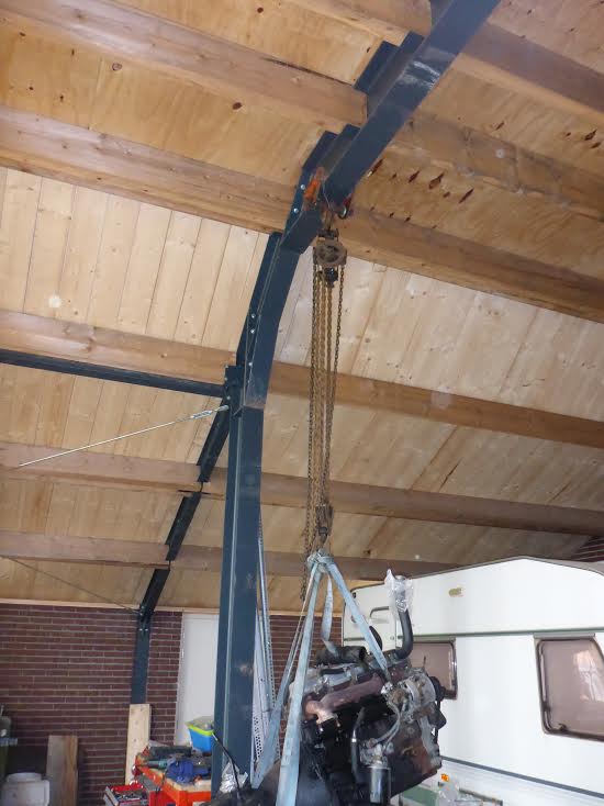

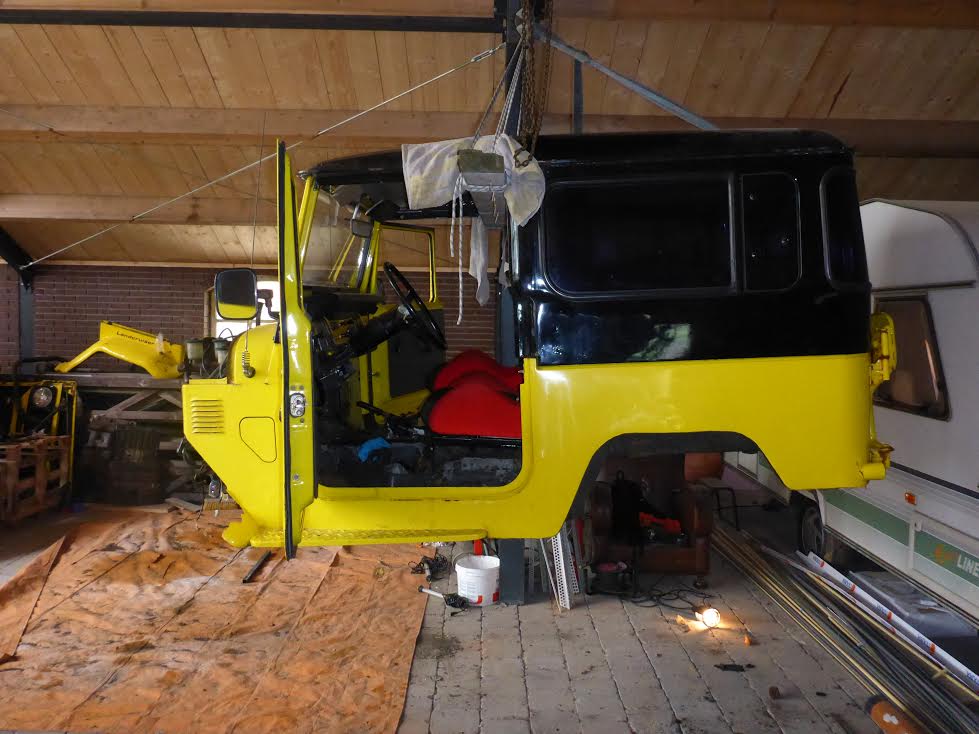

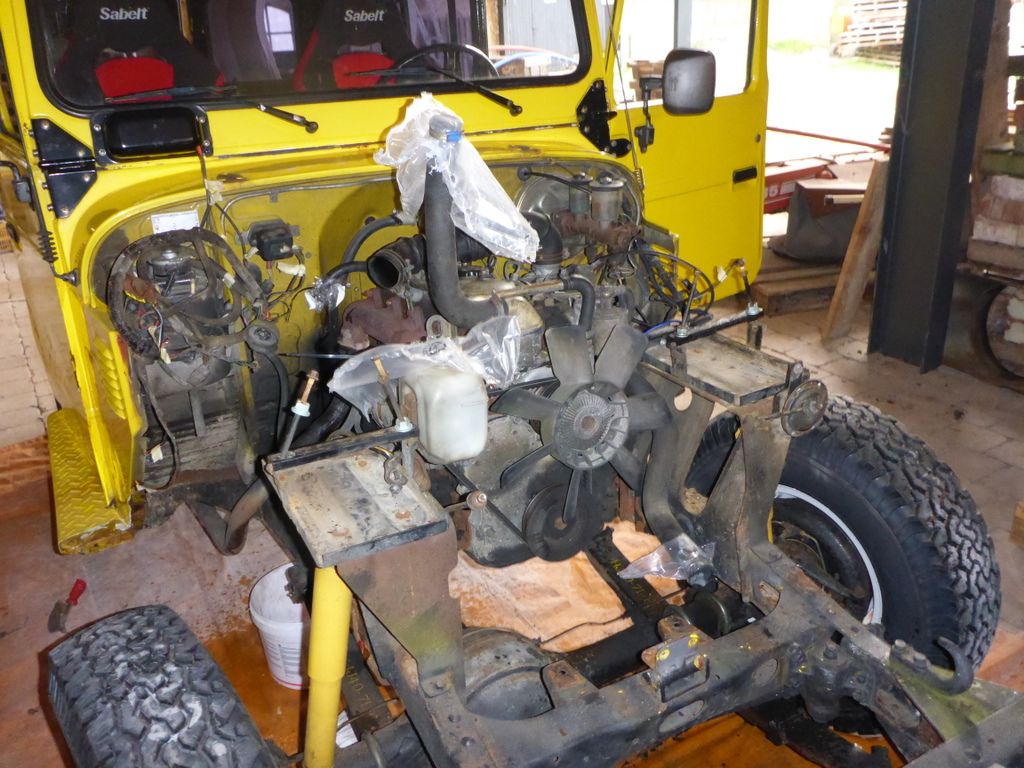

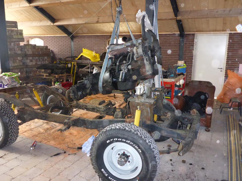

The engine is off chassis
Even the hoist we used is period correct:lol:

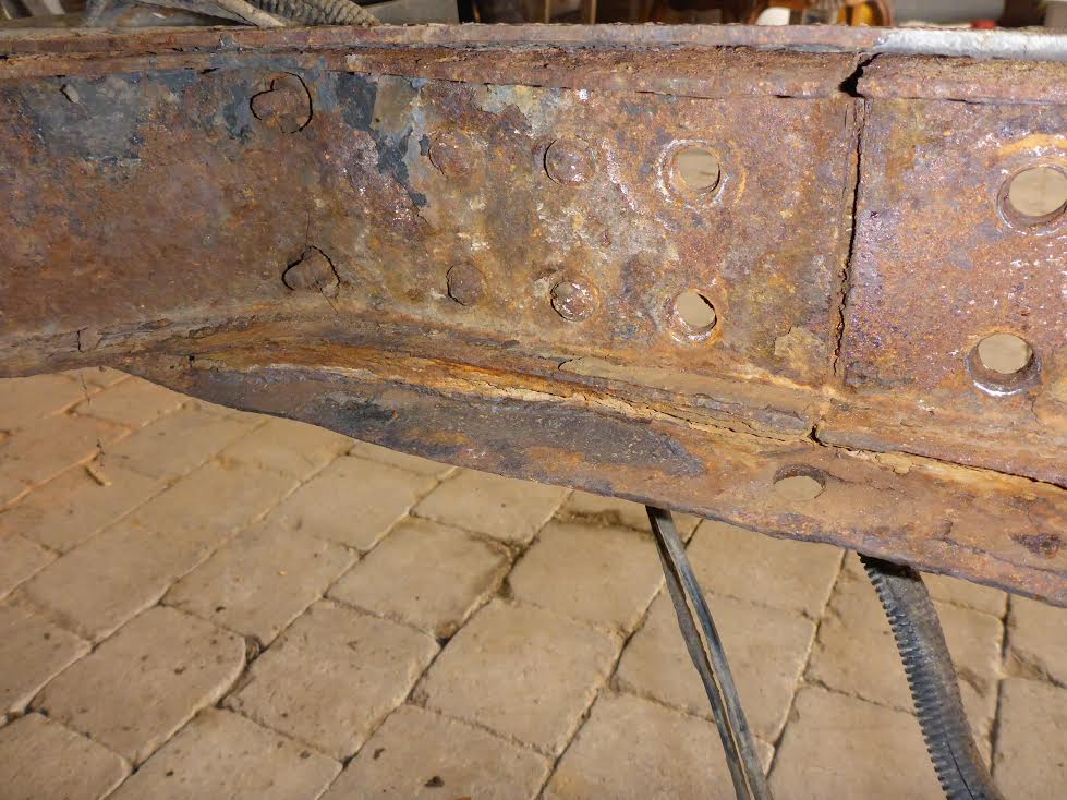

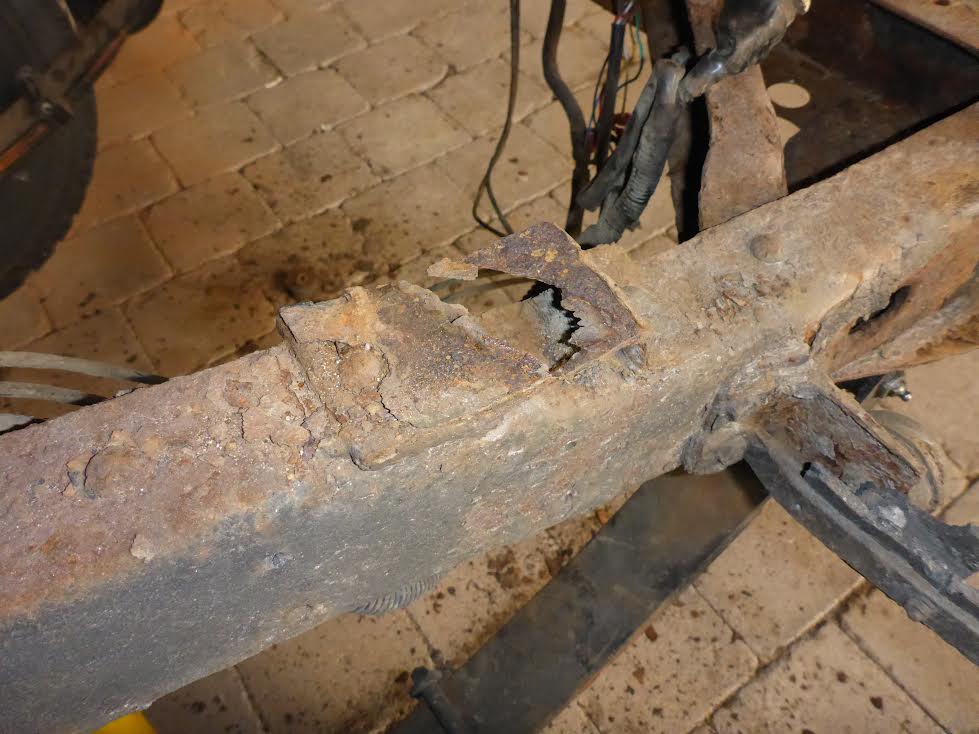

Here is the chassis cancer
The rest doesn't seem all bad. I'm guessing i need to replace the lower part of the rear bumper and both gussets. The rest of the chassis is still about 4mm thick but I need to take a closer look.

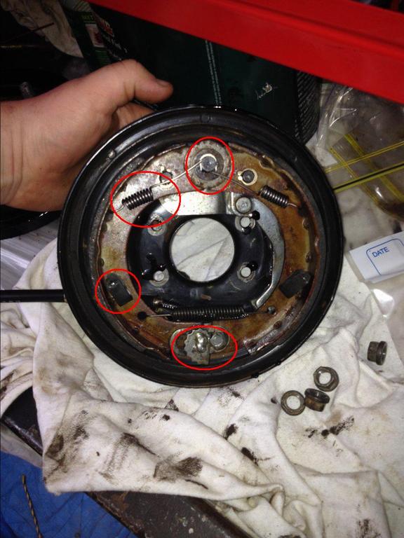

Here's is a pic of my rebuilt parking brake
Have you replaced the seal yet?
I thought about that. but since I haven't noticed a leak before I removed the drum and the haynes manual says to drain the t-case, I figured it was normal to have some oil come out after you've loosened the outputshaft nut. Ow and I didn't drain the case because I'm a smart-ass-know-it-all, who should more often listen to what he's told:bang:
View attachment 884592 Here's is a pic of my rebuilt parking brake
thanks for the picture. It does illustrate some issues nicely and explains why my p-brake doesn't function properly as well as brings up some other issues.
Does anyone know the deal on the bottom adjustment? Is it a manual adjustment? Or is it maxed out because my shoes are too worn?
Replace that seal and put a LITTLE rtv (or similar) along the splines...
