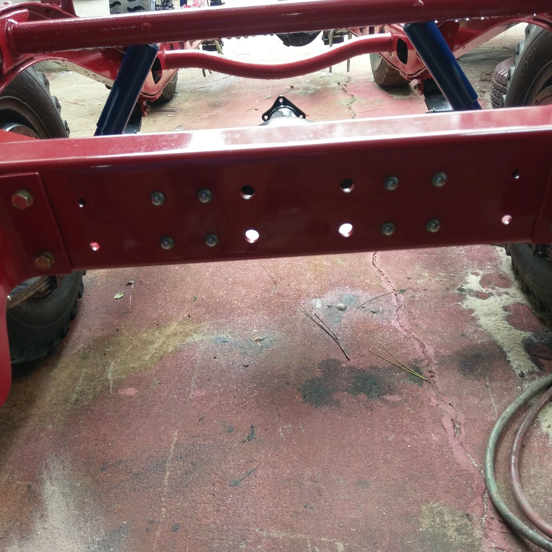

I’m actually removing all of my frame rivets and replacing them with bolts. There’s some parts of the bottom of the inside frame boxes that have rusted through so I’m breaking it all down to cut out the rust and weld in new steel. My plan is to also weld in captive nuts and use the button head Allen bolts as mentioned above. All of my frame pieces are getting galvanized and powder coated soon and I’ll be posting pics of my frame resto and rivet conversion soon.

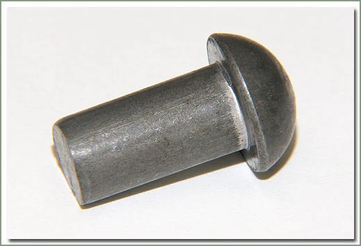

Sor. Sells them the look great. Had the same issue on my fj25.

No i welded them on the backside. Looks oem if you weld them carefully. They are rivets.

LOL, that was my reaction. A torch/oven to soften them with heat (then freeze them to make it so you can handle them, you have about a 2 hour window before they harden again) and then an air powered riveting tool is all you need to do rivets.

has anyone found these rivets elsewhere, reason i ask, is at 2 dollars a rivet ends up being expensive. I found a company that sells 10 of them for 3 Pounds in UK, nothing against the seller, just looking for a better price.
edit. after looking
Zoro Select Rivet, Round, 5/16 Dia, 5/8 In L, PK40 351010U.1 | Zoro.com
placed order here, and will evaluate. 8 usd for 40 rivets, will report later

I know I have said I was going to start this in the spring, but life always gets in the way sometimes. I finally have enough time and room to get this started..I will be ordering the rivets from a supply house and bucking them in the same fashion as factory. I will try to document the results and keep everyone posted. I should have something right after all the deer seasons here in NJ are over.
