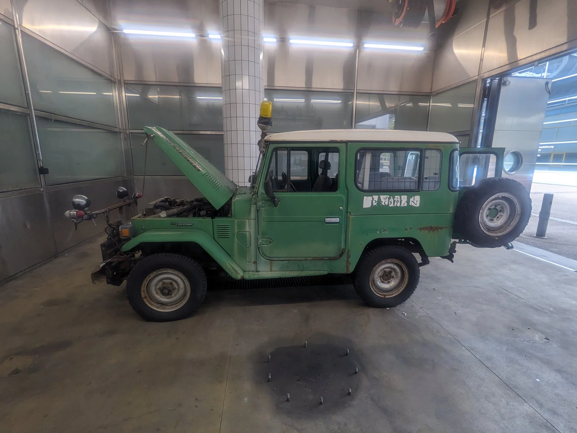

Hi All
I've been a silent observer on this forum for a while and have gained a lot of insights from all of you. I finally took the plunge and purchased an FJ40, with the primary goal of diving into car repairs and learning welding.
Only thing i done before was the 50cc mopeds in my youth. So i am eager to learn and do what it takes to get this car back on the road.
The Model FJ40
Year 1980-81 2F Engine
66k Milage
Status

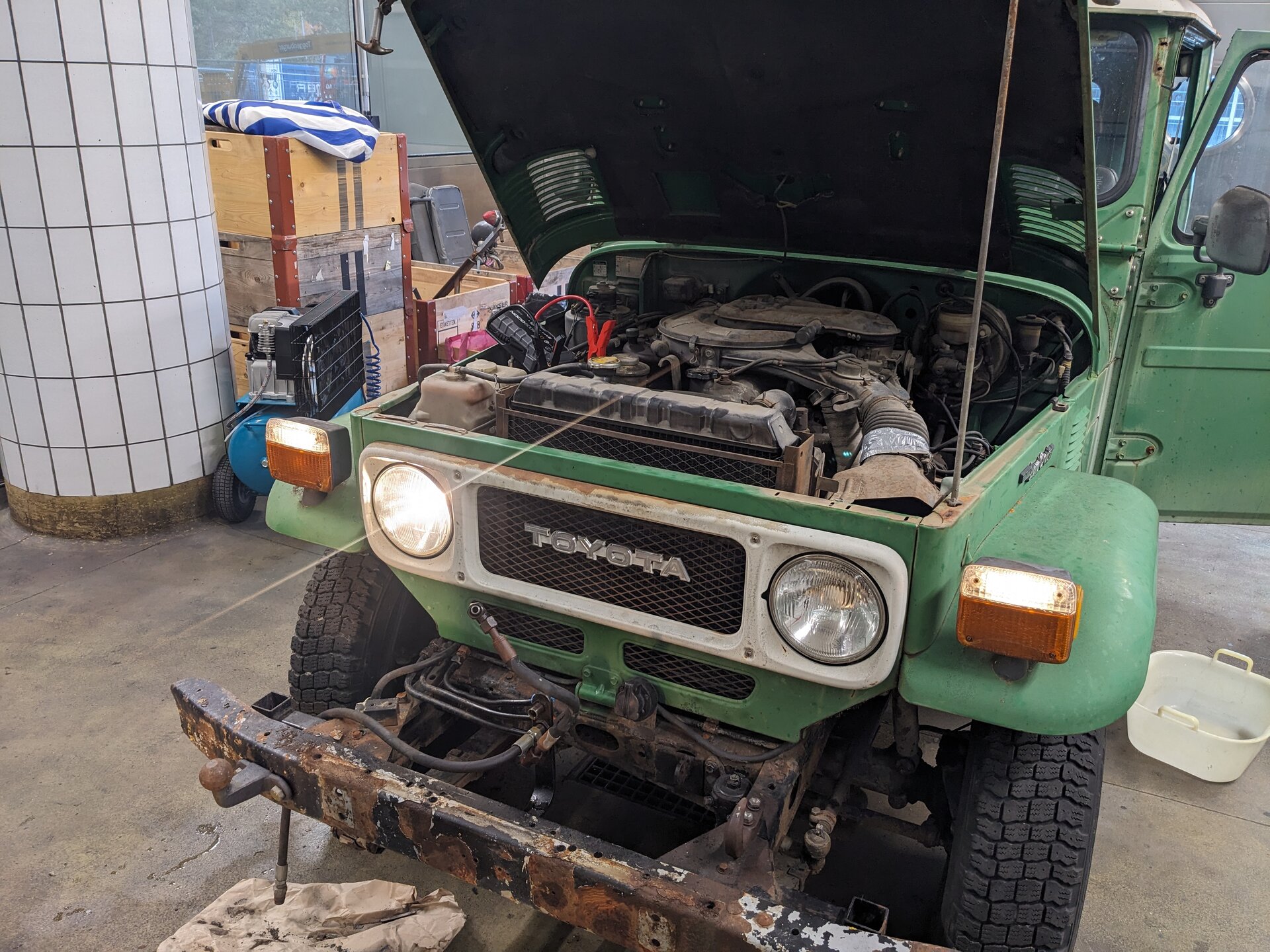

It starts when connected to a starter and idles smoothly with the choke in. Shifting gears hasn't been an issue, but I haven't taken it to high speeds or on main roads due to missing parts.
What i know of its past
Used from '81-'89 primarily for snow plowing, which possibly explains the salt damage. It was then retired to a shed.
Current Condition observed

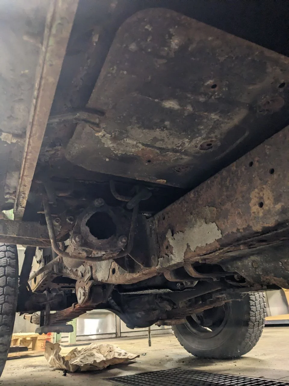

  • The exhaust is missing, and a significant portion of the body has been patched up with bitumen.
  • There are hydraulic lines all over because of the plow
  • Looks like there was some additional wiring because of the headlamps on the plow.

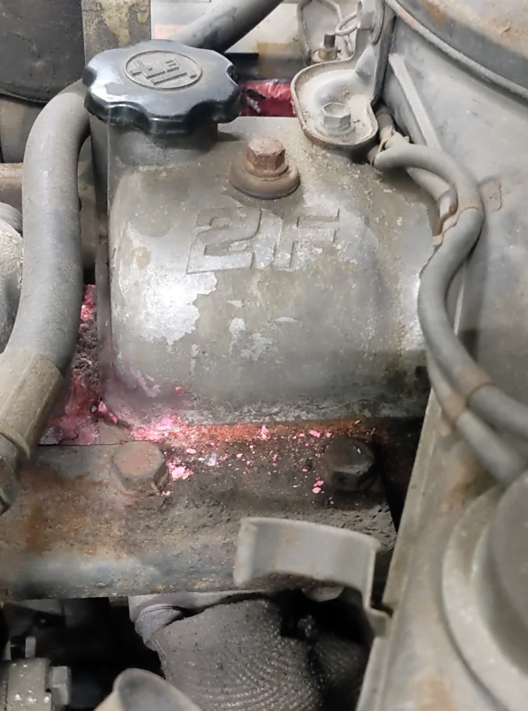

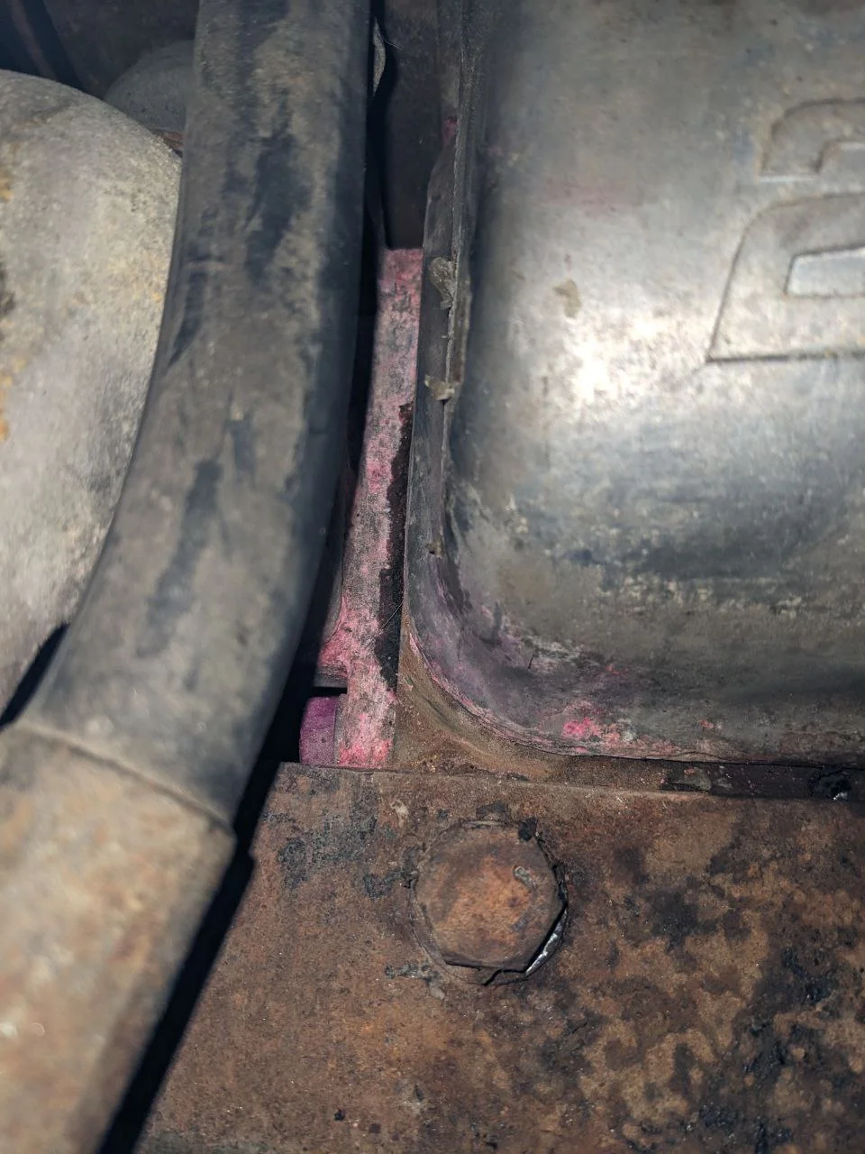

  • Cooleant seems to be leaking out of the valve cover. There is a pink buildup.
  • Squeky sound from the belts probably

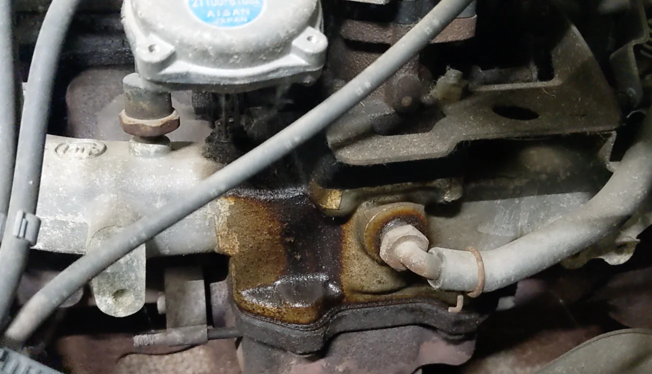

  • Leaking Carb?
My Goals
Get it back on the road here in Switzerland. First and foremost with more or less original parts. I want to do a restoration where its necessary. For instance the engine. If everything is fine i would just leave it as is, clean it, change the head gasket and paint it.
I want to disasseble the whole thing sandblast, weld and paint body and frame. Also redo the interior.
So over all its a good chunk of work. Exactly what i wanted.
So far
I have removed the Plow and some of the metal work supporting the plow. I flushed the engine with a motoroil cleaning kit. And i took out some parts from the interior.
Now i have a few questions where im not to sure how to go about. I saw a video of a guy restoring an F motor and after doing hours of work he saw the compression of two cylinders were off. So i was thinking of doing a compression test first. And then see the valve clearance and if there is any rust buildup inside.
What would you guys do first? How to troubleshoot whats the next step.

Looks like it's in great shape.
I'd give it a service, fluids, filters, grease all the nipples etc etc. And try and get everything working while it's all in one piece. Drive it around for a while and see what falls off. Quick way to find the big issues.
Coolant leak and belt squeal could be the same problem.
+1 for change all the fluids and filters - look at the fluid for glitter, feel for grit, check the magnets on the drain plugs; cut open the filter.
Check/set the valve clearance. On the loose side is better than burning a valve because it was on the tight side. A leaking brake booster will make #5 run lean.
Yes on a compression check - first dry, then wet if necessary. Look at the plugs, they can tell you a lot. So can a leak down tester. A bore scope would be a good tool to look in the cylinders and other places.

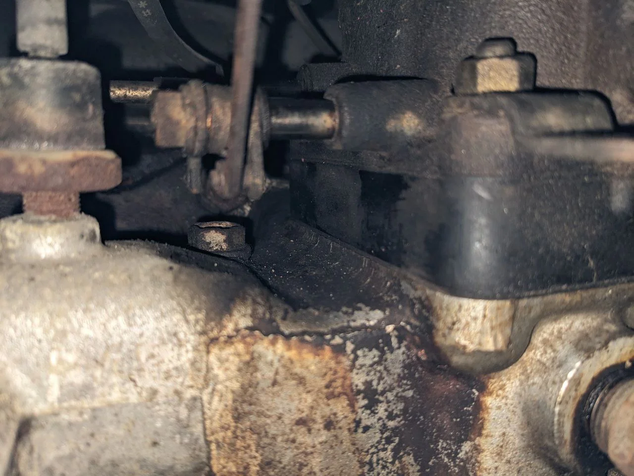

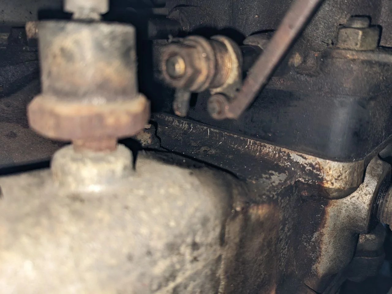

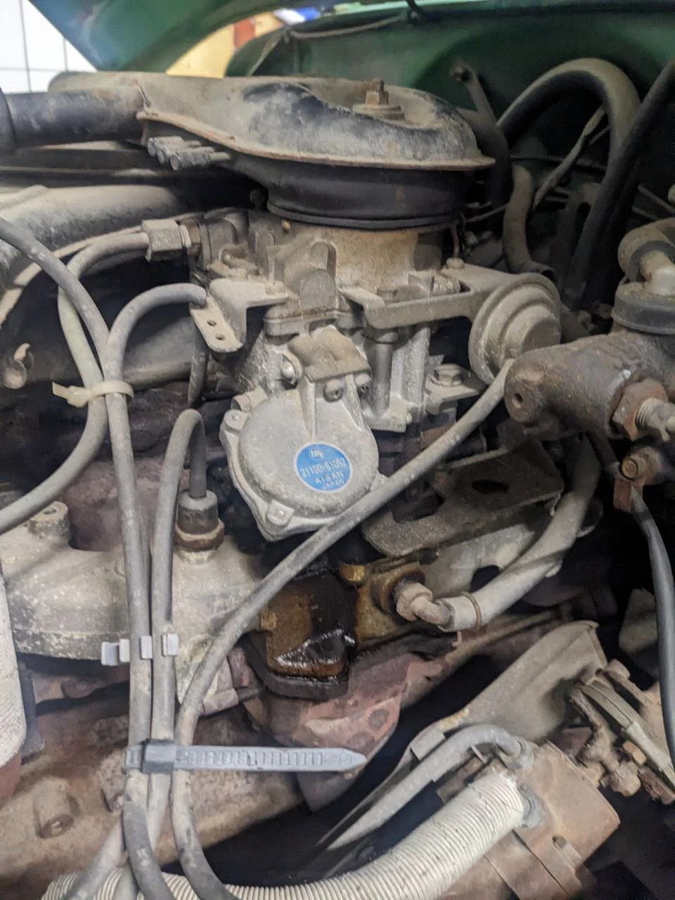

That last picture, in the first post, of the carburetor / intake manifold, that looks like gas leaking. You're gonna want to make sure you aren't leaking gas, that can be pretty dangerous, start a fire... You should start there, before running it any more.

As pb4ugo mentioned i now checked the old cooleant crust and i think you were spot on. Saw a new dropled just between the thermostat and the lower housing. So i guess thats an easy fix.

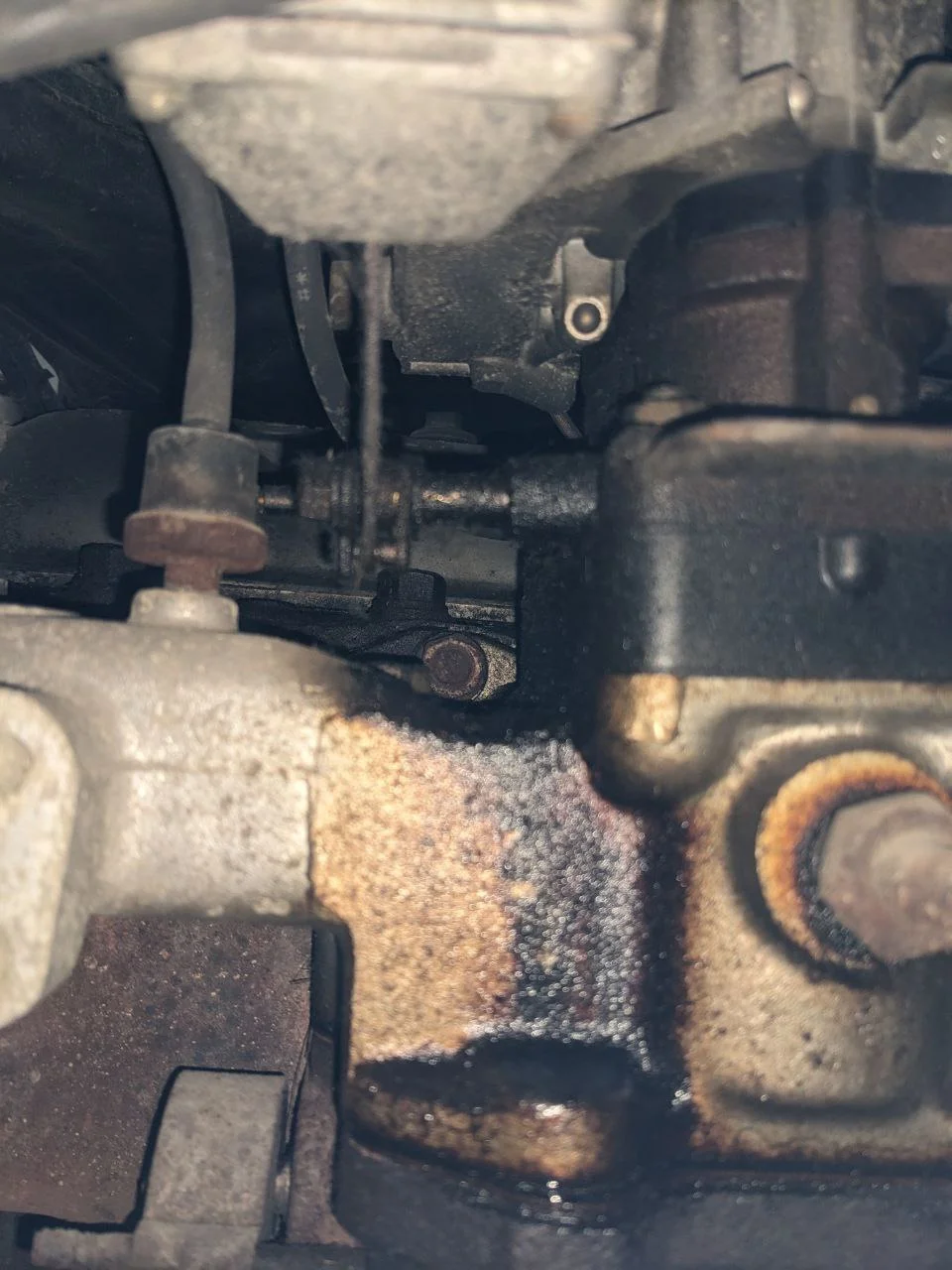

As Kerplunk mentioned i seem to have a leak where the carburator sits. Im not sure where it is coming from. But it looks like its all over the place next to these two bolts (not sure what they do or are :). I attached some images. It did smell like gas and i think it came out during the last video. So this is the next thing i need to get done. Any advice what it could be? I saw on one of the bolts there is a stopper ring not really where it should be. Also visible in the picture.

After the drive i checked the cooleant leak and the carbs. I attached the first three pics of the result. Carb looks dry. So i suspect me leaving the choke open for too long last time? Anyways i will buy the kit and keep an eye on it.
The cooleant leak looks a bit strange. As there is some wet places visually observable next to the headcover. So i think it might seep out there still? Or it could be an oil cooleant mix which is very sticky and stuck on the top there. (Third Screenshot)

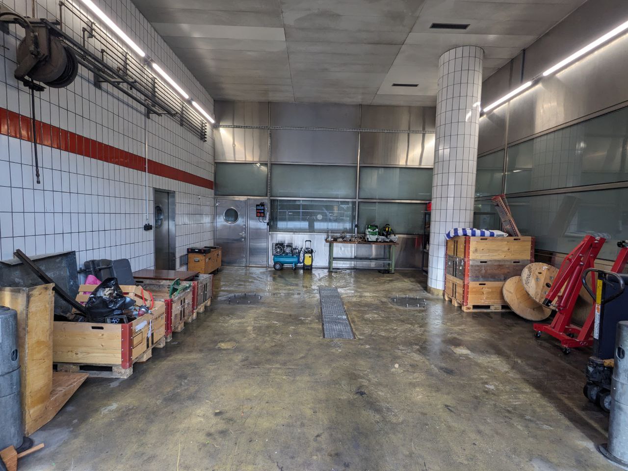

Then i was excited what i got a garage now so i cleaned it all up and brought in some stuff. I have this little crane thing now as well for lifting the cabine and the engine. So far i think things look good.

Nice shop. IMHO FJ40's are good, down and dirty, easy to work on, fantastic off road working trucks for the money back in the day. Cosmetic's on an actual off road going vehicle is a waste of money.
$11,000 will buy a nice welder and some other metal working stuff.
Sometimes floats stick a little or a piece of crud gets stuck in the needle valve, from lack of use - running the unit can flush or dissolve the crud. A can of fuel treatment every so often can be a good investment.
Good plan to have carb kit on hand. Other parts too.

The trouble owners have in some of these European countries is vehicles can not display “rust” or a “rusted through” portion of sheet metal. Now toss is the mid 70’s Japanese metallurgy issues and it’s a tuff situation to deal with from the perspective of a “hobbyist” in Switzerland.

Thanks, the shop will get new tools on a regular basis :D I have a MIG welder as well so i have some tools to do the metal work. Sandblaster is probably the next thing i buy.

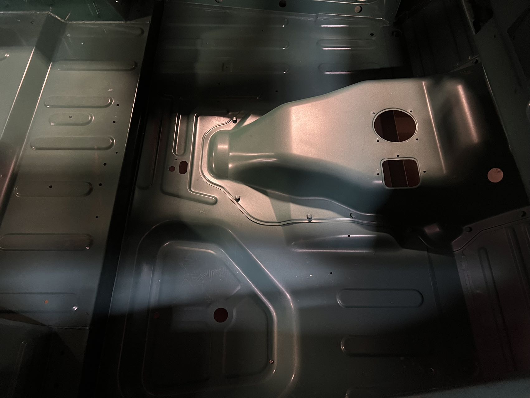

Unfortunately i cant get the car on the street in Switzerland with the rust. Its just not possible, so i have no other option than to go after the rust. So i need to still wager what i want to do. But unfortunately i need to basically replace almost the whole tub part by part because its so rusty. So i have the option of buying a lot of panels and redo the floor of the seats and the trunk as well as all the sides so i am thinking about getting the tub directly. I still have enough parts to work on with the welder :)
I have found a few Tubs but im not sure which one. I saw in other channels there is a few.
Currently since in Switzerland there is often salty roads in the winter im tending on getting an full tub made out of alluminum. But im actually not sure. Read about the corrosion of the alluminum beeing equally bad. So im really struggling here. I mean i could very well also just buy the steel and treat it well.
What are your thoughts on this one:
And in general what company should i get the steel from when i dont order the aqualu?
On a general note, my goal is to have kids soon and i want to spend the next 30-40 years with this truck. So im in the mindset of now going for premium products to get the max out of it.

So i was reading through all the full tub threads i could find. Many different opinions and pros and cons but for me there is only one option. Steel. I cant handle the interior of the Aluminium tub and since i own a boat and worked a lot with fiber and gelcoat i dont want this on my car also. I actually really dislike it.
So im now at the crossroad of suppliers.
- Relik: (read only bad things) so a no.
- Topnault: He is most likely importing the part directly from the alibaba supplier i just posted above. Because the pictures of the facility look almost identical. But who knows.
- TeSeven: French producer (lead time 1 year :( if it was different this would have been a no brainer)
- LEKMA: Closed shop
- CCOT: Has no full tub only 3/4 tubs.
- Jiangsu: Seems like they have what i need and the leadtime is apparently 10 days :O
Am i missing an obvious one?

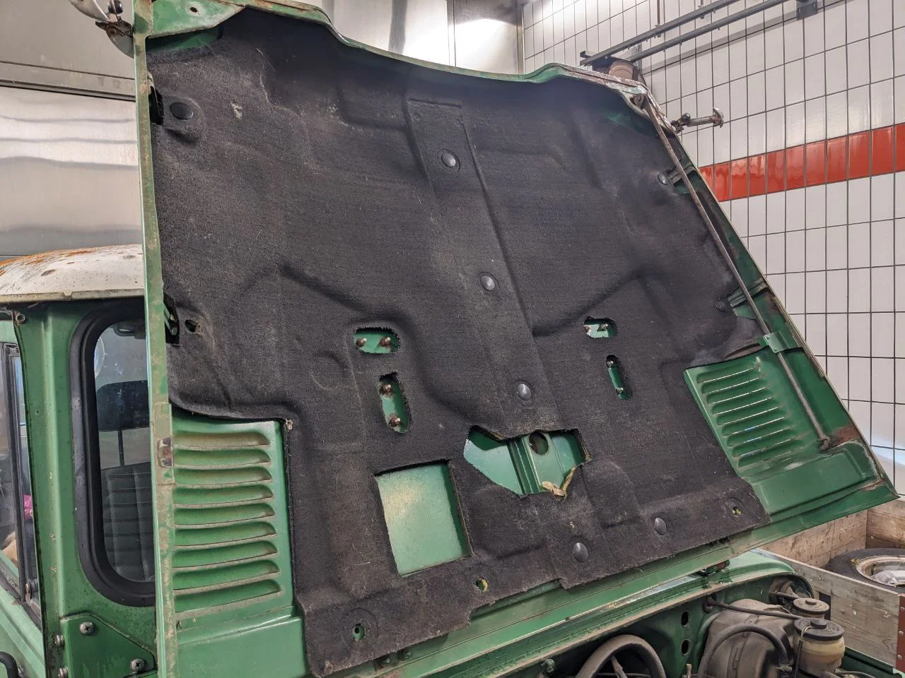

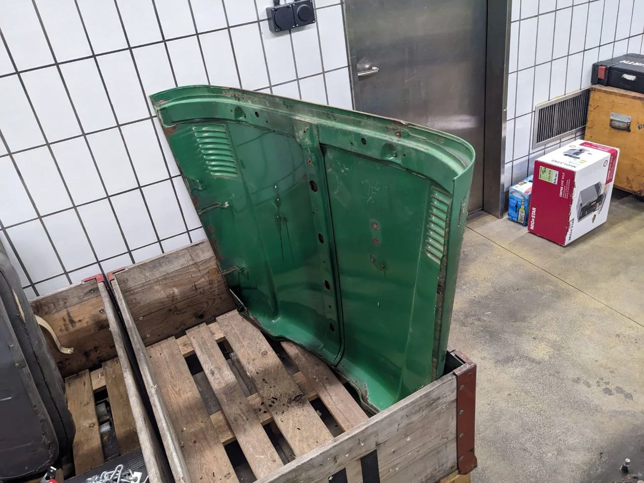

Yesterday i started to tear apart the cruiser. How should is store the bonnet (See image)? It will most likely be there for a year at least. Then i get some furniture and things to have place to chill and research. Thrifts shop things. My dog is comfy, very important.

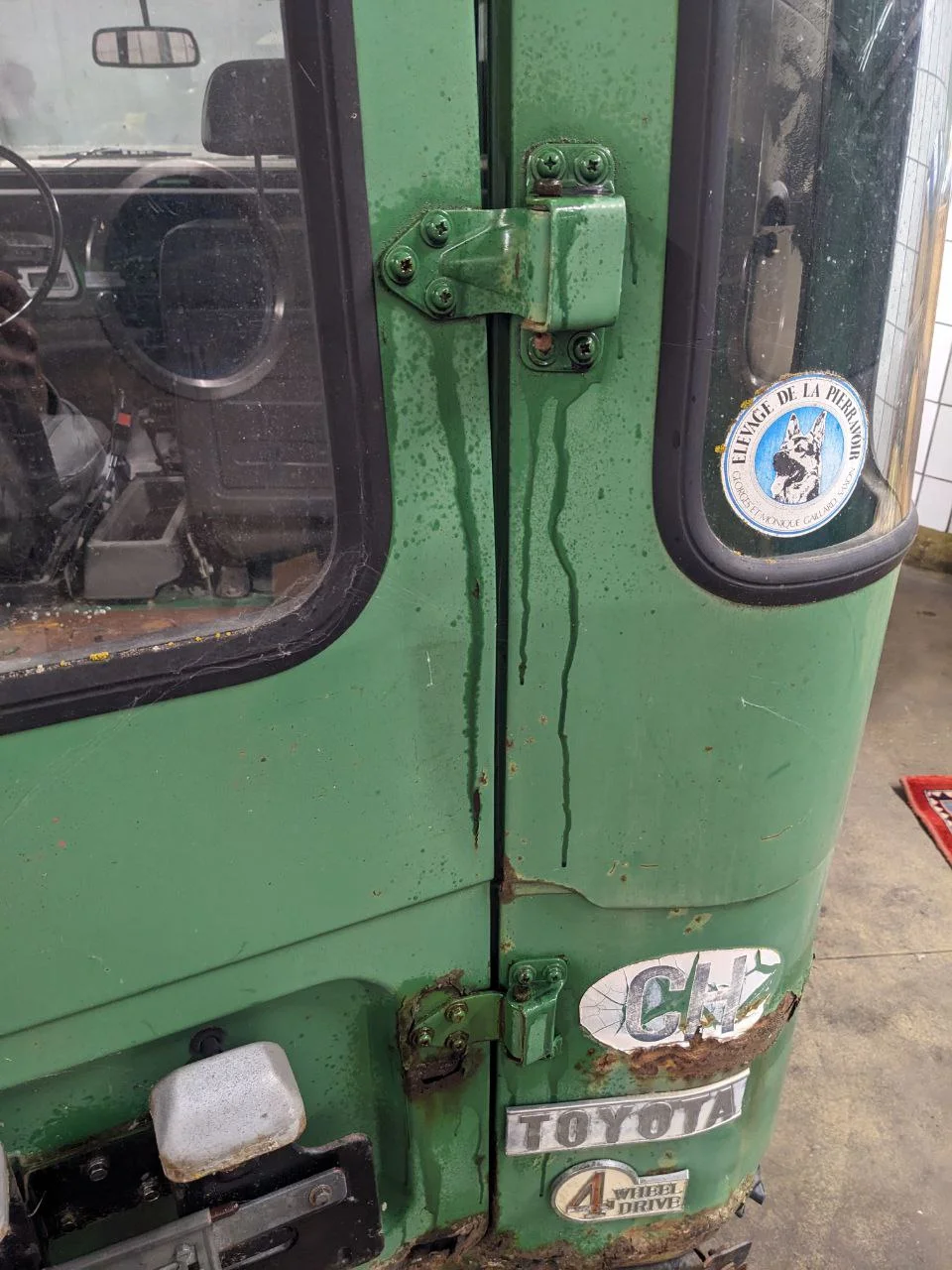

I removed the ambulance doors and the both need some fixing as they are rusted on the bottom and also rusted through where there are the hinges...
Then i realized that i still want to do a compression test so i must let it yet in tact to start it. After this is done im starting full the full teardown.
So many things in my head about the car :D got to organize it better.

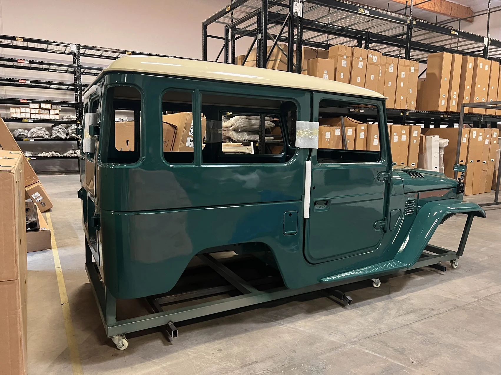

We actually will present this whole cab on SEMA, instead of the whole tub. Sorry for the confusion. We believe we can show more such as how well the pieces go together.
If anyone want this unit, we sell it for $13,500.00. We have no intention to continue selling the painted whole cab in the known future, except this one.
See you guys in SEMA and thank you for your support!
