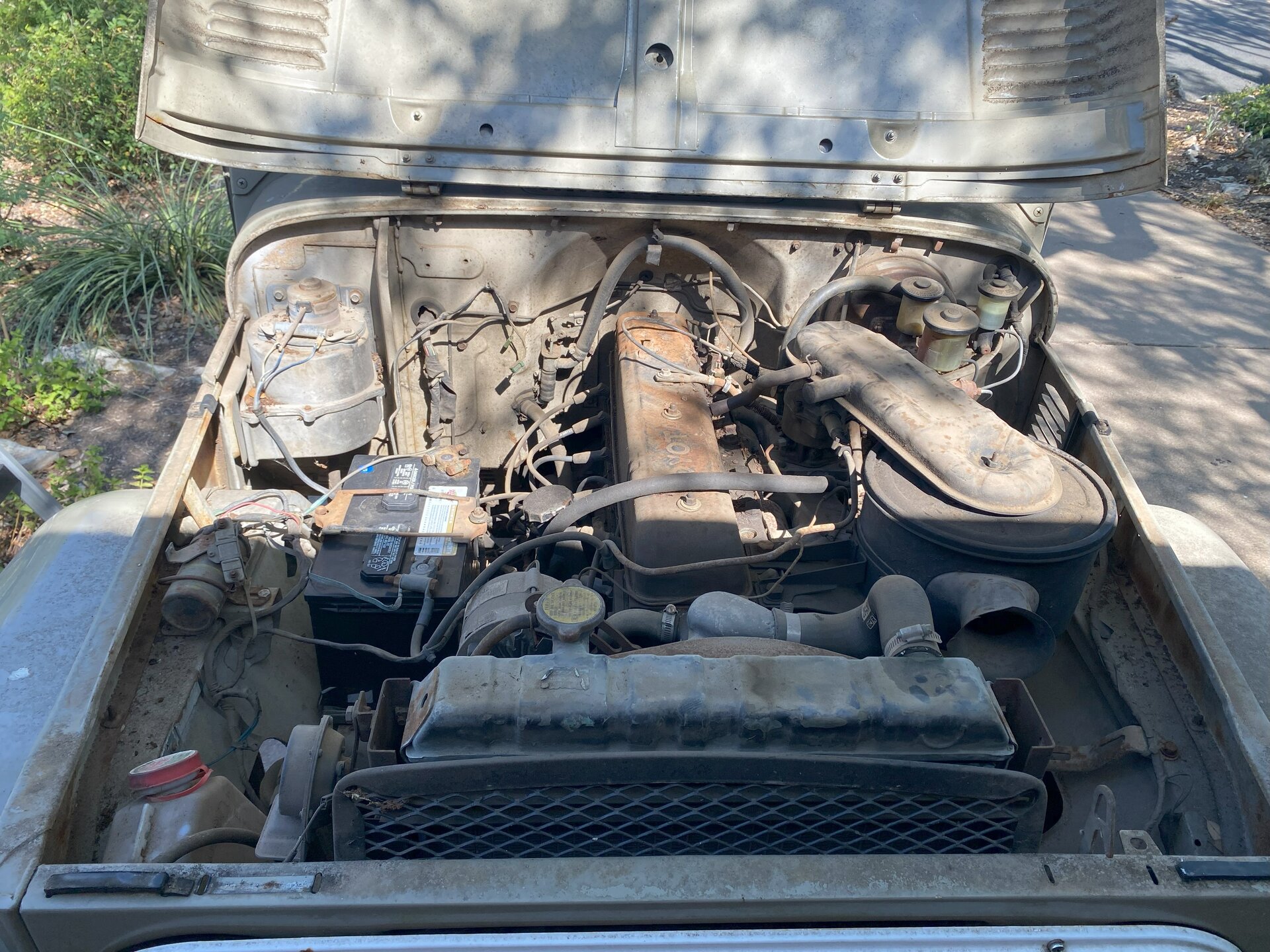

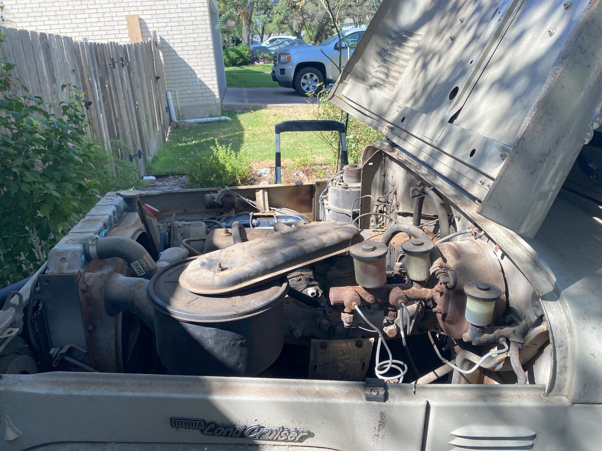

Rather than try to figure out what the heck is going on with that motor, carb, ignition system, etc. I think you would be better off yanking it and shoving in a newer 2f with the carb, ignitor, and all other "bolt on's" still attached. The license plate bolted onto the exhaust manifold pushed me over the edge, lol. Before you do that though, I'd change all the fluids and just drive the crap out of it. I think half the 40's that get torn apart never see the road again!

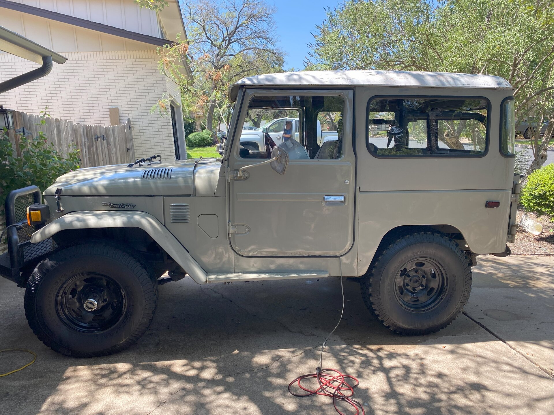

Howdy! I am excited to be joining this great community. My entry is a 1975 FJ40. She's been sitting under an oak tree for the past 5 years, which helped prevent sun damage, but left her with a lot of moss growing on the roof.
VIN/Frame: FJ40-200897 (May 1975)
Engine: F-258321

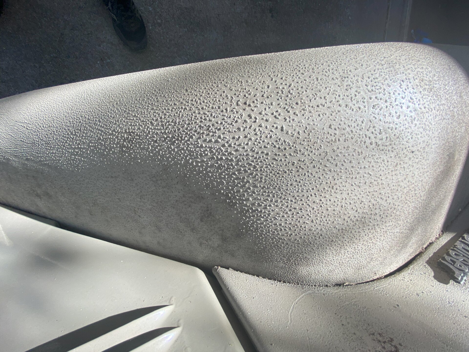

She runs and, after giving her a bath today, has a great body. There are some rust bubbles at the bottoms of the doors, but the body is otherwise in great shape. One front fender has some odd texture to the paint.
I plan to clean out the interior tomorrow, so she'll have the day to dry out before I start to plan for the future. I do know the seats are very likely toast.

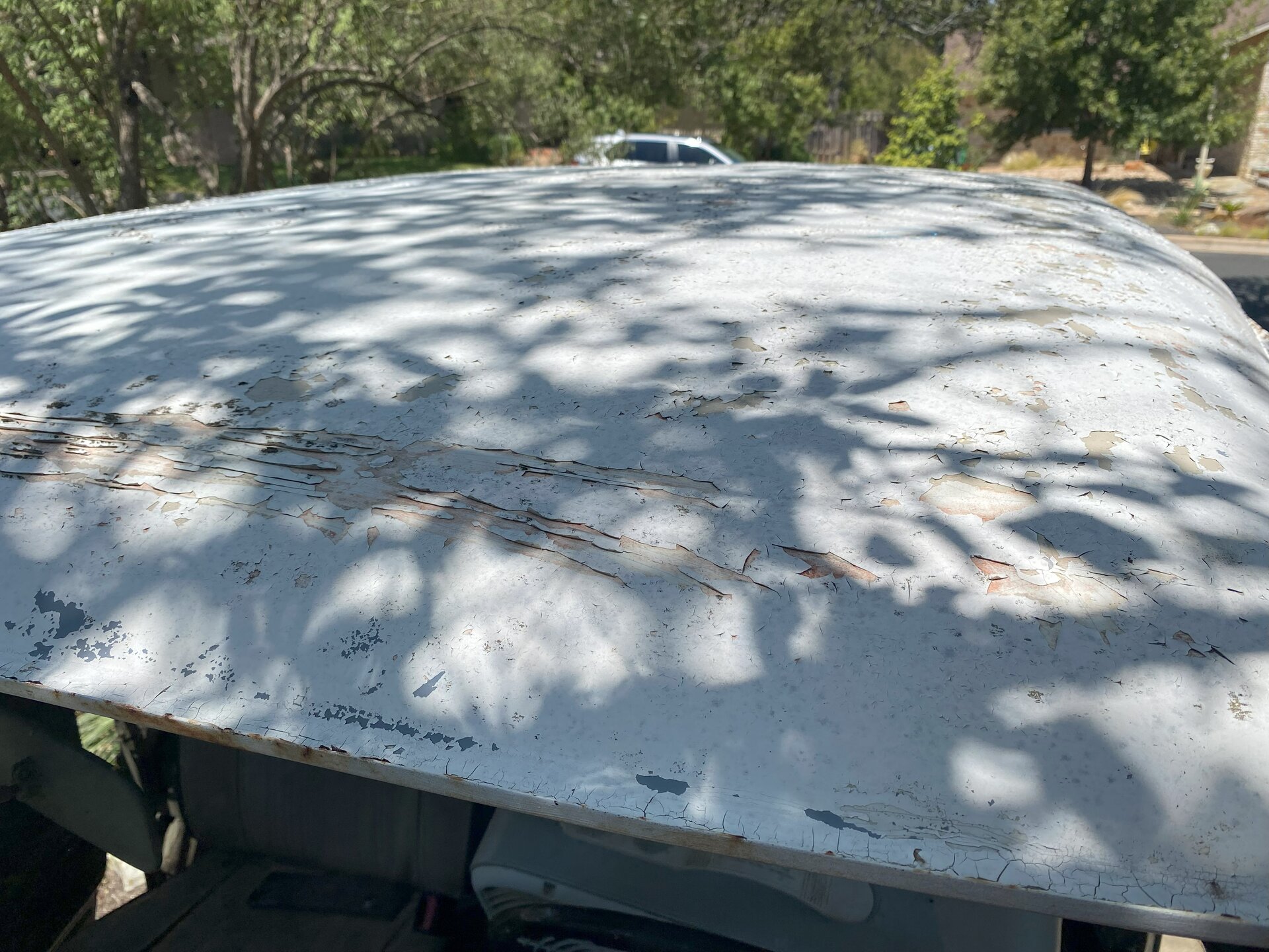

I want to take care of some of the initial condition issues. I removed all the moss and the roof is pealing but doesn't have any pin holes. I have seen plenty of "replacement" videos but I am wondering if I can sand it down and refinish the roof without removing it. I used to work on fiberglass boats and the top looks similar.
The engine is an F with some elements of the 2F. It needs a tune up and some carb work. The air filter connection at the carb is a janky rubber hose that fits into the air filter without any metal support. I need to look at more photos to see if there are parts missing.

My top was in similar (though not quite that bad) condition. I made sure the loose chips came off, filled (I believe an epoxy filler), sanded then covered in monstaliner (cygnus white version). Although not stock, looks quite good.

I have used this as an inexpensive coating for my fiberglass top, has lasted 14 yrs.
As a boat person you may be familiar. Easy to apply with roller and self leveling.
1 qt. was enough if memory serves
I was thinking about that. After sanding the top it's pretty rough, did you do a pass with fairing compound to smooth it out?
My top wasn't really pitted etc. I sanded smooth where needed and built up the paint in some spots. Its very forgiving, fills in semi-small to small scratches well.
