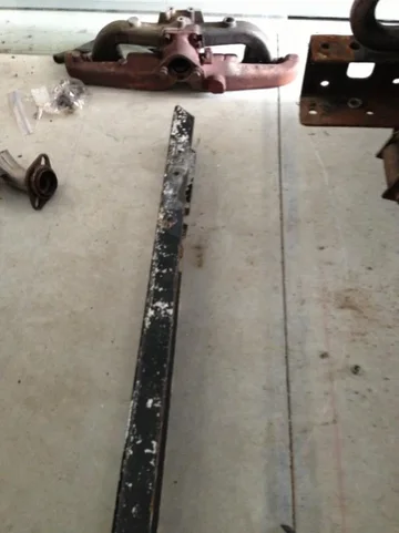

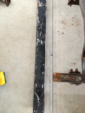

Question, folks.
I believe this to be an adapted piece of channel or a 40 front bumper, but assume nothing anymore.
just an angle iron bumper. common swap for the tin bumpers that were on the rigs. i'll be putting the same thing on bosshogs as soon as i can make it to the scrap yard
Is it worth it to you for me to send this one then?
I will, no problem.
I like the curves on the ends of the one that was on mine. Not sure if OE, but may build out of steel, since that's something I am capable of.

talk to bosshog, he'd probably swap you a stock 55 bumper for that. his aren't too bad, no worse than annie's bumper was and we straightened it in the vise with bfh

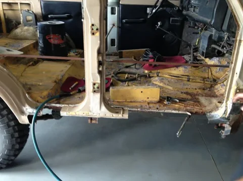

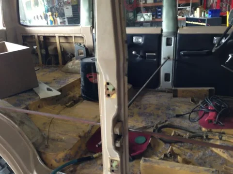

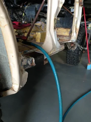

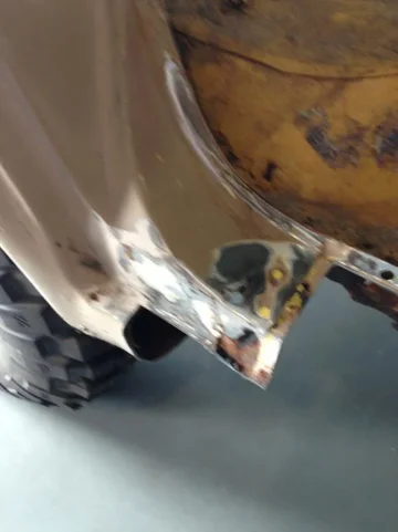

All that remained of the PS rocker.
She's rusty.
My vote is to section in new material, but only an effort to save a good shell on the parts Pig. Britt wants to cut this corner and possibly the PS inner rear fender (the "only rust" according to PO) and use.
Am I being to sentimental on keeping the parts Pig shell whole?
That is what it's for, but it'll be useless after.....
Same here. He's like to to section off this entire corner from the donor Pig, but it doesn't appear that much to patch in, essentially achieving the same thing.,..I think.....
Not questioning the pro as he said it was my choice, so asking opinions.
Feel bad cutting the other shell up, since its in good condition.

Just my opinion, but I think you will find the donor's metal just as rusty or a year or two behind your's.
I'd try to use new metal where ever I could.
I agree with new metal, Ron, and the course that's been decided, for the reason that it's patch able in these locations and I'd hate to chop the bottom off the donor shell, rendering the rest almost useless.
