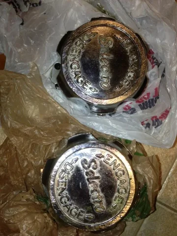

Thanks to a thread I saw on these in the 40 section, it took me longer to get the bolts out and the snap ring off than to pull the covers!
Chris, I'd grease btwn the lock-out mechanism and the over to aid in future dis-assembly. These came from New Mexico, so pretty clean.

good looking hub.
good looking hub.
They're kick ass in my opinion.
Thank you for suggesting and thanks to PabloCruiser for parting with.
Once they were recommended, I'd decided it was either these, or drive flanges, even though these are later and I already had sourced Selectro's.
I'm stoked about the ASCOs, to say the least.
Thanks again for going to the trouble to pull them.
Can't wait until the point when they're being installed.
After my crap ass day with the 80, killer news.

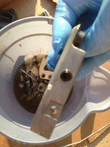

Top all that off with failed attempts at paint removal
Soaking in a stripper bath (ahhh) now and it's not doing.
Wire wheel digs into way too much. Even a wire brush ate into one.
Don't know if removing these pins
Is a good idea, and the rubbers are aged to a point that one tore when trying to remove.
I "think" these should be bare, but have no way of knowing, so don't know really what to do to return then to.
Already battling pins on the hinges, so not really wanting to disassemble and attempt to replace, unless that's half assing it. Call me out, if so.

On this, trying to remove paint without have to remove the pin that holds the spring captive, nor the rubber piece in the back of the hasp.
I have a total of three full sets of these, so hoping to get one good cleaned zinc one for body shop to get doors aligned with, along with hinges that will be out of the bead blasters tomorrow.
Electrolytic rust removal .... fast, cheap, and easy ;-) Otherwise pay the blaster ...
Tucker
He said it'd tear into the zinc plating, and reason for attempting to do it this way.
If it boils down to disassembling, blasting, replating, I'm good with that, since we can use one set to align with.
Not sure about sourcing the rubber pieces and I can't see how I can remove in one piece.
