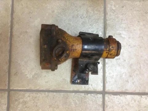

Have an OE jack....
Have had partial jack tools, just didn't realize....
Have since added the hand crank from camotubebender (not actual pic of. Stole from Mud)
So, two questions.
Is the missing tool on the seat the hand cranks location?
I think I know the answer to this, but I think too much.
Would a yellow jack and black tools be correct, as I suspect?
Or is it all yellow?
Hoping to blast and coat correct.
Just realized I'm still missing the jack handle.....always something.

So, two questions.
yes, the three clips under seat are for hand crank.
my jack tools have always been yellow, all my cranks have been black

First, is "yellow" yellow or is there a color code?
Spent an hour at paint store earlier with "T1434" and have no way of knowing if it's 100% match.
Second, where does this "hand crank" store?
i have seen black jacks, yellow jacks and brown jacks ... i do believe your vintage is yellow, kind of a off yellow, more of a mustard than bright yellow ...
Yeah, I feel pretty stupid after seeing the pic. Was trying to visualize the jack hand crank in there, too.
Thanks again.

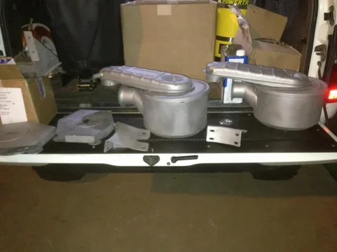

Few things back from blaster.
Only a little straightening on the shroud. Can't see and pin holes and edges all appear in good shape.
Few small spots on the filter housings, but otherwise in good shape. Hoping to tack them in the morning, then shoot a cheap primer on both of them, both brackets, and the shroud, just to prevent surface corrosion for the duration it's stored.
Hope to complete the heater housings tomorrow.
Etching primer then paint.

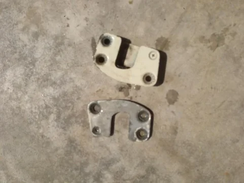

I believe these should be bare zinc plated.
I can't seem to find a pin to separate, have soaked and scrubbed in Sinple Green, to no avail, can't blast without possibly destroying zinc, and since zinc is, I think, final finish, see no point in replacing.
Going to marinate in mineral spirits and hope that doesn't harm the plastic/rubber components.
If it does, any replacements?
