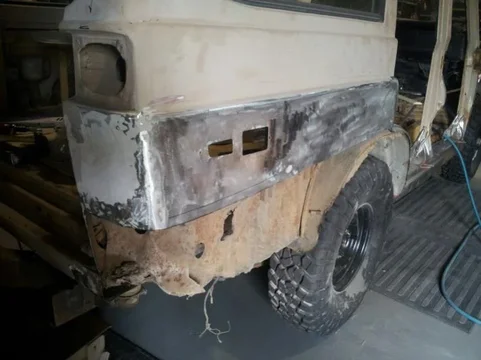

Fender doesn't look like it has the cut out for running light? Did you find one of each side?
Both sides.
I'll cut a hole. Much easier than patching one. Haha.

A little progress. I'm thinking that the Pig is taking third or fourth billing in the lineup of projects, which is fine considering the shop rate, but hoping it'll get this week's undivided attention.
I have been concerned about chopping into the parts Pig, since grand delusions of a topped, bobbed, caged wheeler have been dancing in my head, but Britt's wanting to take another look, so maybe carving pork off it soon.
