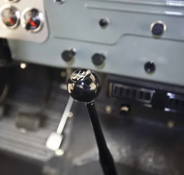

I also ended up finding a gear shift knob for the transmission. The one that came with the H55 is a more modern looking rubberized knob, and didn't really fit with the rest of the interior. After a lot of searching, I found a shifter knob that has the correct 5 speed pattern engraved, AND has the correct metric threads for the H55 stick. Ordered it on Wednesday, and arrived today. Very happy with it, and it's on.

I like your shifter knob. Good choice. I went to the website to take a look (not that I need one) and then realized that I just couldn't remember what my shift pattern was. And I have been shifting it for 12 years at least. It's weird how the mind (fails to) work(s).

I did debate on whether or not to have a shift pattern engraved on mine...I guess it's more for looks than for me. It's funny how muscle memory works, you probably had to sit in the seat and shift through the gears while thinking about it to figure out what your shift pattern was. I'm still trying to develop the muscle memory for the 5 speed. Last time I shifted a 5 speed H55 was in an RHD with my left hand, so have some learning to do.:)

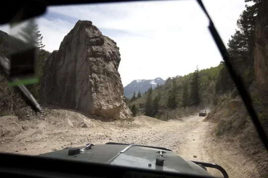

OK, so I've done 3-4 hours of driving every day over the weekend. It's been mainly pavement, with a few tame gravel roads here and there. Today, I decided it was time for a proving run to test the off-road capabilities of the 45. I also wanted to see if there were any weak links that wouldn't show on highway driving, as well as put some articulation into the suspension and body, and see if anything loosened up.
The :princess: and I went up to the mountains nearby, and got into some steep, narrow and rocky roads. No serious wheeling, but it was steep and loose, necessitating a bit of low range and 4wd.

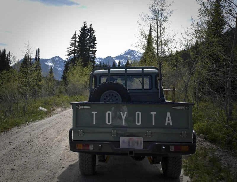

Had a blast today, probably won't take her out on roads that rough every weekend, but with exception of overheating, she made it through unscathed. She's got great manners for off the pavement, as a cruiser should. I think we are ready to see the world at 20mph (or less)! I even was chat up some cool people on the trail, they outweighed the a** hats compensating for small appendages by driving like idiots in their jacked up rigs...
