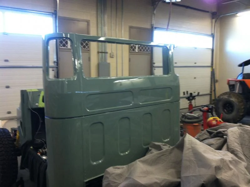

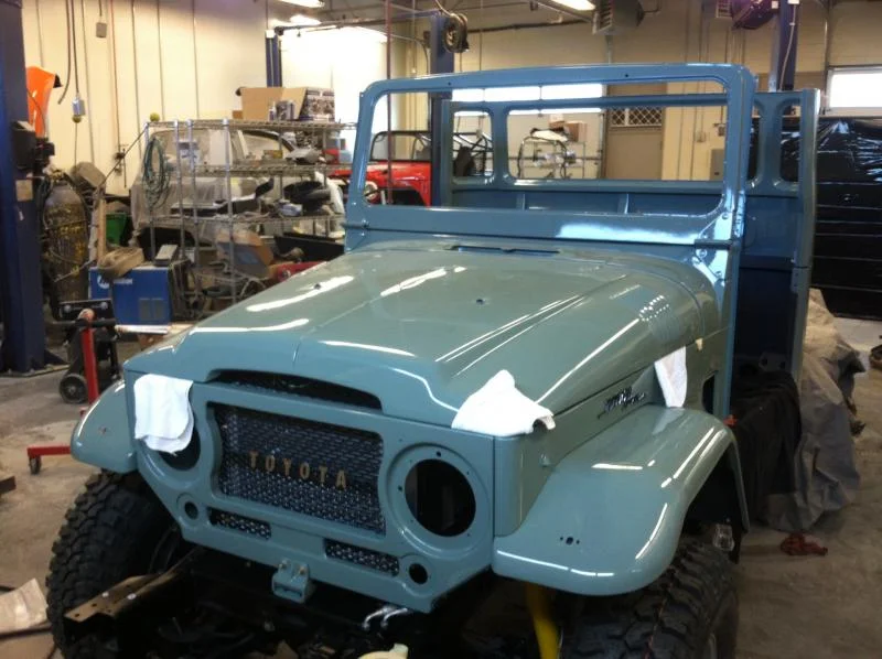

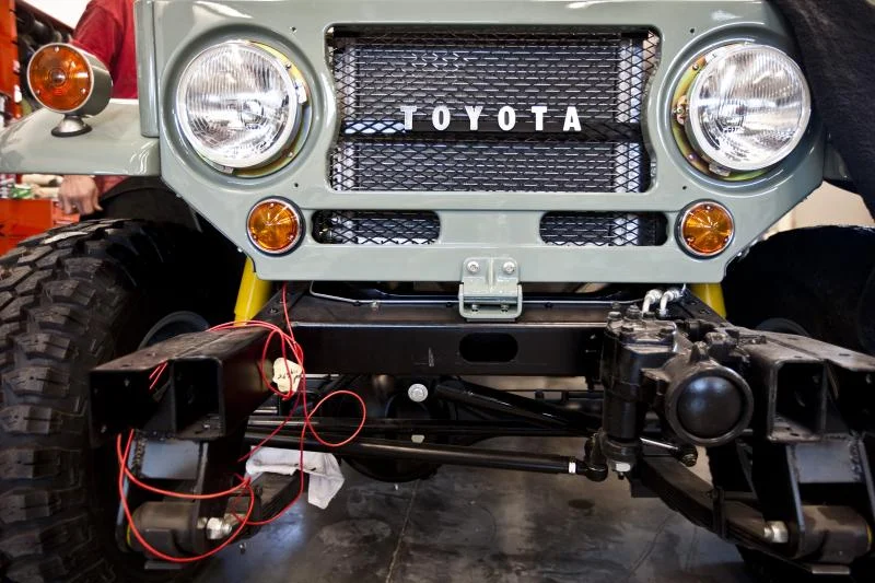

Top getting put on:

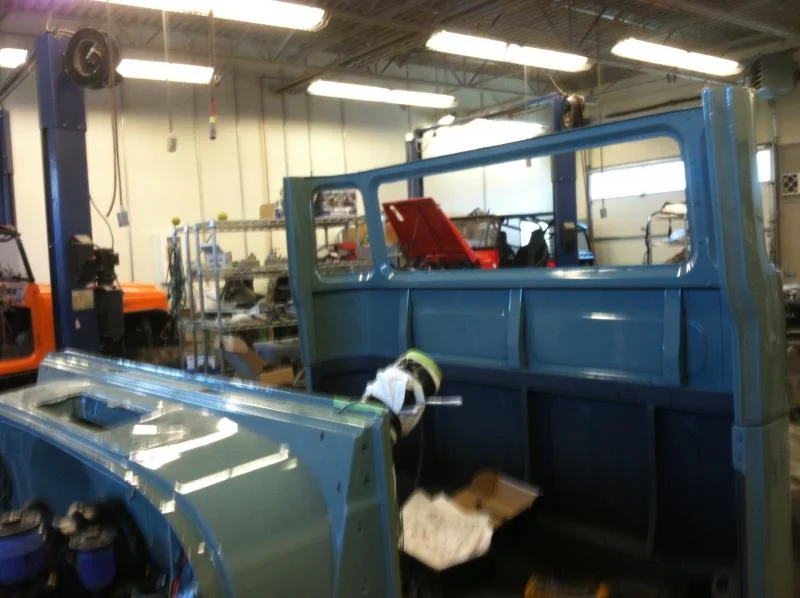

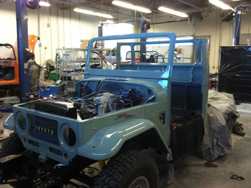

Windshield frame, fenders, bib and sides:

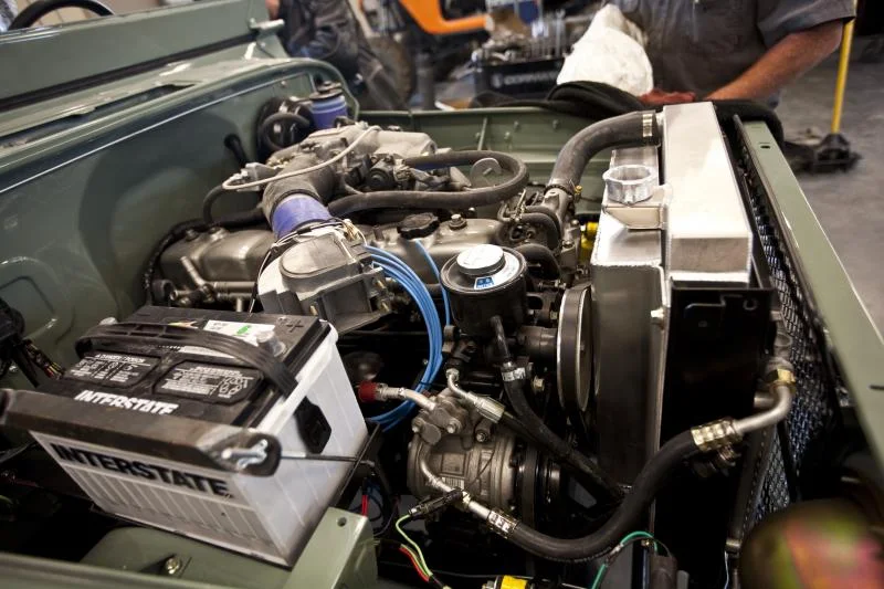

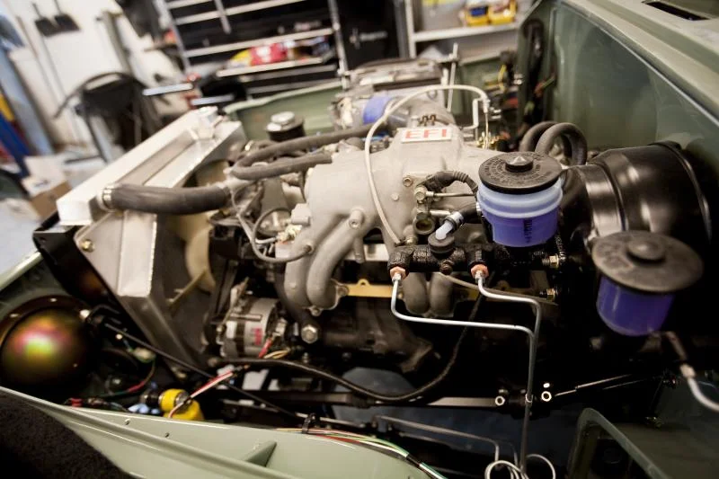

  • Other than connecting wires to devices, the wiring is complete.
  • Engine and mechanical systems are complete with exceptions of a custom airbox needs to be installed for the intake. Battery and ARB location pretty much nixed the stock intake.

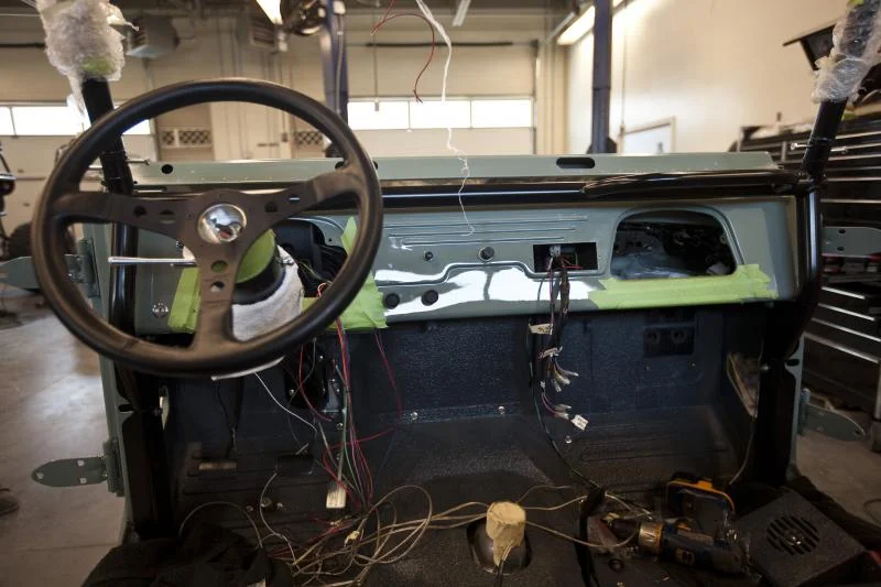

I went to the shop today and got some pictures. The guys were in the middle of doing their thing, so no poser shots, just pictures of work in progress.

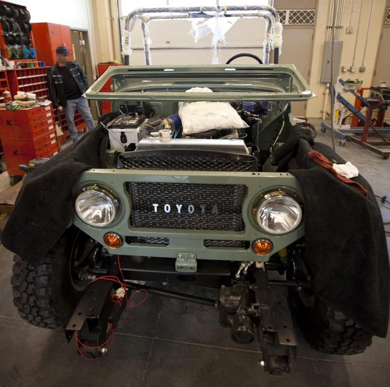

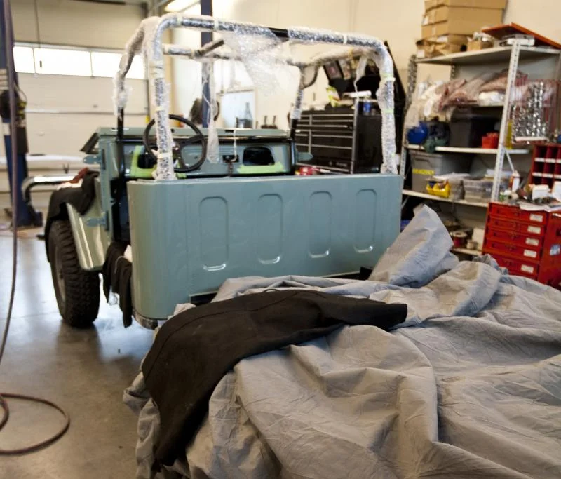

The roll cage is nicely bubble wrapped:
Dash is looking good. I had to sacrifice the ability to drop the windshield due to the roll cage dash bar blocking the latches.

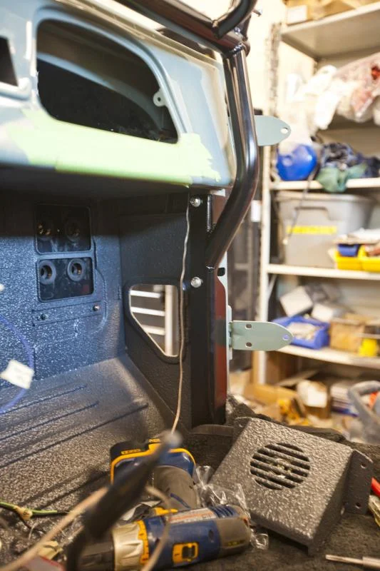

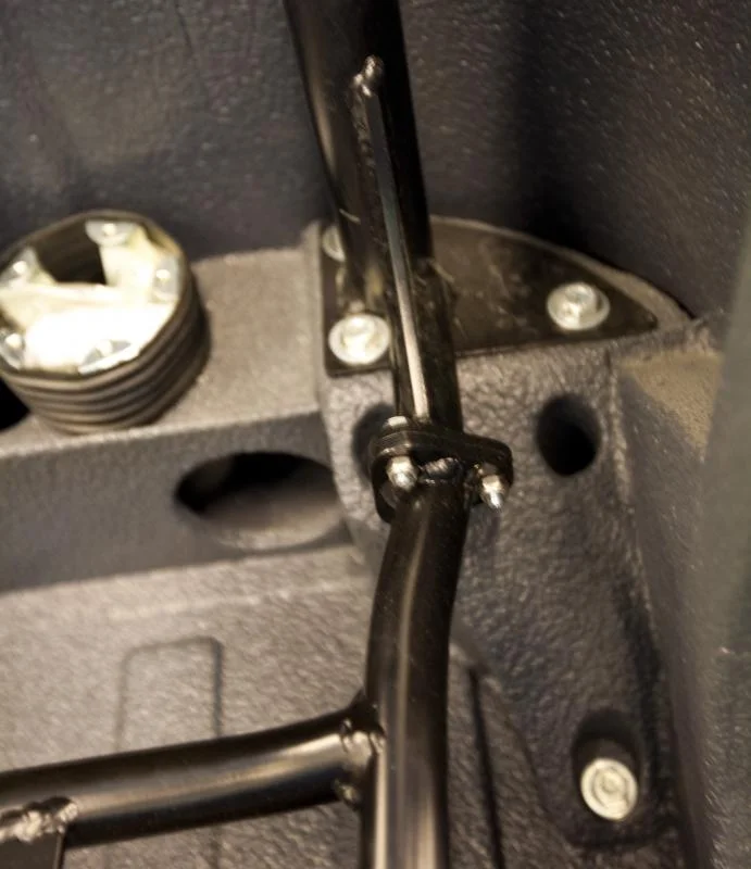

Detail of the A pillar roll cage leg. I like the design, bolts to the door frame to avoid the inevitable sore knee that a tube would yield. There is a foot at the bottom of the roll cage leg, again, goes to a frame tie. Note the speaker box on the floor. It will mount just above the kick vent.
Detail of the B pillar mount.

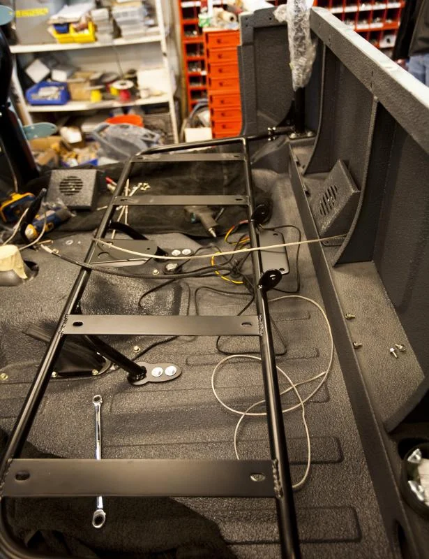

And the seat frame.
