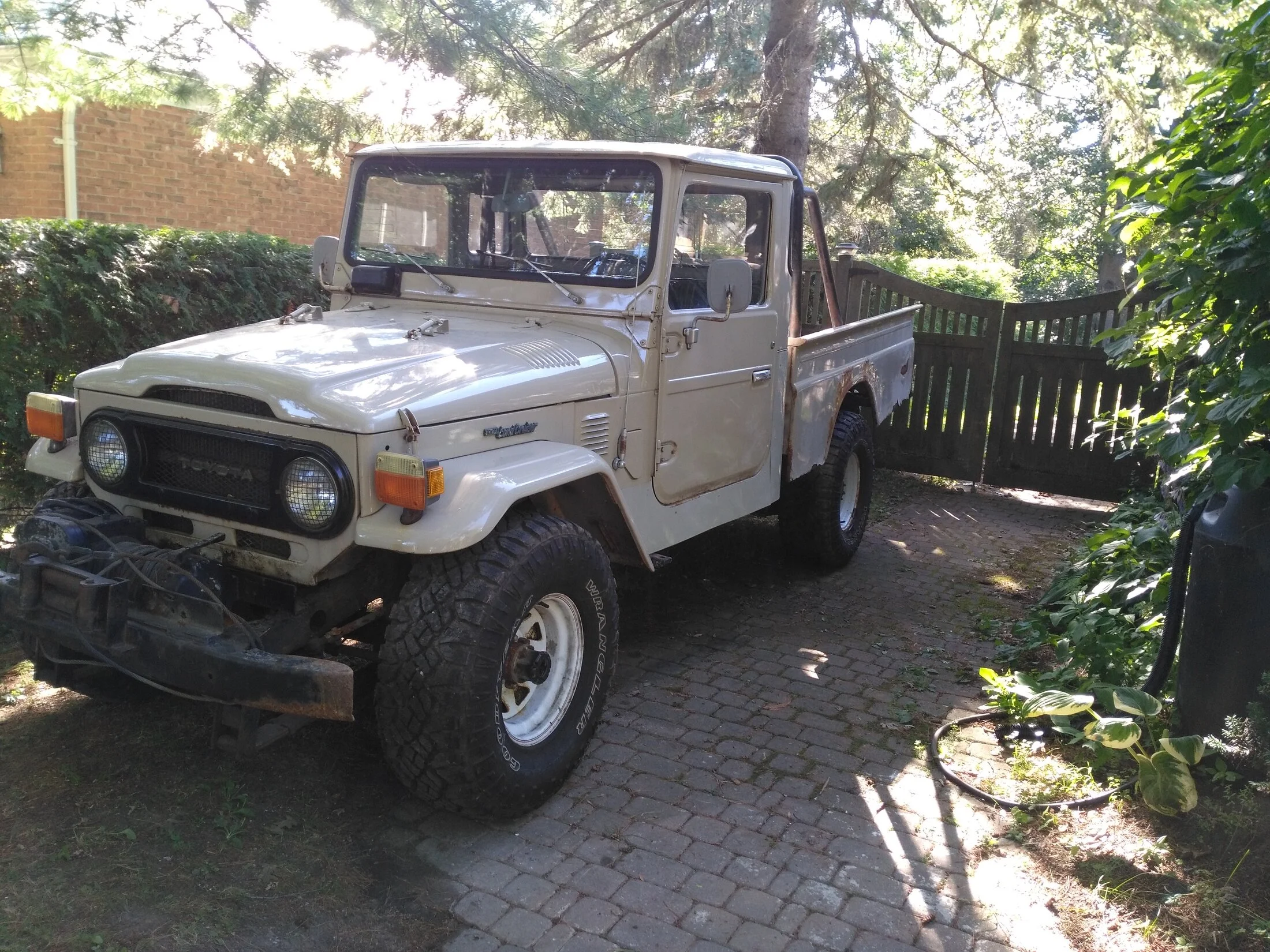

Camping in Ontario after body work had been done. Hooks are gone, but otherwise doesn't look bad to the unexperienced eye.

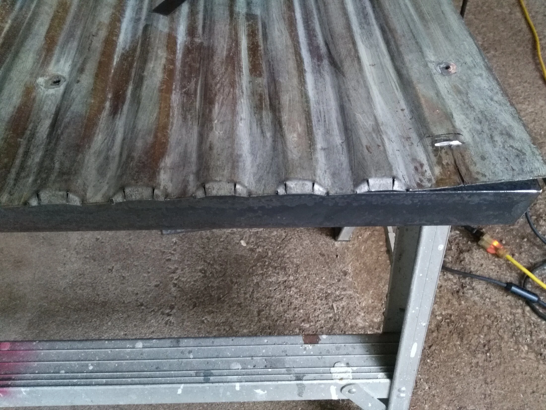

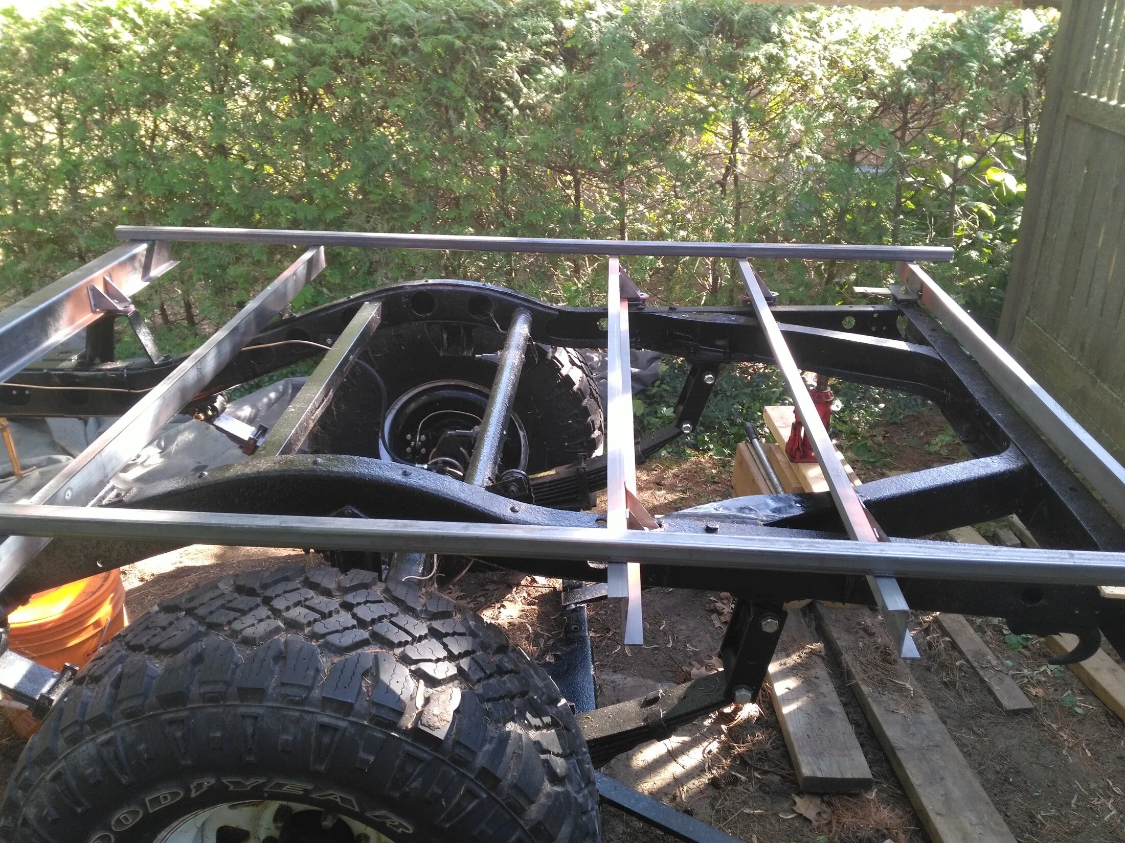

I ordered new steel sections for the bed floor and cross rails from a local metal shop. I sent them drawings and specs and they did a fairly good job, although the floor sections did not turn out as consistent and flat as I had hoped for. I decided to go with two full pieces joined in the middle and then I would cut out for the wheel humps, once I figured out what I was going to do for them.
Note: the two extra wide rails at the back are the wrong size, I had to take them back and get them done again.

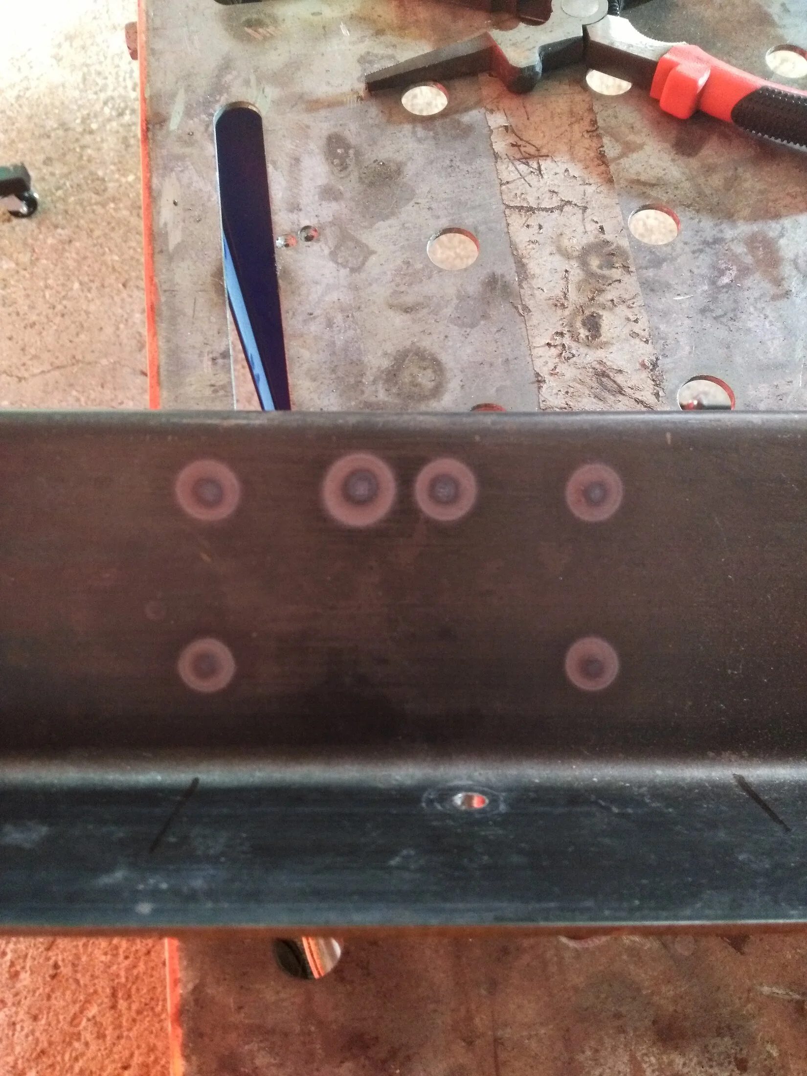

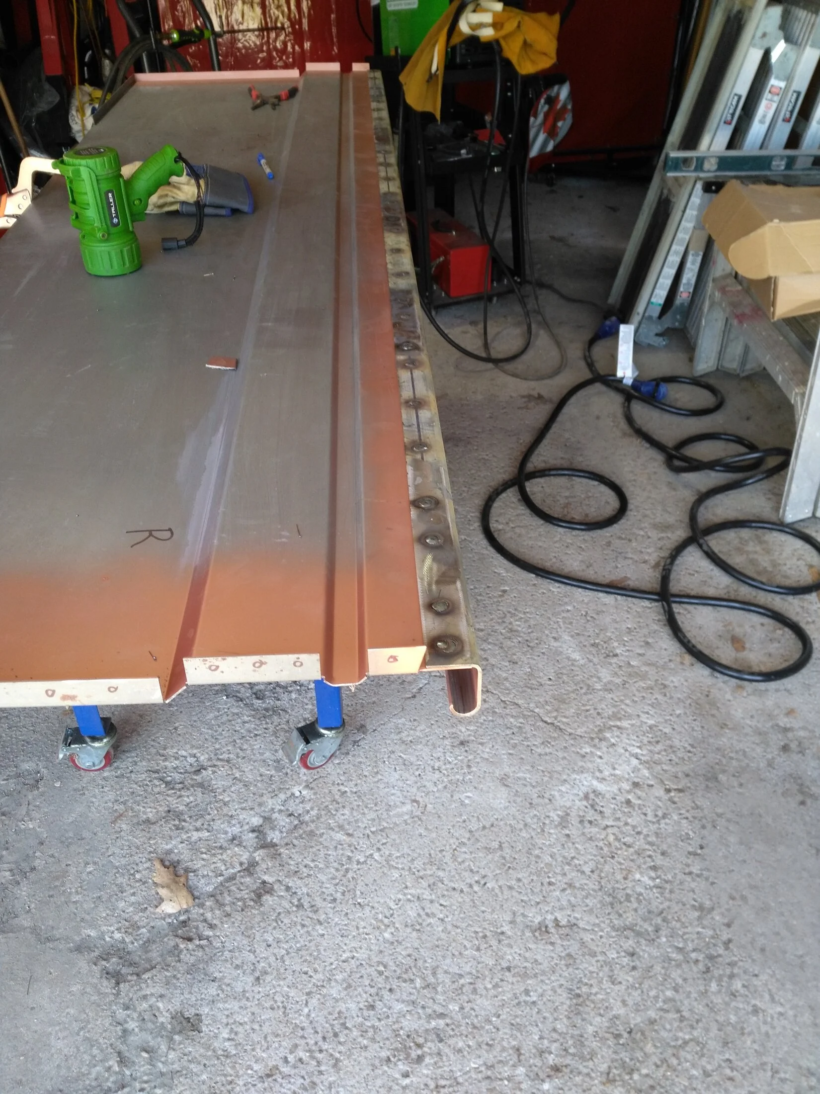

I've never welded before, so I took a short introductory evening course that was mostly about stick welding, and bought a welder lol.

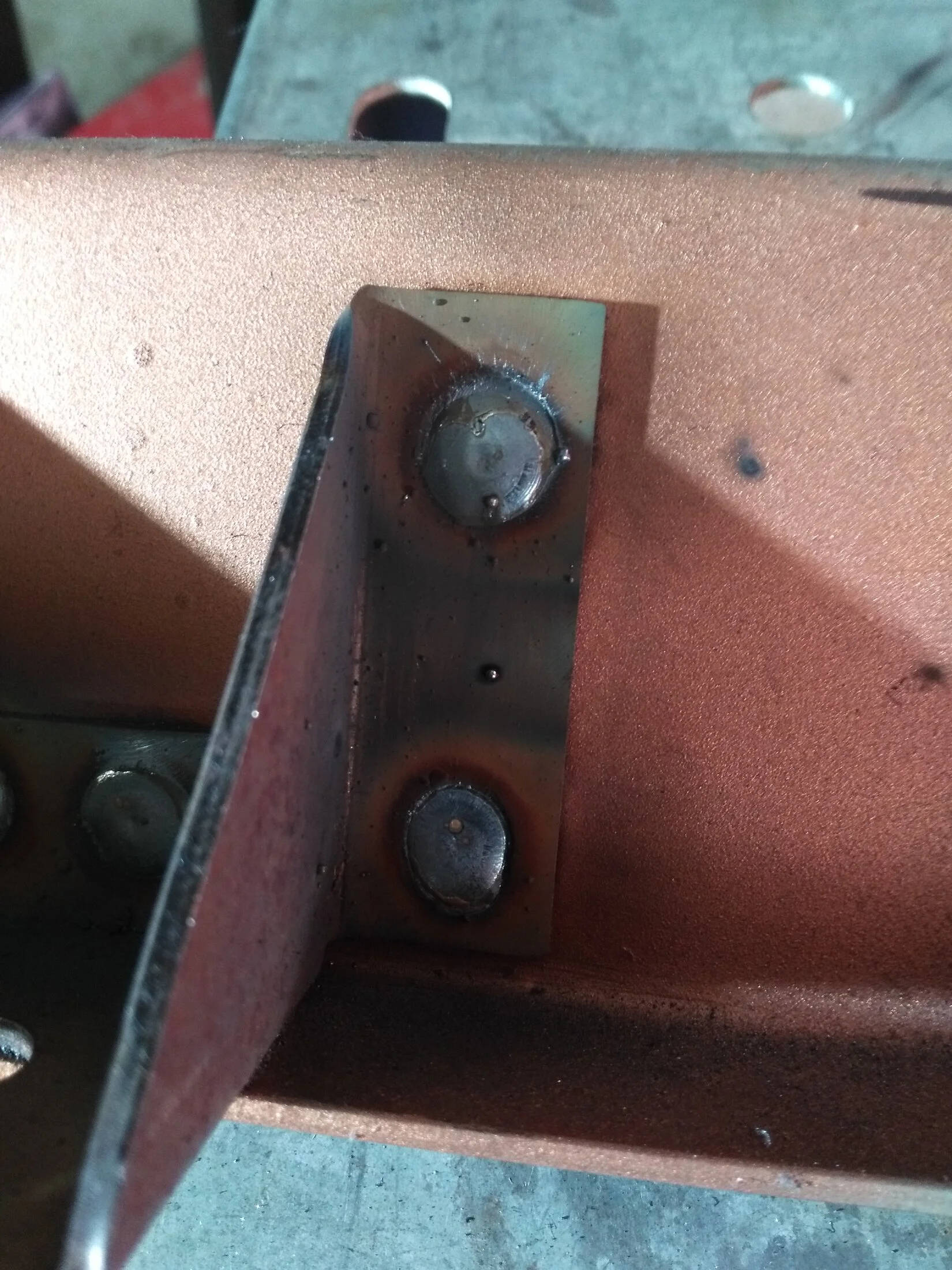

The local body guy that did some of the blasting and priming for me recommended using UPOL copper weld through primer. I tried a different brand of copper primer that was cheaper, but after a couple of test welds I quickly went out and bought the UPOL brand.

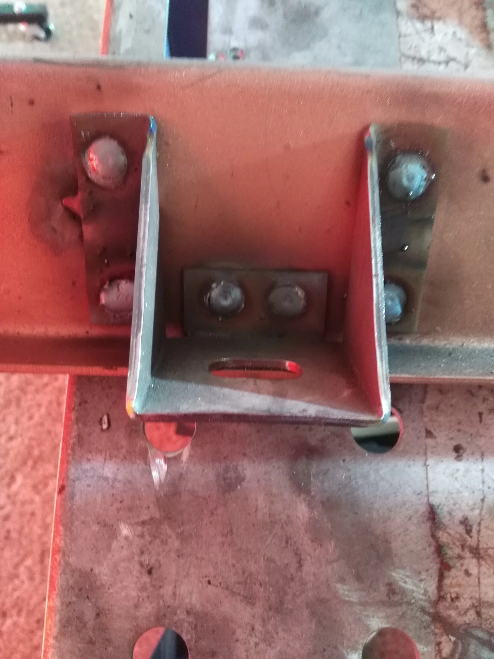

Mounts welded on cross rails:

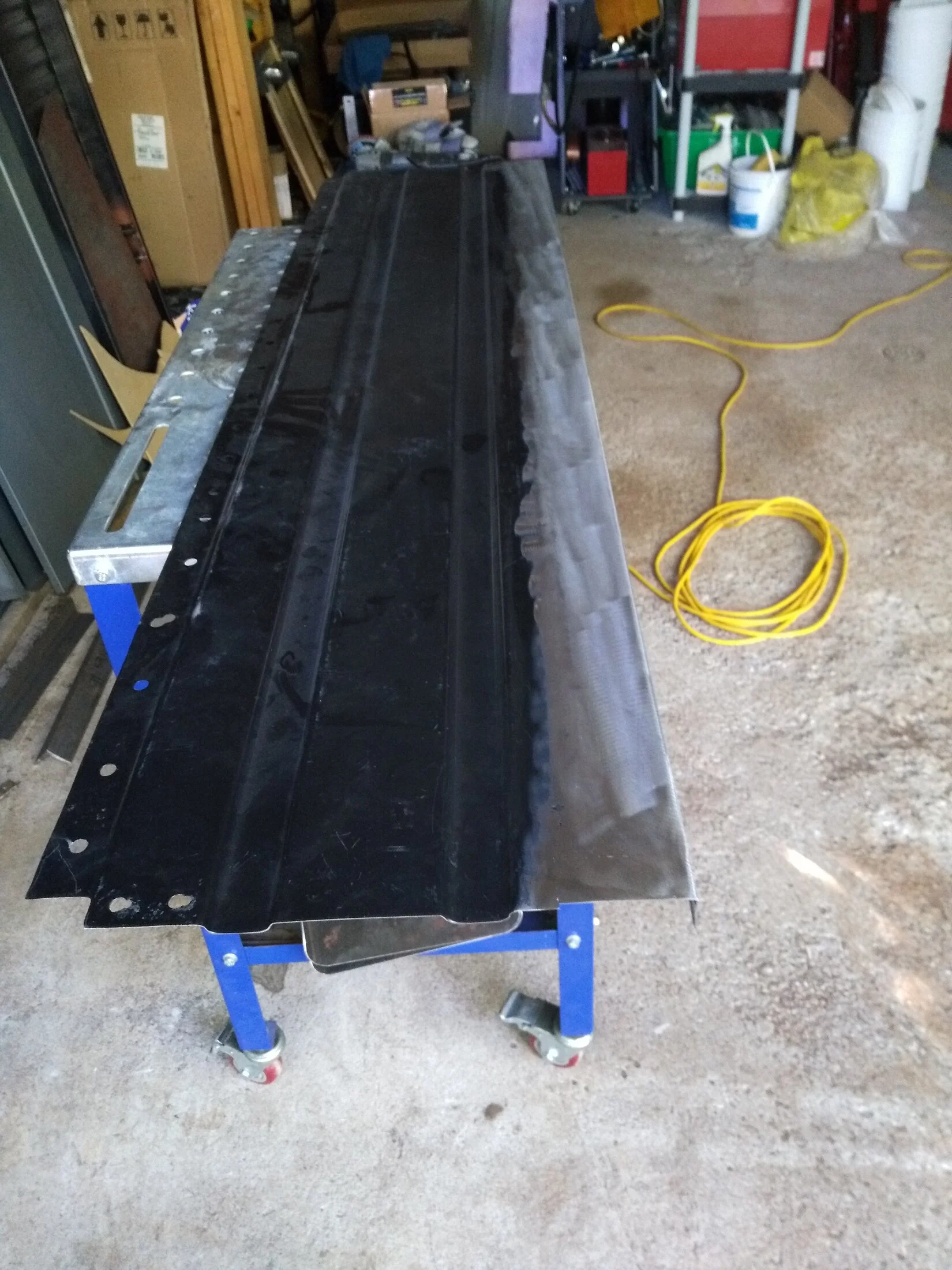

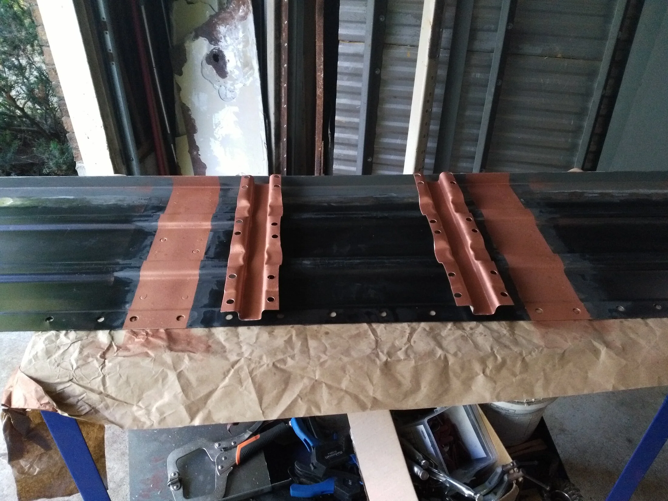

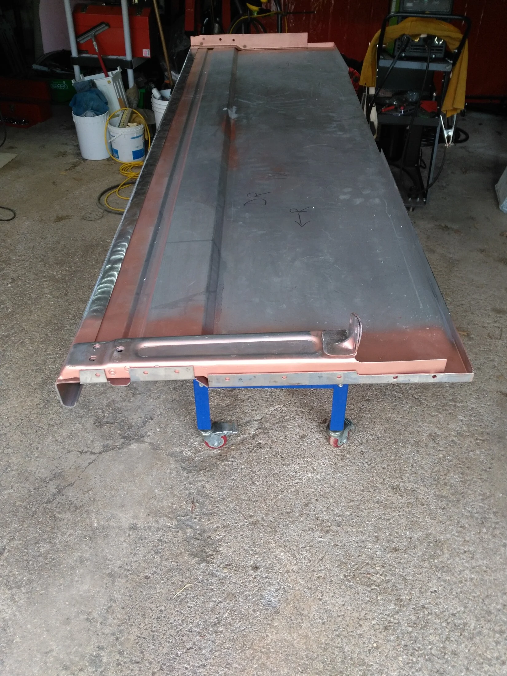

I took the front wall apart and sent it out for blasting and priming.
It wasn't in too bad a shape except for the bottom flange where it attaches to the floor, so I welded in a new section.
Cleaned up stiffeners and welded back on.

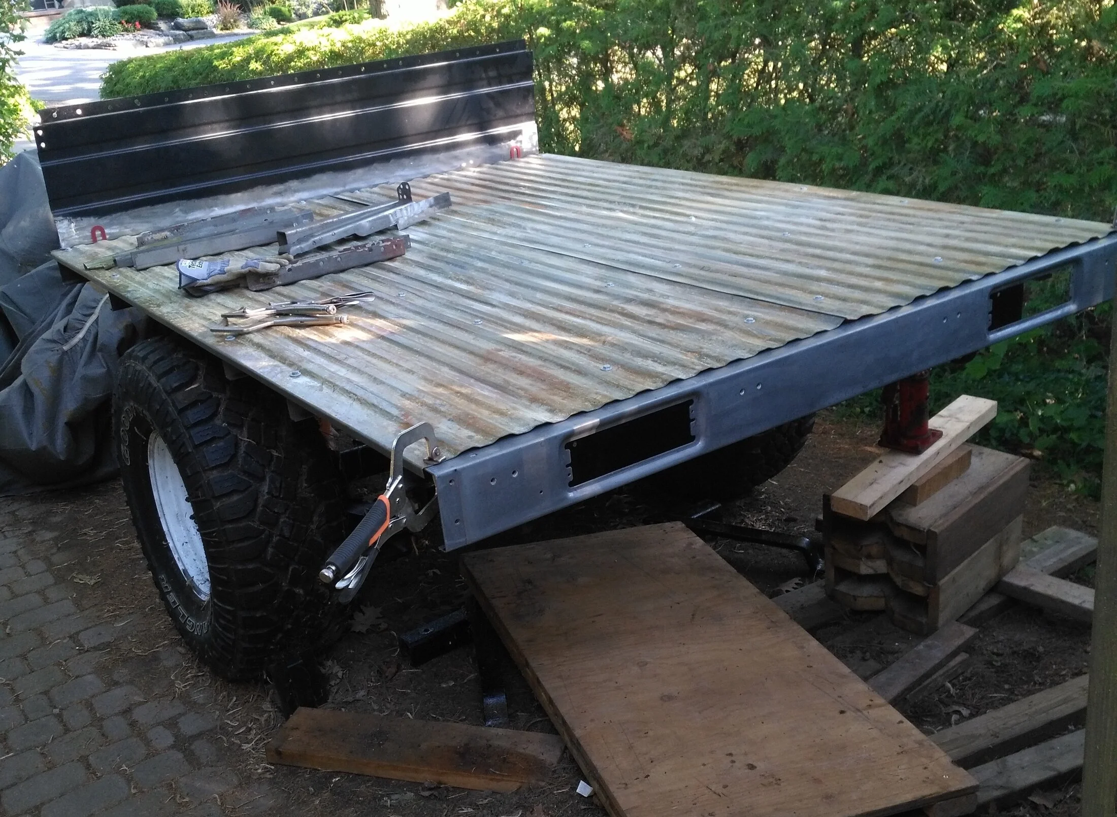

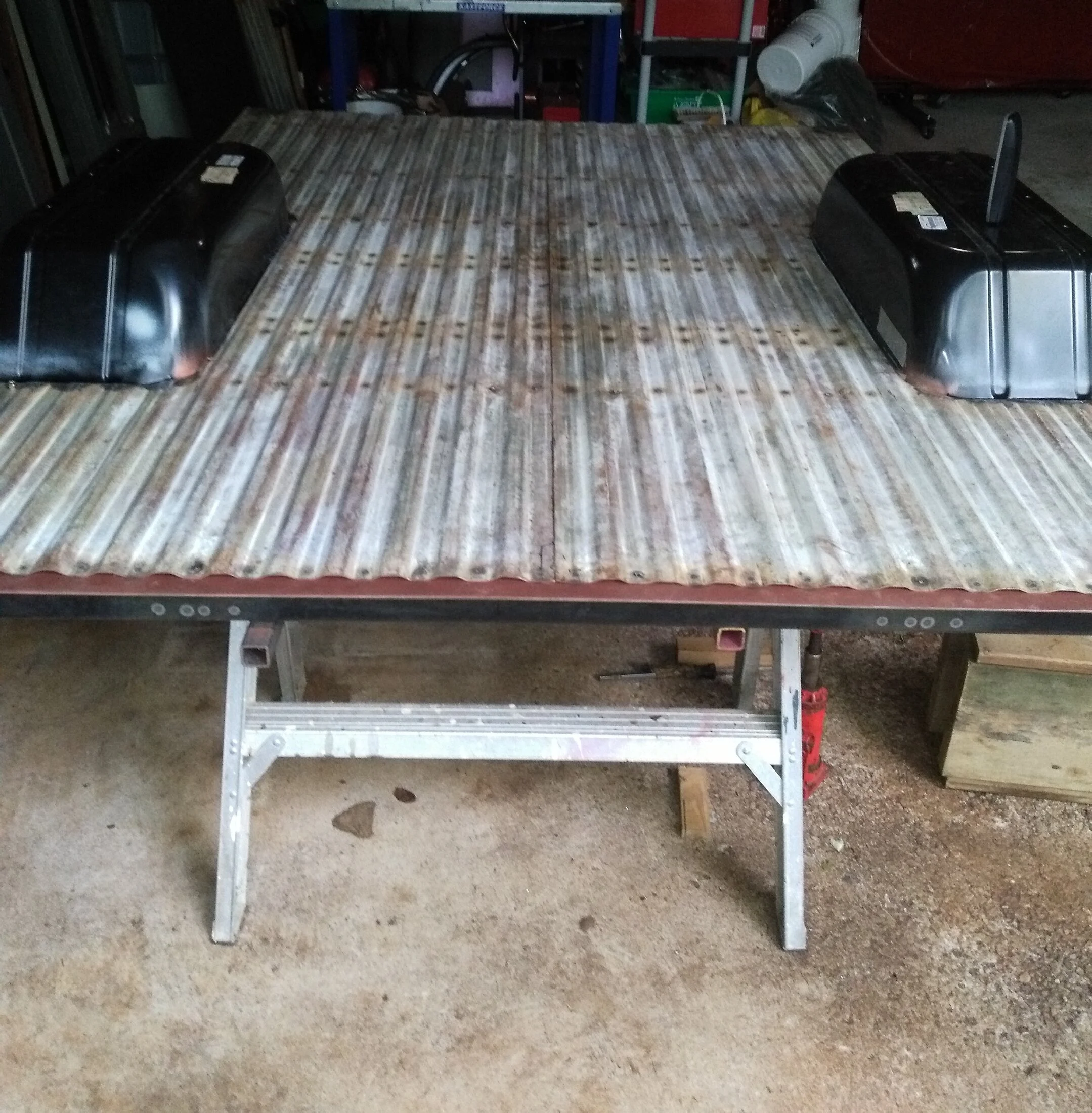

Test fit of new floor sections, front wall and rear sill on frame. Hard to believe that those floor sections are new steel - surface rusted just from the humidity in Ontario.
Love the rear sill (thanks @Awl_TEQ ) :)

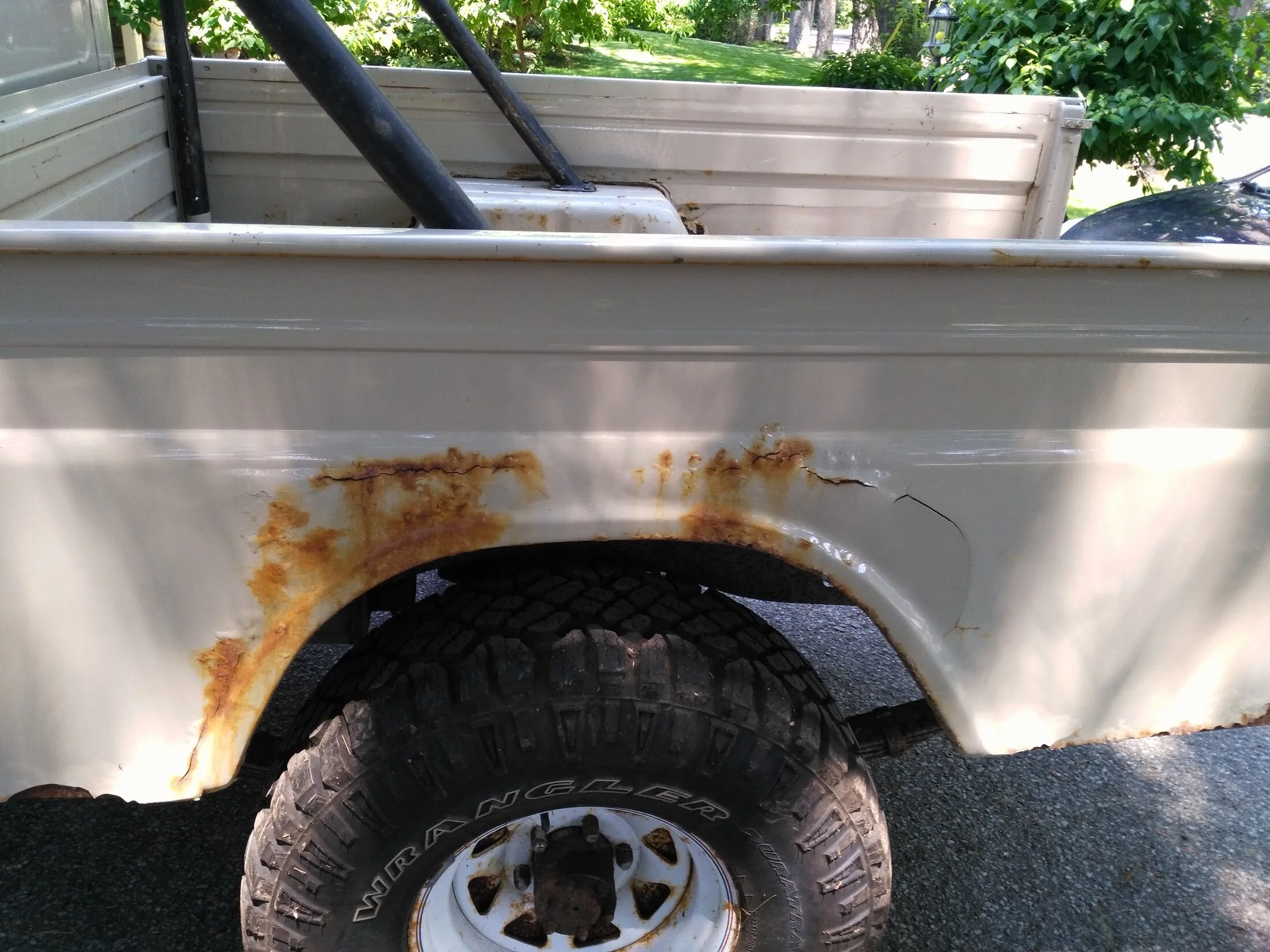

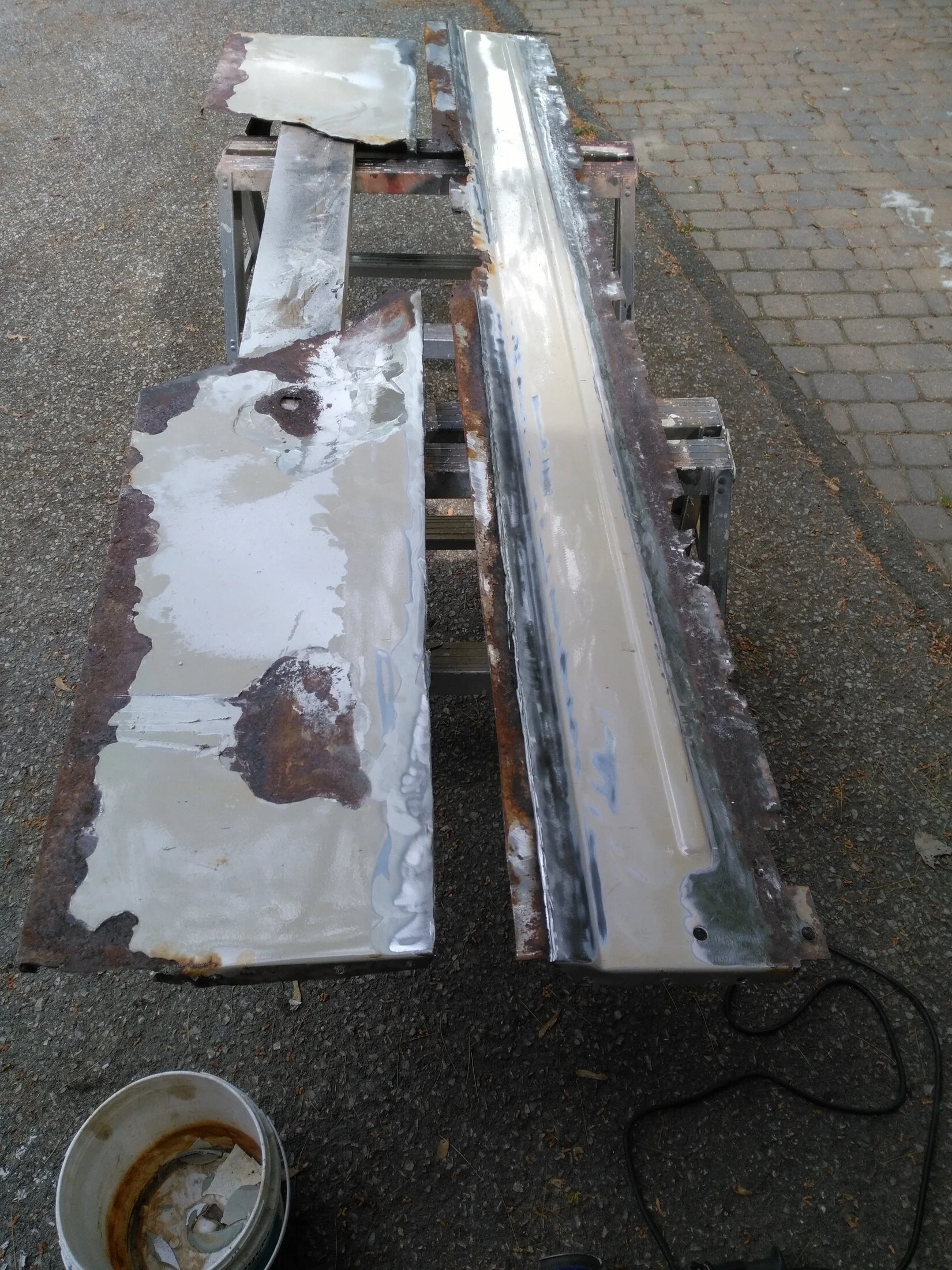

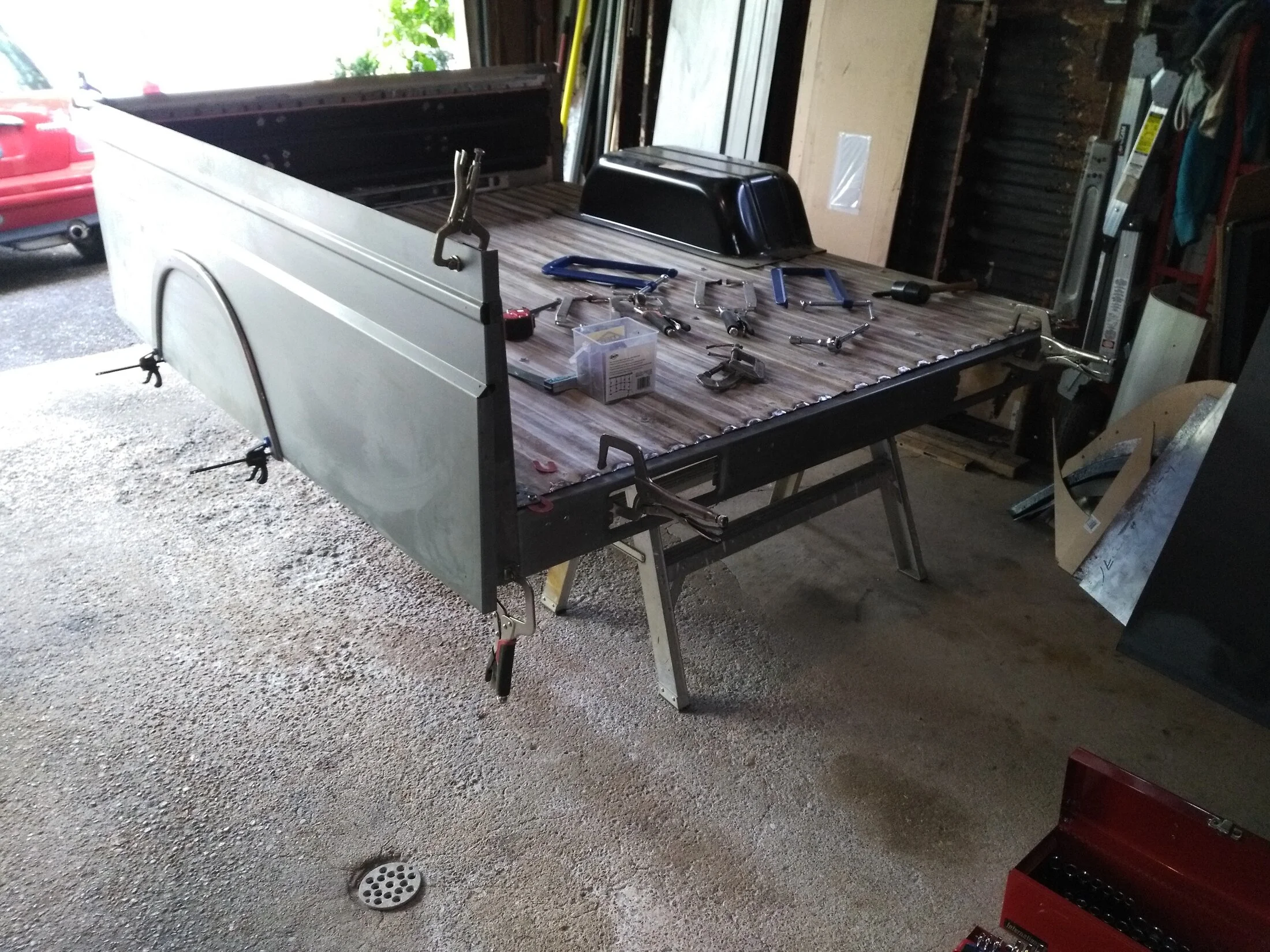

The next step was to take the sides of the box apart and see just what was hiding under the swollen filler.
It appears that the ‘body guy’ cut the sides just below the curved hip and lap welded on what may or may not have been new metal, and then lathered on the filler – to about 3/8” depth in some places – to recreate the shape.
Unfortunately, moisture got to the metal under the filler and started to quietly rust until it bubbled and cracked through the filler.
Again, my fault for not dealing with it sooner, but I didn’t think I was going to have to worry about the box again, and by the time I was able to devote some time to it, it was too late.
I contemplated joining a new piece of metal to the original top half, but the wheel arches were shot and the tops of the original pieces were also in rough shape. And I didn’t really have the skills to attempt that kind of body work, so I decided to replace the sides with new sheet metal.
So the hunt was on to find a shop that would bend up the sides and top rails. I created dxf files in a free version of Draftsight and after approaching numerous shops (most were either too big or too small) I finally found one that would do everything, except the curved ‘hip’ in the side would be straight bends instead of curved.
I had to wait a while before the shop would do it, but they did an amazing job.
Now I needed wheel arches and inner fenders.

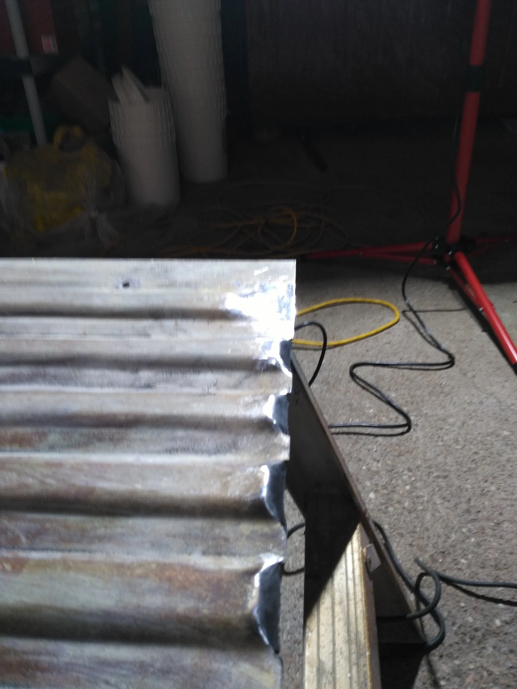

I struggled for some time to try and figure out what to do for the wheel arches, and then found the solution on YouTube on a program called Make it Kustom. He put out a couple of videos on how to hammer form shapes. I also found a couple of threads on this forum that showed the same thing and decided to give it a try.
They’re not perfect, but I think they will do, and they’re brand new 18ga steel.
I first attempted to make them with 16ga steel on a wood form, and that was a disaster. So I made a form out of steel round bar and used 18ga steel and it worked like a charm.

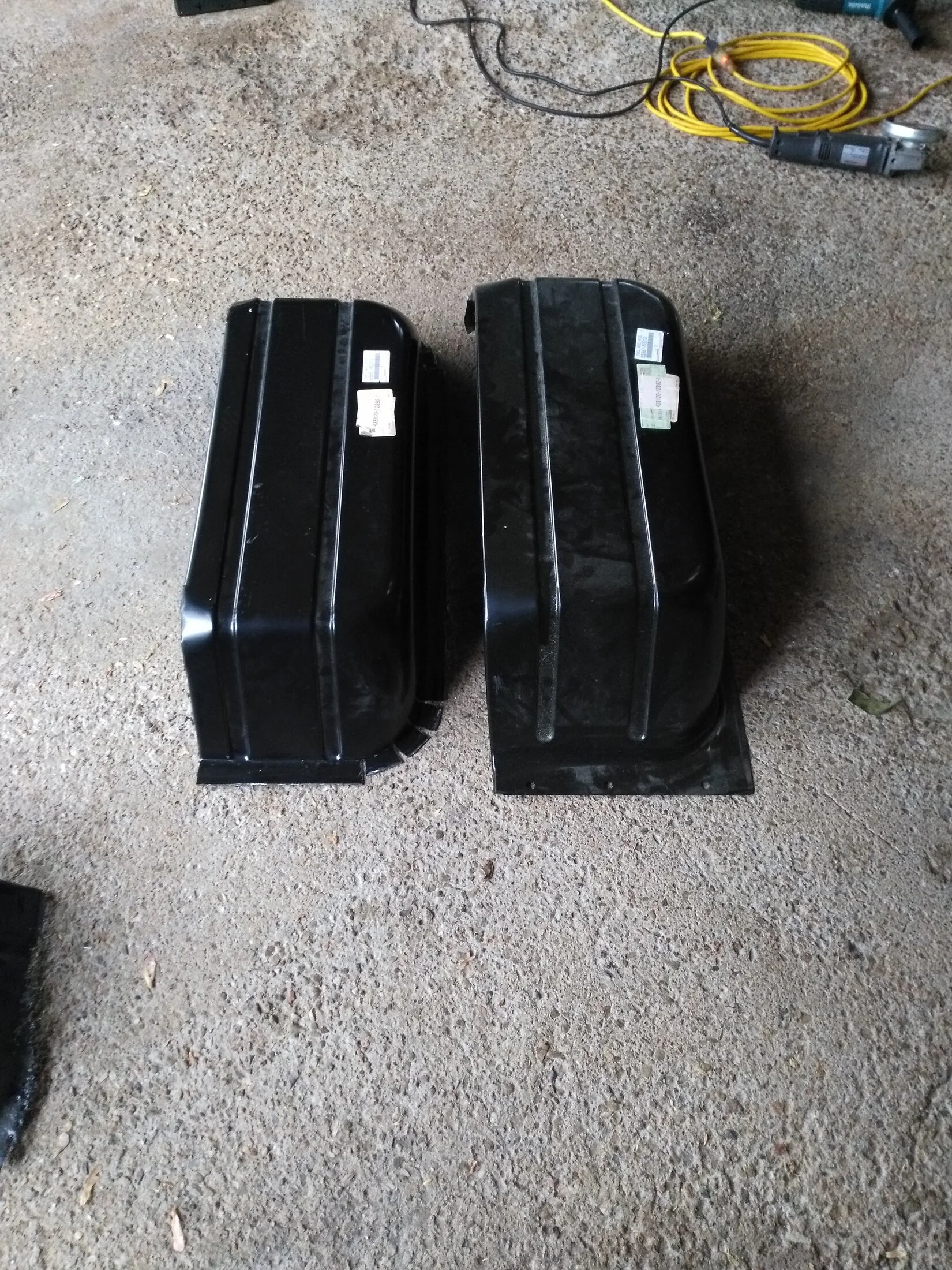

The inner fenders were in really rough shape, particularly around the mating edges.
I ordered a pair from Japan, and thought I had lucked into the right part for my truck, but as it turned out, they were the same part number but for a later year(?) as they were larger. But they were only $12 each plus shipping, so...score.
I decided to try and cut down the larger fenders and make them fit. Again, they’re not pretty, but they’ll work, and they’re new steel.
New and old.
New cut down to fit.
Many plug welds later, the cross rails are welded to the floor and the inner fenders are in. Still have to clean up the middle seam.
