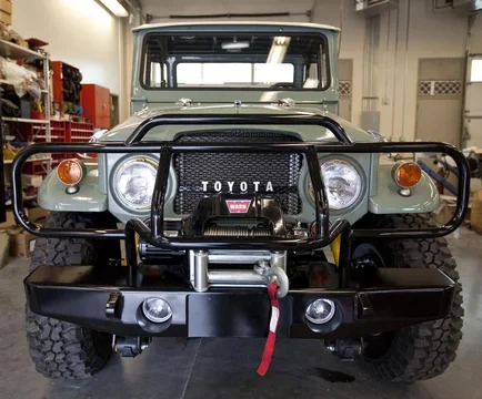

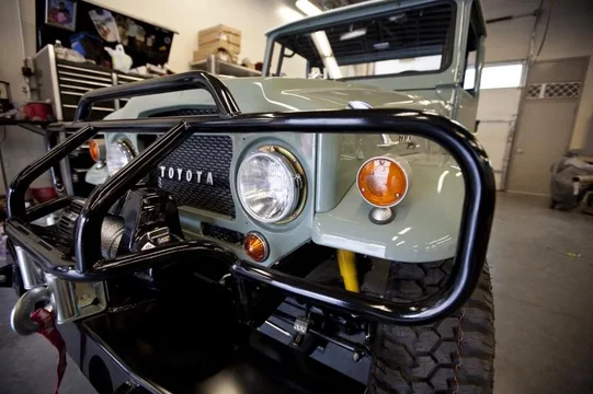

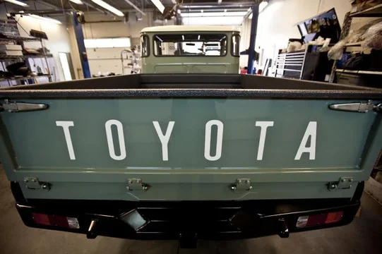

She's nearly done. A few items remain:
  • Bezel needs installed
  • Mirrors need installed
  • Headache rack (plus spare tire and jack mount) need installed
  • Door windows need to be cut and installed, along with gaskets and weatherstripping
  • Running boards need installed (this will be done very last, so I am the one that will scratch them...)
  • Horn button needs installed on the steering wheel
  • Air conditioning unit needs a few finishing touches
  • Shifter boots need installed
  • Diffs need broken in
  • Needs about 500miles put on it for a shakedown.
I am extremely happy with everything. It looks great. I did get to start the engine up, sounds great.

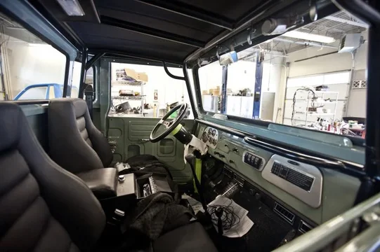

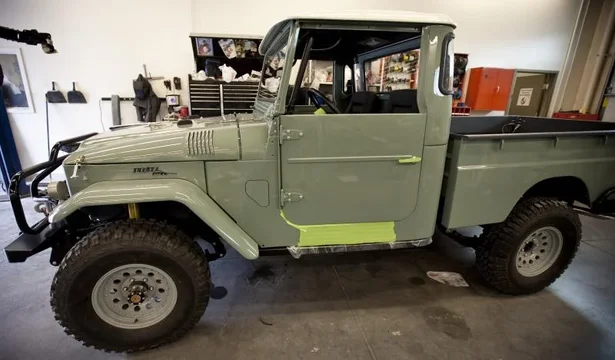

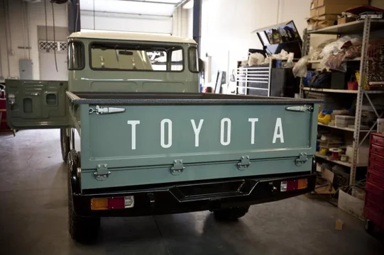

A few pictures of the nearly finished product, next time I see it, everything will be done.

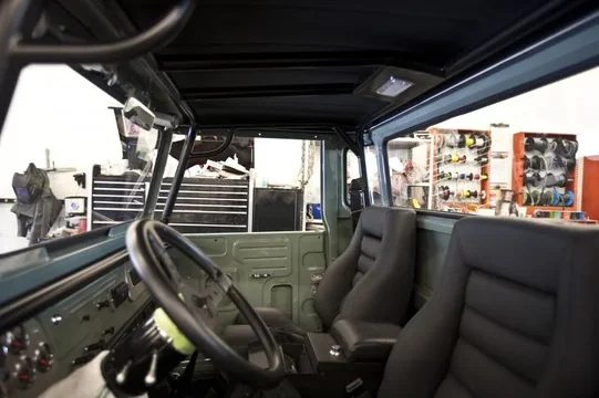

Simply Beautiful! You must be very proud, going to be fun driving that around.
If you don't mind, what brand of seat are you useing.
I'm going to miss reading about your build, when it's done.
Good Job, Ron
Awesome build. I love the balance that you have achieved between functional and staying connected with the land cruiser "roots". Beautiful truck.
It's quite sad to see a company doing this caliber of work go out of buisiness. You do not reach a quality product like that without a lot of caring.
Great truck! more pics!
Good Job, Ron

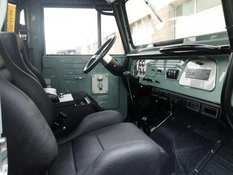

YA me too on the seats they look delicious.
The seats are Corbeau Sport Seats. They don't look nearly as fluffy and comfy on the website, but they definitely are nice in person. Also, it just so happens that without the headrest, the top of the seat is just about the same height as the bottom of the window, so it doesn't look too obnoxious.

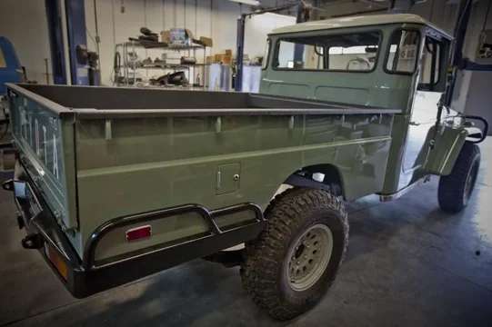

While I'm patiently (not really) waiting for the build to get complete, I figured I would post a few more pictures to keep my mind occupied....:p She'll look much better with a bezel and running boards!

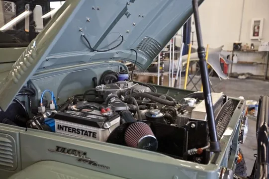

I am anxious to get some seat time behind the 3FE, I'm sure I'll be pretty happy with it. The engine was completely rebuilt, the head slightly shaved down for a bit more compression, and Chevy valves and valve springs installed for a bit better performance. I did start it up, it sounded good (just like an inline six should sound). I'll definitely post up some feedback on how it performs.

I did get about a 45minute test drive in. The seats were comfortable, but remains to be seen how they feel after a long ride.

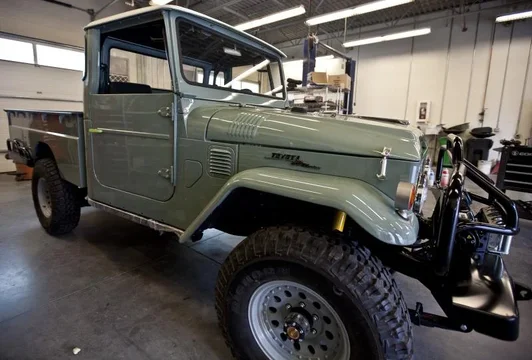

All in all, I was very happy with the way she handles:
  • Bezel, mirrors, headache rack, spare tire are now on.
  • Suspension and steering is great, she felt stable on the highway, got her up to 70mph, steady as she goes. The springs are heavy duty OME Dakar, so she's stiff, but not bone jarring.
  • Engine power and transmission is very well matched. First is a bit granny, and a bit of a gap between 2nd and 3rd, however the low range of the 3FE makes it a non-issue. No issues getting up to highway speed in a timely manner.
  • Great low range torque, really no need to get the rpm's above 3,000 before shifting.
  • 5th gear is matched well with the engine, at least on the flat, I was able to accellerate at will (didn't take it past 70, not really what she's intended for, plus, the wind noise was pretty much deafening). At least I know on long road trips, I'll be able to use 5th gear to keep the revs down and fuel economy up.
  • Brakes work well, no lack of stopping power, but not twitchy either.
  • Engine is fairly noisy. Part of it is because it has a metal 2F timing gear, which make a bit of a growl. I'm ok with that, realiability is the name of the game.
  • Drove in the rain. Got to experince the windshield wiper action a bit. Pretty cool. The randomness of it all keeps me guessing when they'll swipe next!
  • I like the setup of the instrument panel, easy to keep track of everything.
  • Still need to test off road, which is the whole point of the build, but at least I have an idea of her road manners, which I am extremely satisfied with.
  • A few tweaks yet to do, so not quite ready to go home.

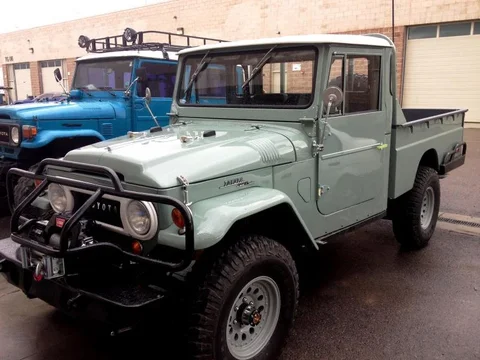

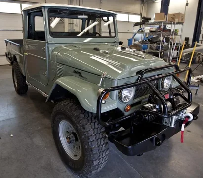

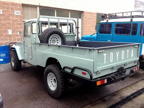

I took a few crappy iphone pictures...you can see she's completely put together (except for the running boards, again, that will wait for final delivery, so I am the one who will put the first scratch on them). Also still some tape on a few parts to protect the paint.
I'll take a few high res-pictures when she's delivered. Will probably be only time she'll look that good, after which, she will be wearing mud, bugs and other such cruiser makeup.
Very nice. That color changes in the different lighting. I've been looking at all the different greens. You made a good choice.
The shade of green is definitely very dependent on lighting. In cooler florescent light, it looks like a darker green, in sunlight, it looks closer to spring green. Of course, the camera makes a difference too. Phone cameras wash everything out and make it look flat. I would say, in real life, it pretty much looks like a sage green, if not a tad darker.
The :princess: got to pick the color, and made a good pick! (I wanted olive green, I'm glad now I listened to the better half!)
