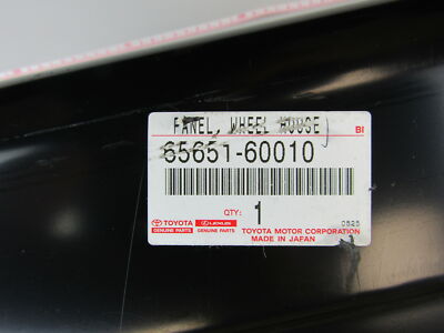

I ordered a pair from Japan, and thought I had lucked into the right part for my truck, but as it turned out, they were the same part number but for a later year(?) as they were larger. But they were only $12 each plus shipping, so...score.
I decided to try and cut down the larger fenders and make them fit. Again, they’re not pretty, but they’ll work, and they’re new steel.

Awesome work! Where did you source the inner fenders from?
I got them through eBay, and they still show them available, but shipping was expensive.
I searched for them as part # 65651-60010, which as it turns out is the wheelhouse panel for a 70 series, which is why it was too big. I had searched for the 45 truck, but I didn't notice when I got this part # that it is for the later 70 series.
It was too tall to fit under the curved bend in the sidewall, too long to fit over the subframe, and too deep so it went beyond the main frame.
Short answer is, I see they are still available through eBay, but also available at some Toyota retailers (which escaped me when I ordered these lol).
