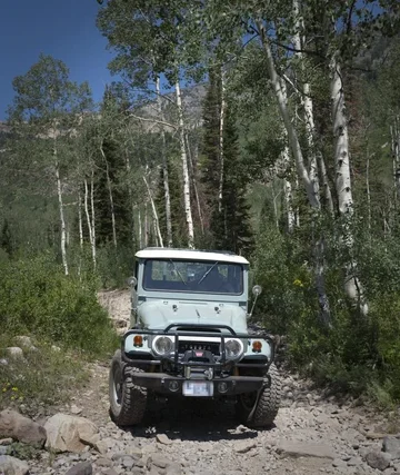

I haven't had a weekend lately where I could take her off the pavement, so I finally made some time last weekend.
The :princess: and I took her on a long loop (6 hours), starting in American Fork Canyon (UT) to Midway to Guardsman Pass back to Salt Lake. The majority of the road traveled was dirt/gravel/rocks, everything from double wide to barely single-wide trail. Did a lot of climbing, from 4,500' up to about 9,000' and back down and up a few times. She rode very well, and the overheating issue is definitely fixed. Had her in low range most of the trip, keeping anywhere from 2000 to 3000 rpm, and the temperature held at 195, the only time it crept above that was when I stopped and was idling, at that point, the highest temp I got was 205. This was on a very hot day (in the 90's to 100's F), with some sustained (45min plus) periods of climbing. Not only that, but she rode like a champ.
A few minor issues, the suspension loosened up a bit, and started to clunk on the upstroke of the suspension. I'll put her up on jackstands and figure out what's loose and tighten things up. Still less than 2,000 miles on her, so some more break-in happening.
The GPS speedo antenna reciever came loose, so a lot of the day was spent not knowing exactly how fast I was going...but most of the time, it didn't matter. Low range 2nd gear is pretty slow. Now I have zip ties in my tool bag for the next time...:D
A few action shots on the Mineral Basin Trail (complete with flowers and butterflies for the :princess:)
