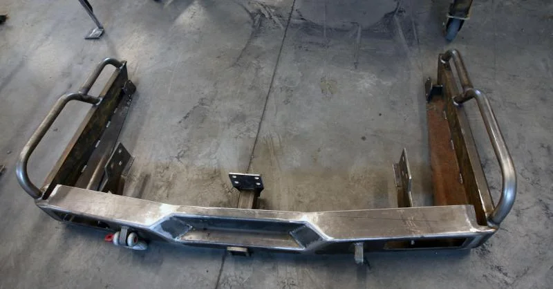

Both the front and rear bumper fabrications are great, but I really like how the rear bumper fits in with the lines of the vehicle, while still providing substantial protection. Has an inset for the license plate, shackle lugs, hitch reciever and cutout for 40-series brake lights/turn signals:

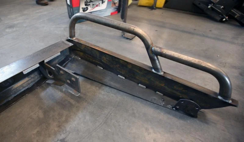

Detail of the side protection/slider. Note how the slider tucks underneath the bed:
