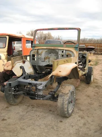

The FJ45 ready for body work, fabrication/mock-up:
And a picture of her when we first met....

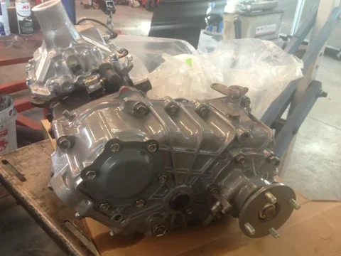

Completed and assembled trasmission/transfer case:

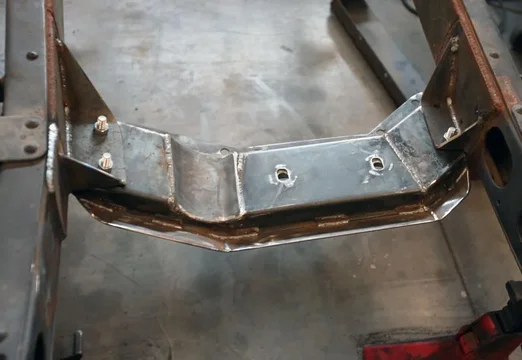

The custom cross member/transmission/transfer case mount. An aluminum skid plate will be mounted to the cross member towards the rear.
