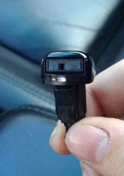

Pulled these washer nozzles and some hose pieces off a 2004 Toyota Tundra. PN for the nozzles is 85381-34030. Much better spray pattern than the old two-jet nozzles. They over spray a little and probably hit just a tad low but much improved cleaning.
These fit in the original nozzle openings. Nozzle fitting points straight down so you will need a slightly longer hose to reach.

The spray pattern at highway speed can be much different than while sitting still. Drove a rented Ford Escape and noticed that at highway speed most of the fluid was blown way too low to effectively clean the windshield. FWIW.

Have you tried these at highway speed? Do they still cover most of the windshield for good cleaning? I might order these up from the dealership while I pick up a few other things and give them a shot. Pun intended.
Yes. They work great - I would say better than when sitting. I’ll take another video at hwy speed and post it. You might try the junkyard for them. The guy here gave them to me free of charge.
If you’re going to search a junkyard...according to Toyota Parts Deal this P/N comes on these vehicles.

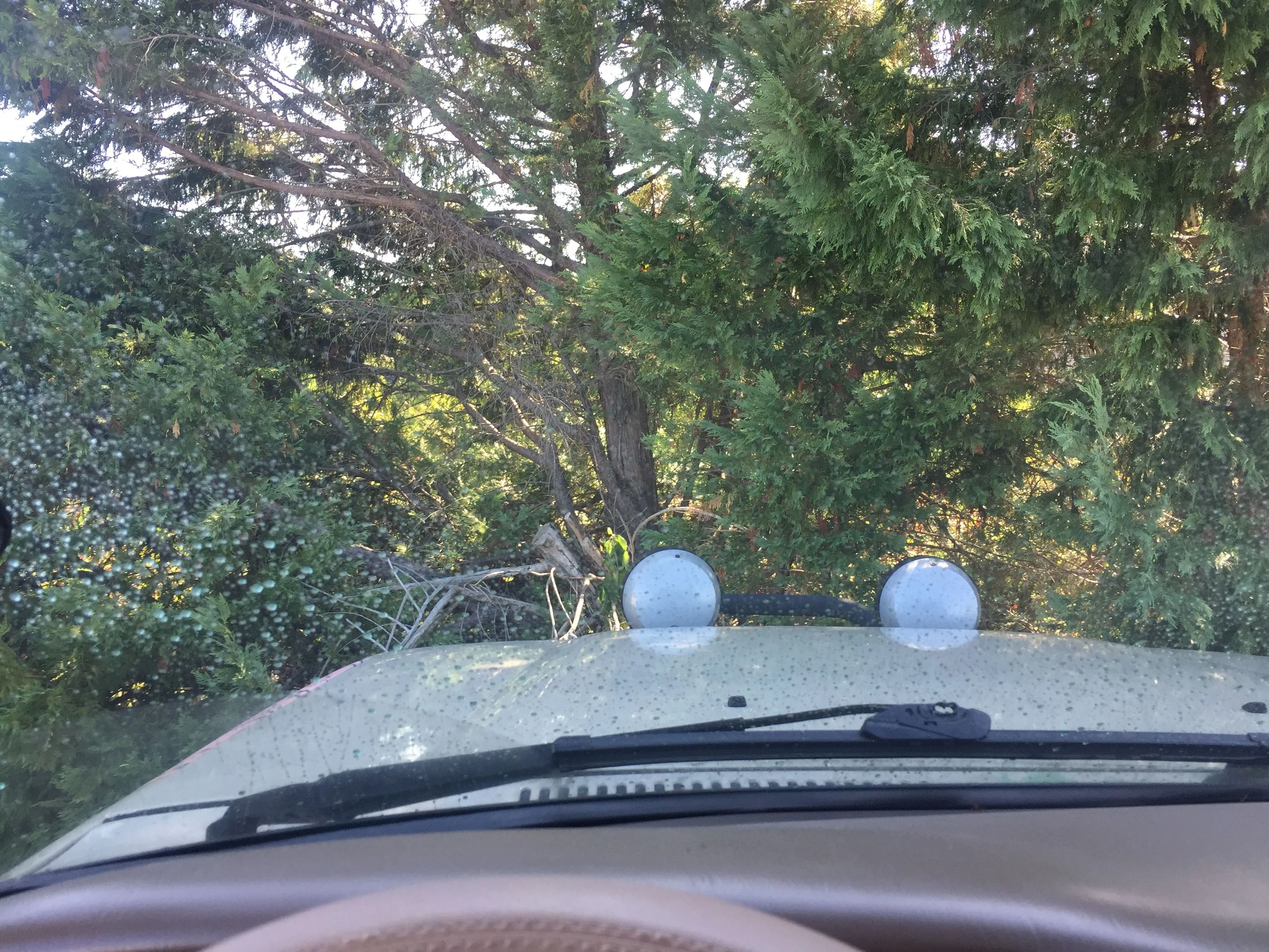

Spray pattern at 60 mph
Spray pattern at 70 mph
It’s not perfect but I do like the way it cleans. As I mentioned before, there is some overspray to the right and left of the windshield- and it does end up on the doors a bit.

Nice. I just ordered a set from the local dealer to install. Worth a shot at $12/each. I wonder if there is a way to decrease the pressure to avoid the overspray as much? I'll ahve to play with it once I get them installed. Let us know if you end up making any further modifications to them!
