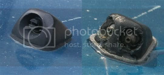

Just a comparison between the two types...
I'd rather have the full spray coverage than thin streams :meh:
Yeah, I'm with you snake eater, but where do i get these nozzles?
