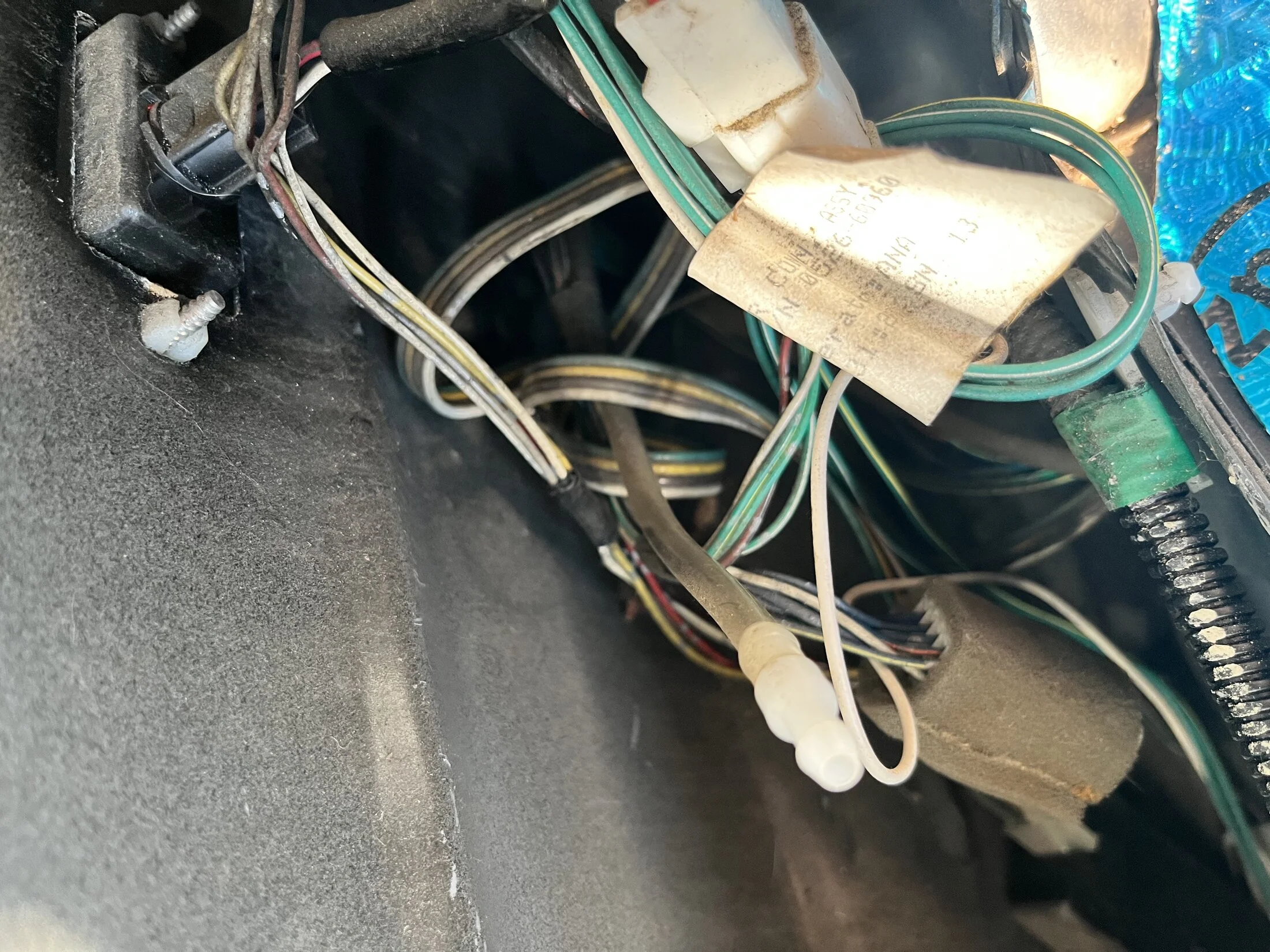

When I was installing sound deadening in the trunk I noted there is what appears to be a small diameter water/air hose coupled to a wiring loom that runs out to the back panel which I cannot see. My rear window sprayer does not work. (I'm aware of 3-4 prominent issues that may be causing this) I wondering if these bone heads at the AV store some 12 years back ripped out the hose that runs from the sprayer pump. Does the tube to the rear window spray run internally in the cabin or at least couple in that area? Where can I look for the other end? Anyone replaced this?

In my 91, it was coupled in the driver side rear fender well by the jack and tool kit. Couldn’t figure out why it wasn’t working until I found it had come uncoupled and was just throwing washer fluid back there.

My fears exactly. This was on the passenger side however. Hmm I'll look around the driver side this morning to see if there's something similar.
The other end should be in the D pillar.

It should be on the drivers side. I didn’t realize that pic was of the passenger side.
Is this the passenger side?
Mine is the same. It’s just an open end.
The driver side has another identical tube that actually connects to another piece and leads to them back window/hatch sprayer. Mine is a late-94 build.
Zero cinfidence its the sprayer tubing. Found the driver side tubing coming from the D pillar. Thanks for confirming on your 94. Im stumped. I guess I'll leave it be.

The hose in your picture is likely the one that is used with barn door models so not used on our models.
Not sure how I missed this post. Thank you for enlightening me.
You may find the check valve in the rear plugged also.
Mine was and the debris was from the disintegrated diverter valve.
