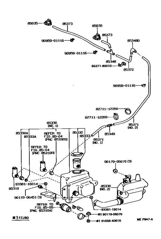

or we could just add another reservoir somewhere. Come to think of it, it would only require one relay.
Use the signal for the diverter valve to throw an SPDT relay that diverts the washer power to the 2nd pump. Wah-lah.

I believe the earlier LC, 91-2 had a second pump in the bottle...
You can install a second pump in the stock washer bottle and redo the hoses and wiring. I'm thinking about this because my diverter valve doesn't really divert that well, but its not bad enough for me to actively want to fix it. :D
Second pump requires a hole in the side of the reservoir and a rubber install grommet. Make the hole at least an inch above the level of the front pump so that if the fluid is low the rear runs out first and you still have a bit for the front.
Shouldn't require a relay, the diverter valve should supply enough power to run a pump.
