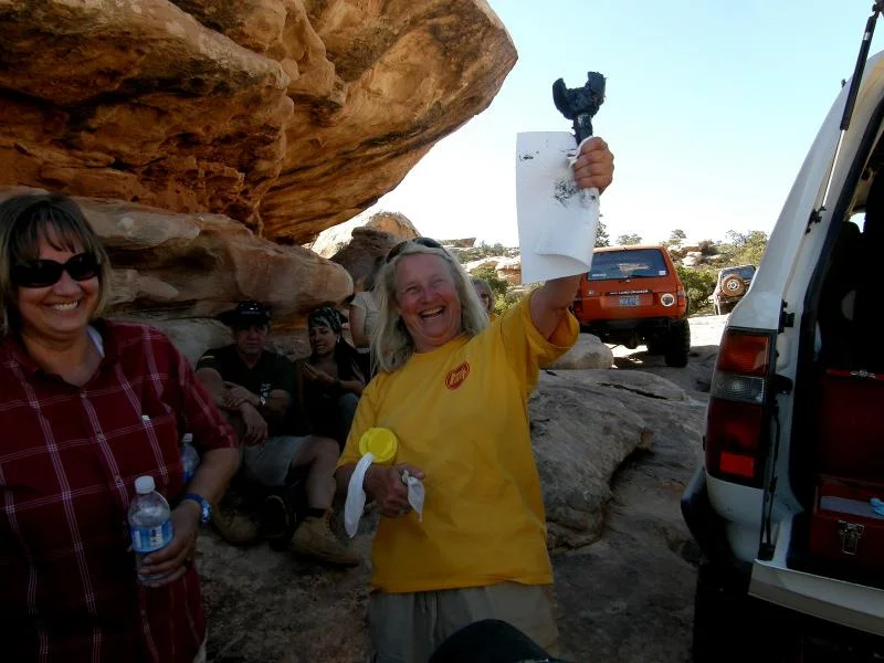

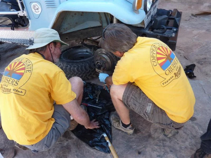

*Side note on the first picture, shorty after this was taken the sector shaft decided to sheer off in the golden crack in Moab. Made for some good times.
Right after yours broke we had a 40 with us that broke (shattered) a birf. Around 60 minutes later she was back on the trail!
yup, wrenched right behind the parked orange truck :o
thanks to Phil and Kevin :cheers:
