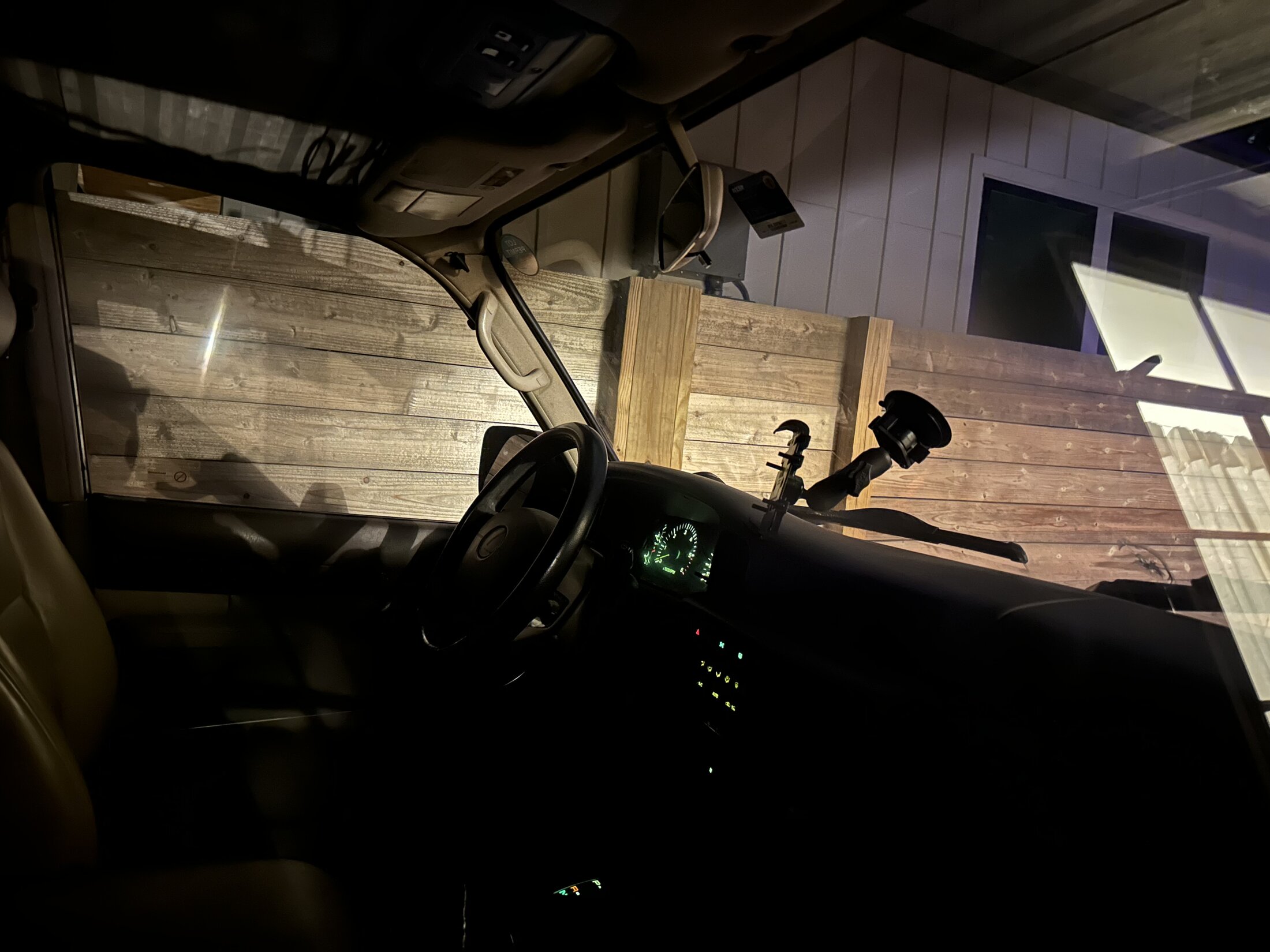

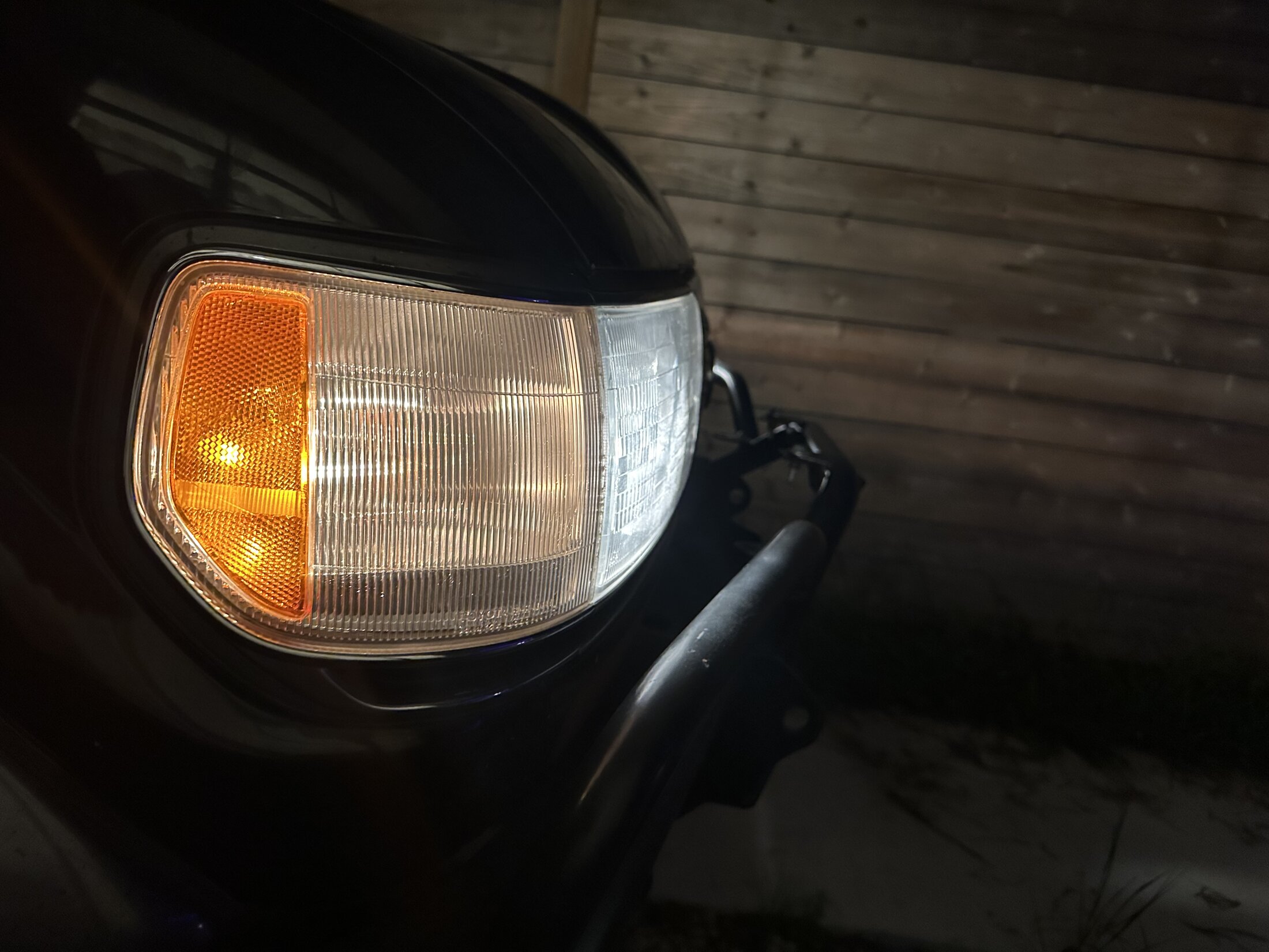

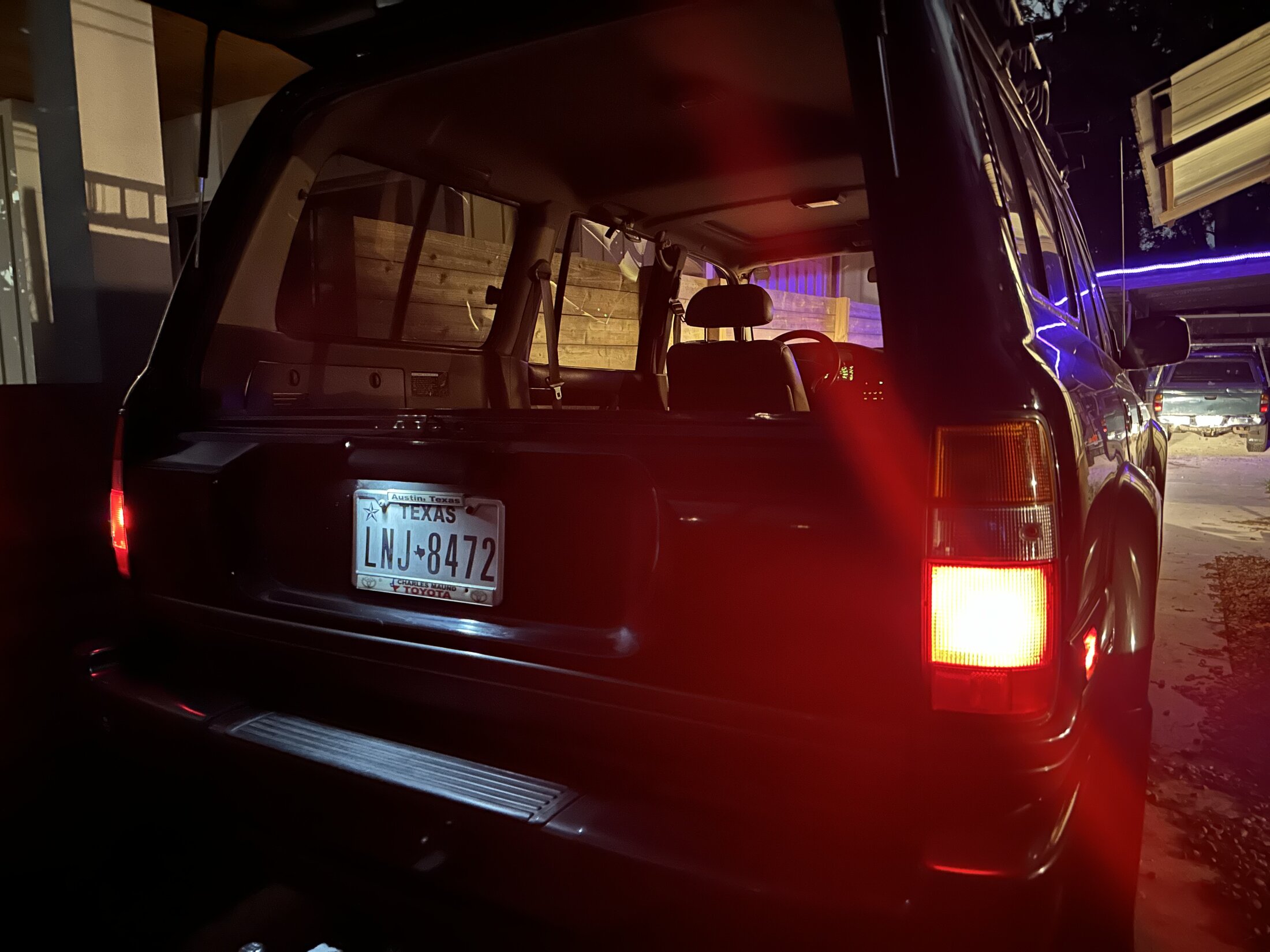

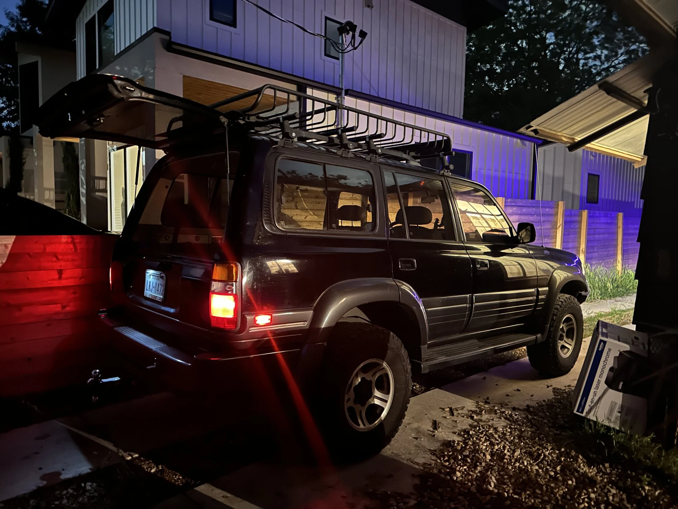

anyway twice now since putting it on when i open the hatch the rear lights, licence plate bulb, front headlights - and i just noticed when going to take a pic to show the keys were not in the the ignition - that the dash lights light up.
then i noticed when i lowered the hatch partways they all went off.

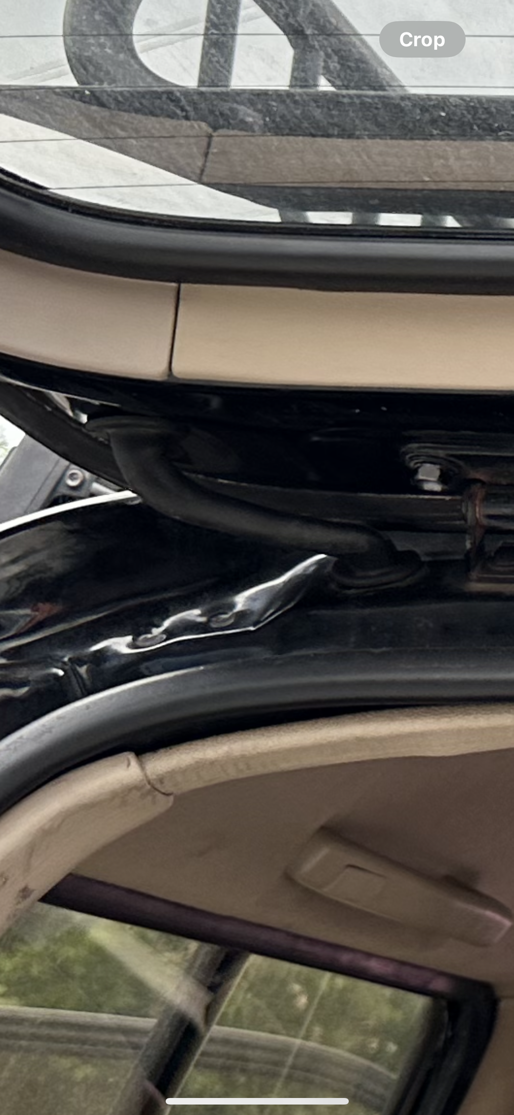

i asked the guy about the plug and wiring and he said they just reused the existing wiring.

Look at the wiring harness at the top of the hatch. Odds are there is a bare wire grounding out and causing all the lights to come on.
Remember Toyota switches the ground side, not the hot side.

i believe they would have reused my existing upper liftgate harness since the one on the hatch i put on was cut. so they would have had to reuse my harness. again i replaced the upper hatch.
and there is a bunch of wiring in there. some must go to the lock mechanism?
