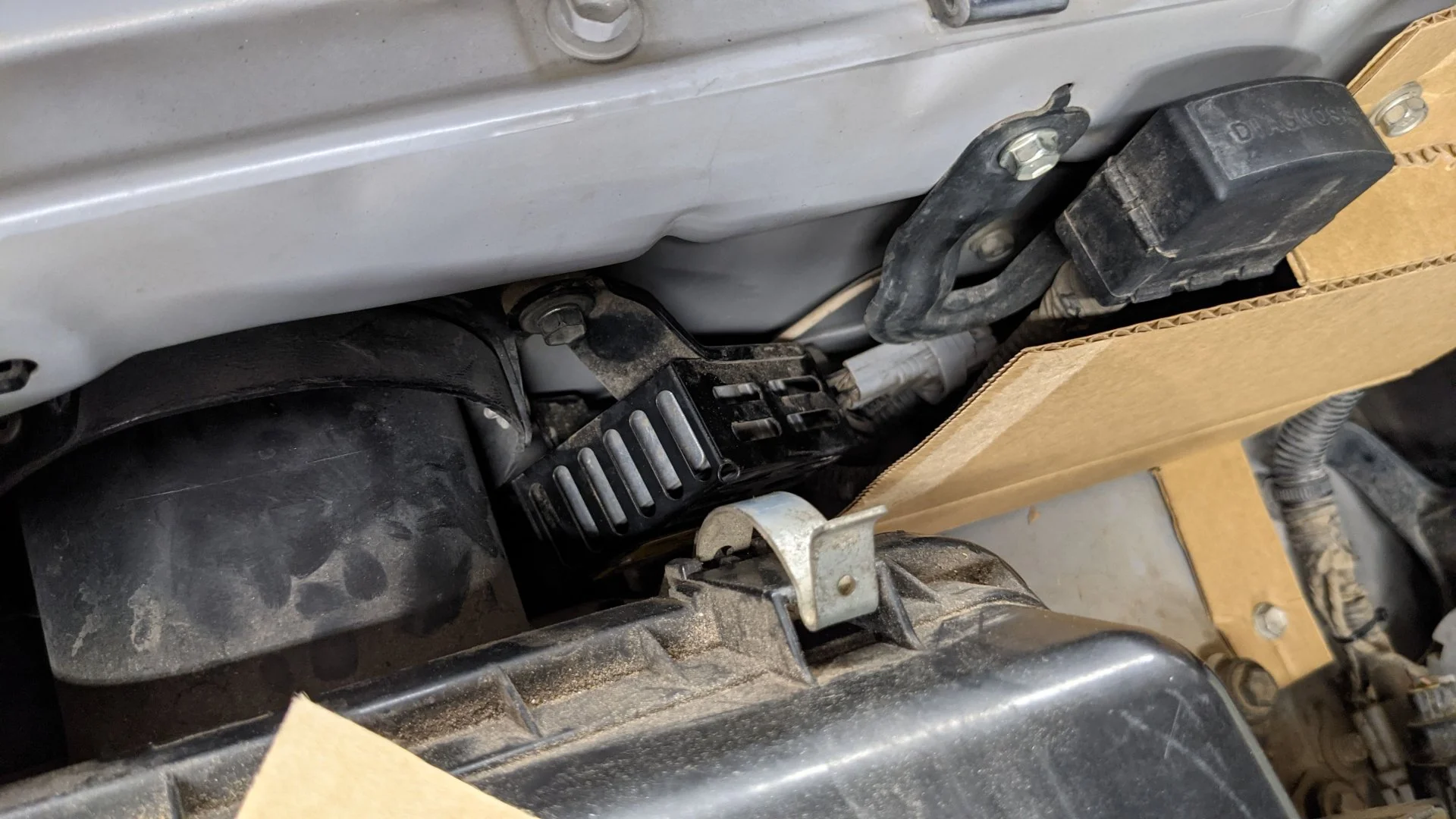

I haven't read the entire thread yet, but I have been having issues with "vapor locking" for lack of a better word. For the past couple of days i have poured all of m free time learning how to read 3d graphs that incorporate, temperature, pressure, and ethanol% of gasoline, as a junior in high school i just havent been able to make sense of much of the variables or standards used, but i do know that running ethanol free gas has completely stopped the problem for us, but wheres the fun in only getting to use one type of gas. From my findings and my scenario ethanol free gas does help the engine to run quite a bit cooler (being able to touch the top radiator hose while engine is running on ethanol free, but it being too hot on regular gas). I have tracked down our first event of "vapor locking" to almost exactly a week after i installed onboard air. In the process of creating my own mount, i had to "relocate" some electrical box that has a black cage around it to not burn yourself ust to right inbetween the airbox and the fender, i also put the mount directly over the fuel pump resistor which i remember getting too hat to touch even when it had direct airflow.
In the photos you can see where i had to relocate these electronics to and how they arent getting much to any cooling now. I guess my main question is would the engine running a bit coolr because of the ethanol free gas really make a big enough effect on these components temprature to not have them overheat?
I haven't read the entire thread yet, but I have been having issues with "vapor locking" for lack of a better word. For the past couple of days i have poured all of m free time learning how to read 3d graphs that incorporate, temperature, pressure, and ethanol% of gasoline, as a junior in high school i just havent been able to make sense of much of the variables or standards used, but i do know that running ethanol free gas has completely stopped the problem for us, but wheres the fun in only getting to use one type of gas. From my findings and my scenario ethanol free gas does help the engine to run quite a bit cooler (being able to touch the top radiator hose while engine is running on ethanol free, but it being too hot on regular gas). I have tracked down our first event of "vapor locking" to almost exactly a week after i installed onboard air. In the process of creating my own mount, i had to "relocate" some electrical box that has a black cage around it to not burn yourself ust to right inbetween the airbox and the fender, i also put the mount directly over the fuel pump resistor which i remember getting too hat to touch even when it had direct airflow. View attachment 2929602View attachment 2929603

06-07 have a weak fuel pump. Typically they show themselves as they get hot. This happens mostly on hot or warm days, after running in high RPM for a few minutes. Like when pulling up a mountain pass. Then as we let off gas pedal to descent mtn pass, engine dies from fuel starvation (lean fuel bk 1 & 2). What happens is fuel pump heats up in high speed mod, building up resistance in motor and possible it's circuit.. Then as we let of gas, fuel pump drops back to low speed mod. The increase resistance due to heat, reduces fuel pressure/flow. Fuel pump fails to produce enough follow/pressure.
That said:
I don't see ethanol free gas making much difference, to fuel pump. Other than return (EVAP) fuel heating around engine, heating fuel in tank. This could raise fuel pump temp a little.
Blocking fuel pump resistor heat sink, could affect resistance I suppose. Condition starting just afterwards, certainly points to a relationship. Getting it stall "on demand", then remove blockage (aftermarket air) and try to repeat. Would be helpful diagnostic tool..
