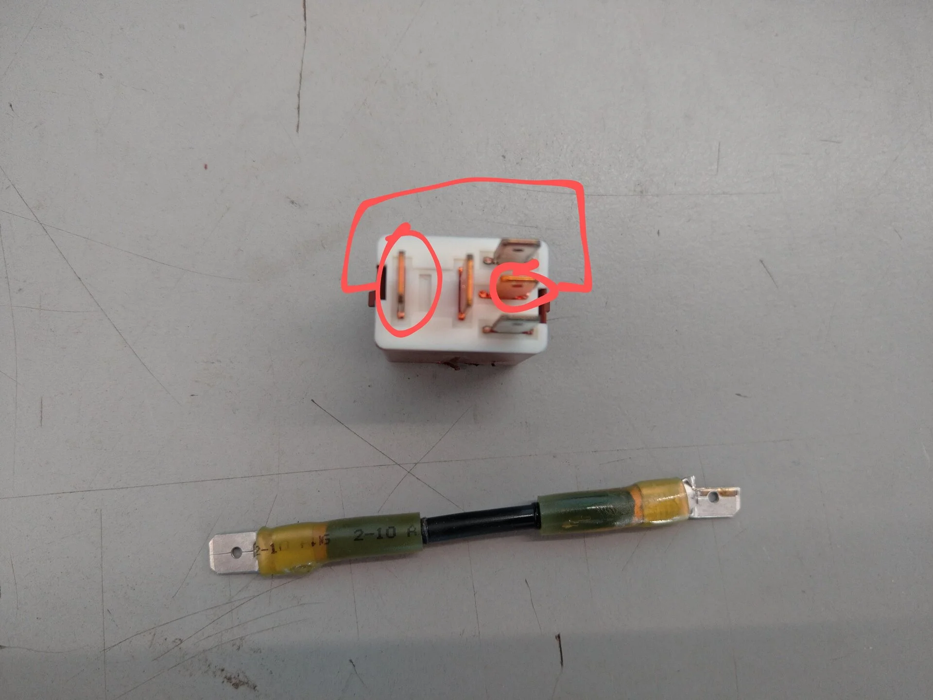

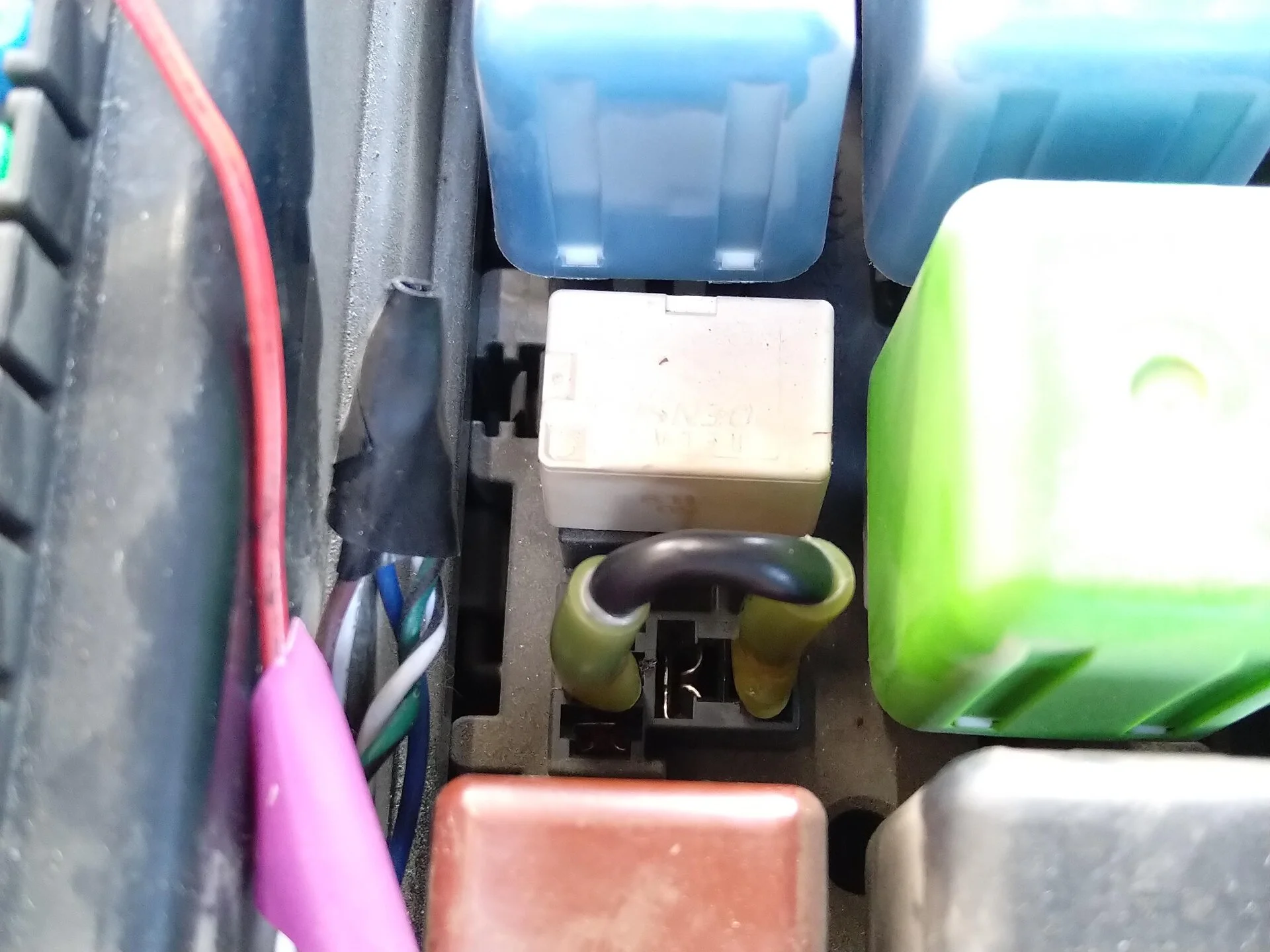

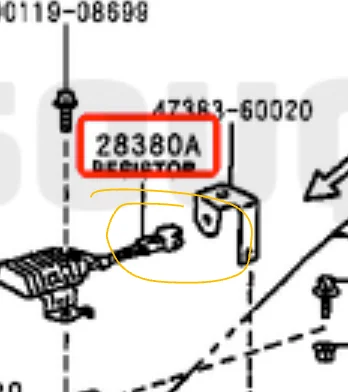

I did away with the fuel pump resistor altogether so now the pump runs at 12v all the time. Truck has never run better. Got the idea from @white_lx
Talk me through this. Removing the resistor will cause the fuel pump to pull whatever amperage it would naturally have, as well as some level of voltage increase from nominal (not sure how much). Do we know that the fuel pump is supposed to be running at 13.8VDC? Was the resistor there to reduce the delivered pump voltage specifically?
It was there to quiet the pump noise. Resistors are cheaper than insulating a fuel pump.
I seriously doubt there were any pump life longevity ambitions.
I made and sold a few fancy bypass connectors for it.
I don't have any more but there is a thread. Many ways to delete it.
You want fuel to speed through the rails, not sit around at a lower flow rate spending more time on the front of the engine.
Sorry to say, moving it to the airbox is silly. You want hotter air going in? or you want a fan on your resistor? 200 degree heating element in your airbox, no my friend.
Dead on the side of the road, people should just insert a plain wire shorting the female terminals at the resistor.
Other way around. The resistor will reduce the voltage but the amperage will probably be the same, or maybe slightly more. Just about every car on the road with an electric fuel pump runs at battery voltage. The 100 series is the only vehicle I know about that lowers the voltage with a resistor. The fuel pump should actually run cooler at higher voltage. More voltage = less amps, amps create heat. Also, as a resistor heats up, it increases its resistance. So the hotter the truck gets, the lower the voltage to the fuel pump gets. It was probably done as a MPG or emissions thing that only matters on an EPA rolling road.

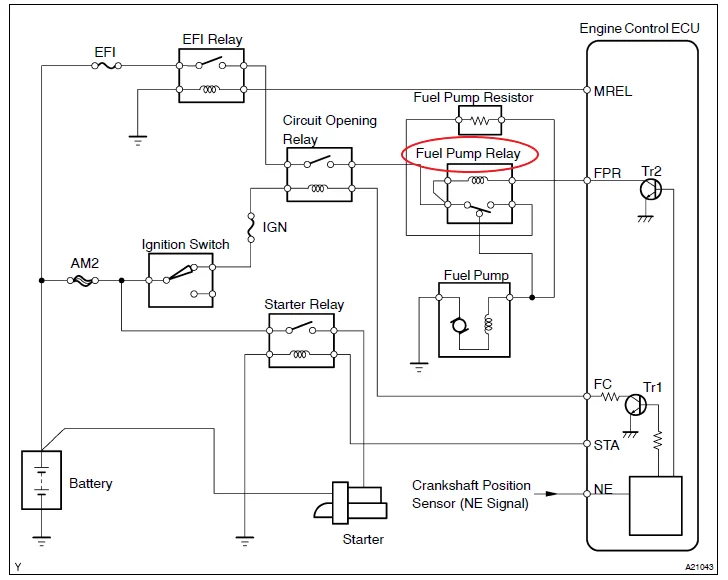

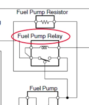

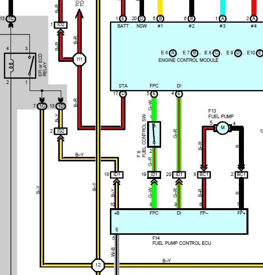

Common on other Lexus's of the same time period ~2005. But actually, the 98-02 100's did not have it.
Before the resistor, the fuel pump speed was controlled by a 'fuel pump ECU' . There were 3 different fuel pump speeds speeds. It looks like the introduction of the resistor was to reduce component cost and/or to increase reliability. From the 2000 LX repair manual:
The fuel pump speed is controlled at 3 steps (high speed, medium speed, low speed) by the condition of the engine (starting, idling, light load, heavy load), when the engine starts (STA ON) or heavy loads with engine high speed, the ECM sends a Hi signal (about 3.8 V) to the fuel pump ECU (FPC terminal). The fuel pump ECU then outputs Hi voltage (battery positive voltage) to the fuel pump so that the fuel pump operates at high speed. When the heavy loads with engine low speed, the ECM sends a Mid signal (about 2.5 V) to the fuel pump ECU (FPC terminal). The fuel pump ECU then outputs Mid voltage (about 10 V) to the fuel pump so that the fuel pump operates at medium speed. When the idling or light loads, the ECM sends a Low signal (about 1.3 V) to the fuel pump ECU (FPC terminal). The fuel pump ECU then outputs Low voltage (about 8.5 V) to the fuel pump so that the fuel pump operates at low speed.
Interesting data point: the 2001-2006 Lexus LS430 also has a fuel pump resistor.
