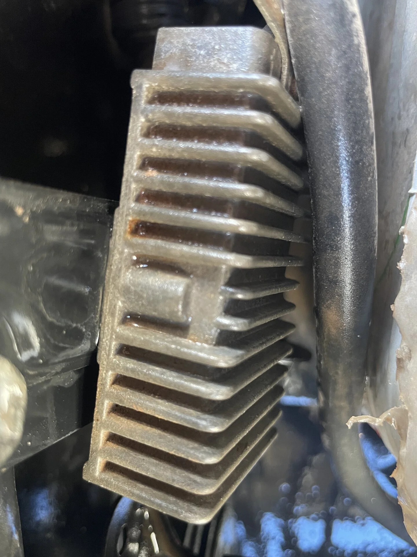

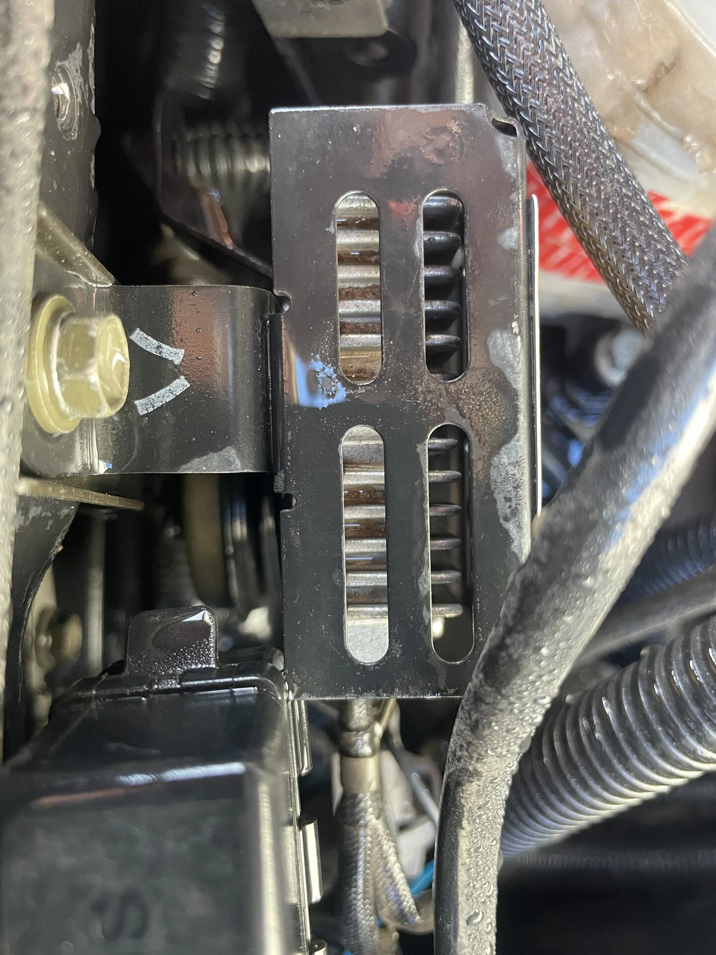

Likewise, is there any value in relocating the fuel pump resistor to a place where it gets more cool air flow?
ALSO: Could it be that the defective pump slowed down so much when it got hot, along with the resistor getting hot, that the fuel pressure was too low to prevent fuel boiling in the lines?
NO. I don't see much value in cooling fuel pump resistor. In pure stock 100 series. Although running cooler, reduce resistance. The fuel pump resistor, should handle heat. With very minimum voltage & AMP drop, since that is what it is designed for.
YES. If heat is trapped, by aftermarket components. If the heat sink, can't shed heat as designed. If, they then keep reaching higher internal heat than designed for. Likely then, some value in added cooling. Excessive heat, over long term. Resistor will likely, become less effective. Which could drop Voltage & AMP, that it delivers down stream a little. I suppose they could even fail in time, if heat to high. But I've yet to see one fail.
I ran a fuel pump resistor heat test, one summer. I saw resistor heat sink, between 129F & 198F w/OAT of 79F to 97F. As read w/IR temp gun. In summer sun, on the 2003-2007 100 series fuel pump resistor. Which one w/165K miles 07LX had new Fuel pump, to correct stall. One 145k miles 07LX had factory fuel pump, no stall issues ever reported in history. A 320K miles 03LX and last one 198K mile 06LX, with no reported stall, unknown if FP replaced.
