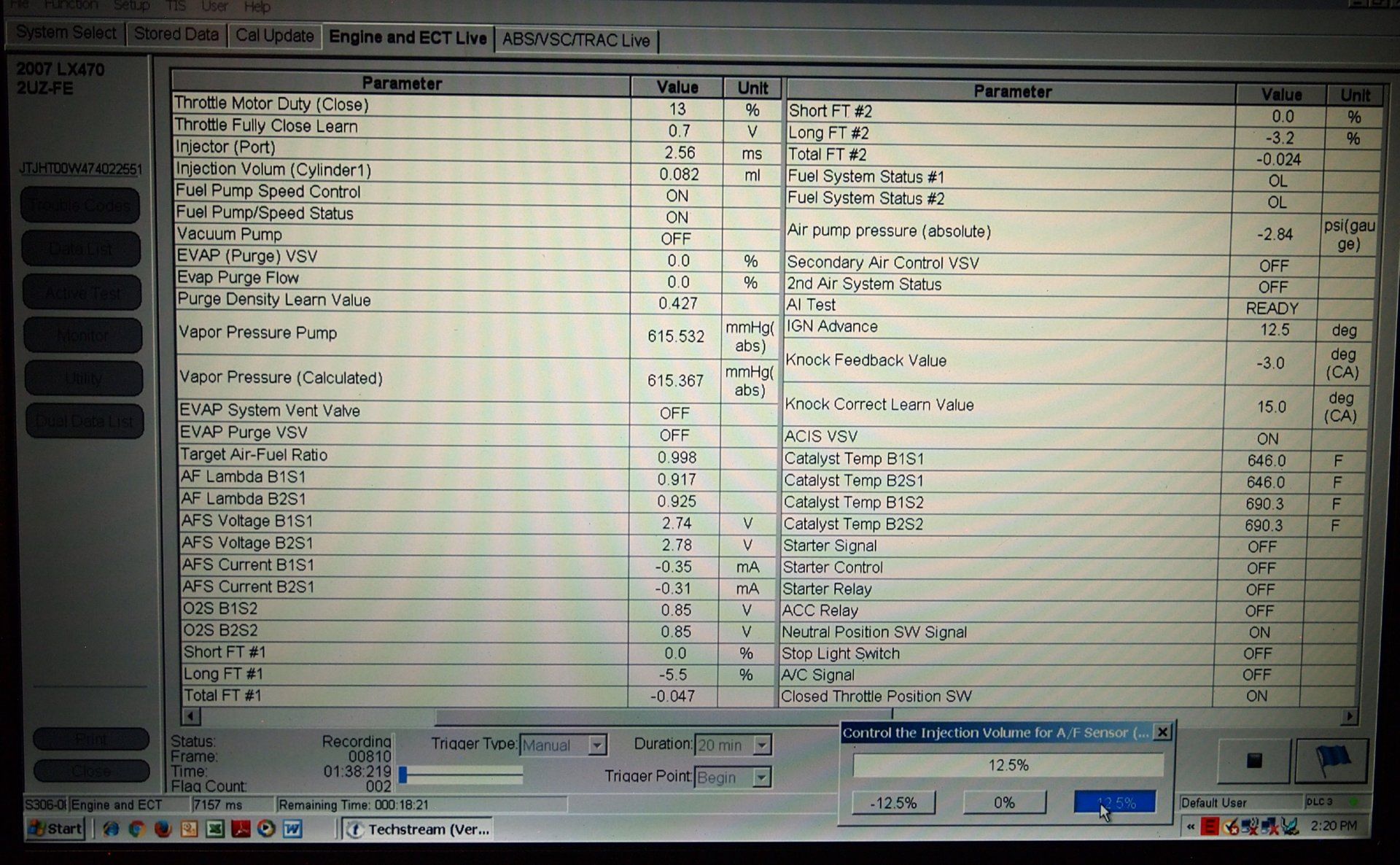

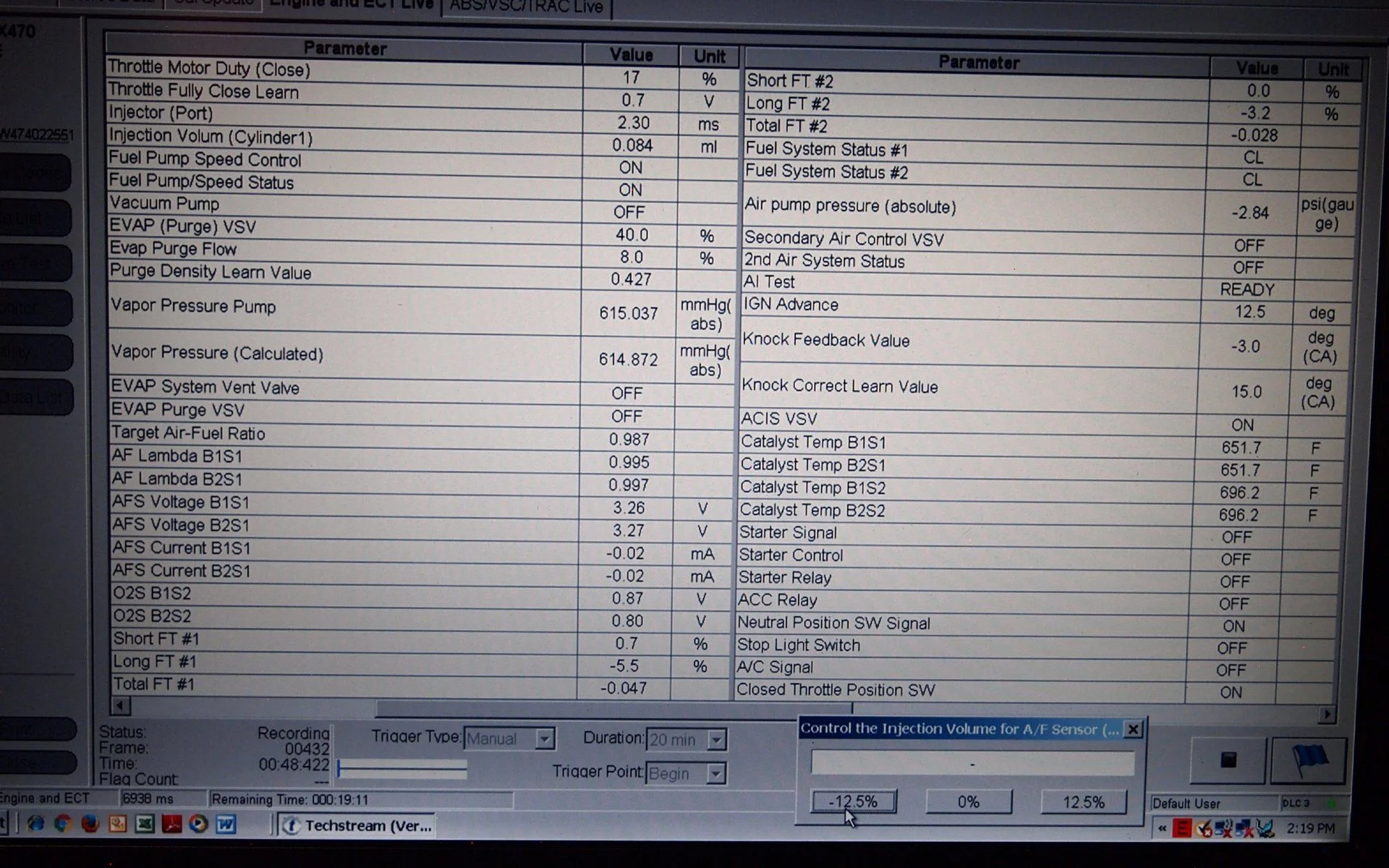

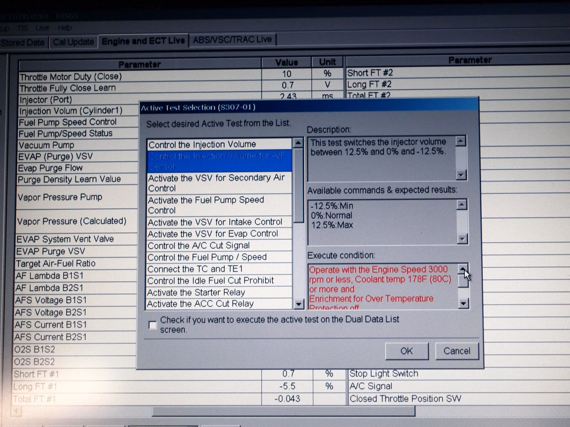

For manually checking CAT tempt with IR gun. Search you tube.
You'll see CAT temps in live data.
To play with injectors see Active test..

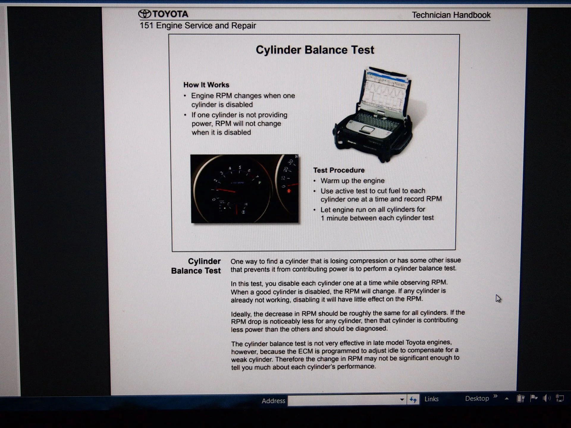

But there was a number of test suggested, you did not perform, once filter seem to cure! Or had done by mechanic, that were done wrong or result indicate you've a compression issue.

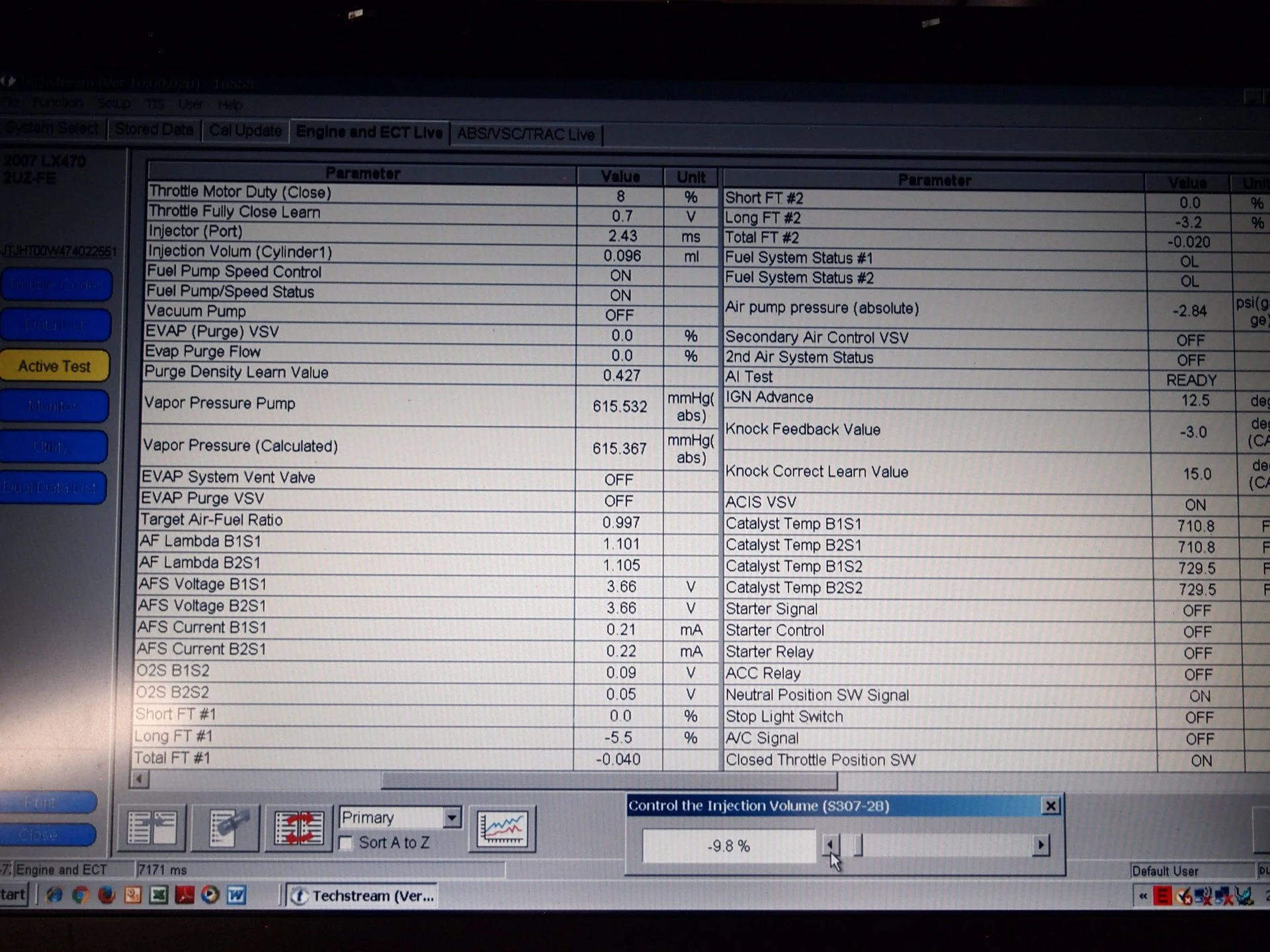

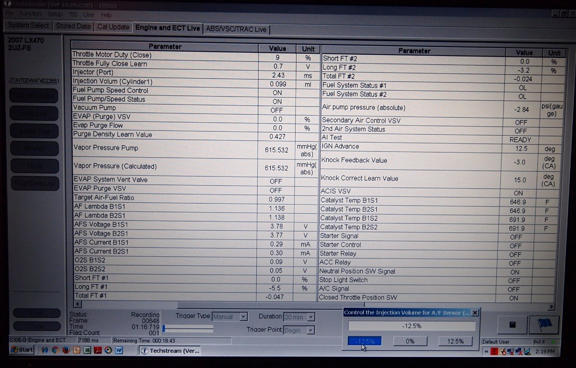

I am getting low voltage b1s1 just like the first screen I posted #49.
it got better when I replaced the fuel filter but its back again. @Julian Stead can you explain what's going on.?

You've had multiple issue for years affecting CATs. Number one seem to be bad gas. When I suggested bad gas last year. It was because of conversation Chuck of FIS (Fuel Injector specialist) had with the a UK supplier of FI cleaning equipment. They said, in your area, bad gas is damaging FI. Stands to reason, that fuel pump wear faster weaken flow/pressure and fuel filter is getting clogged. With this bad gas!

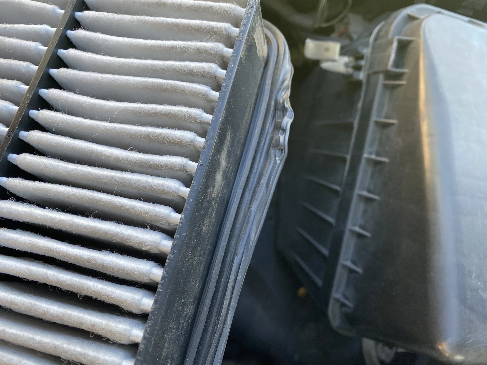

You also had inconclusive compression test. I say that because, I doubt you had 110 to 120 PSI range. That is well below minimum compression of a 2UZ. When compression drops that much it a 1,000,000 to 1 the the balance so even, By balance I mean they 10 PSI difference between cylinder you reported. You had used a K&N filter which will reduce compression over time. Especially where dust in atmosphere high. They are not near as good at filter as OEM air filter.

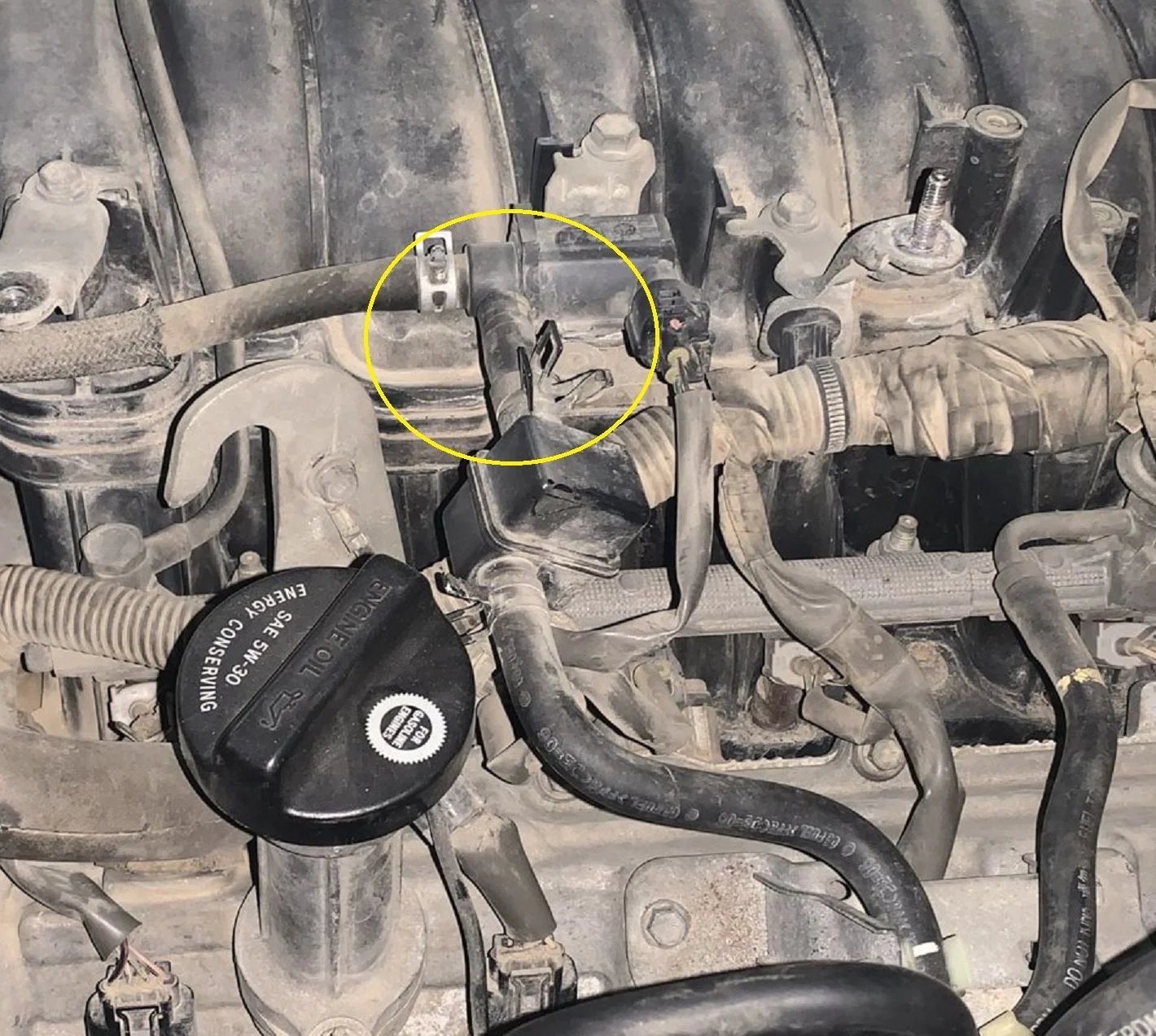

I did just noticed something review this thread. This vacuum hose for EVAP system IIRC does affect fuel tank pressure and absolutely affects engine vacuum. Is turned and clamp not in position. This tells me the intake manifold was likely removed at some point at just this vacuum line from EVAP VSV . Although not a very bad vacuum leak as far as engine running. It is a drop in pressure in EVAP.

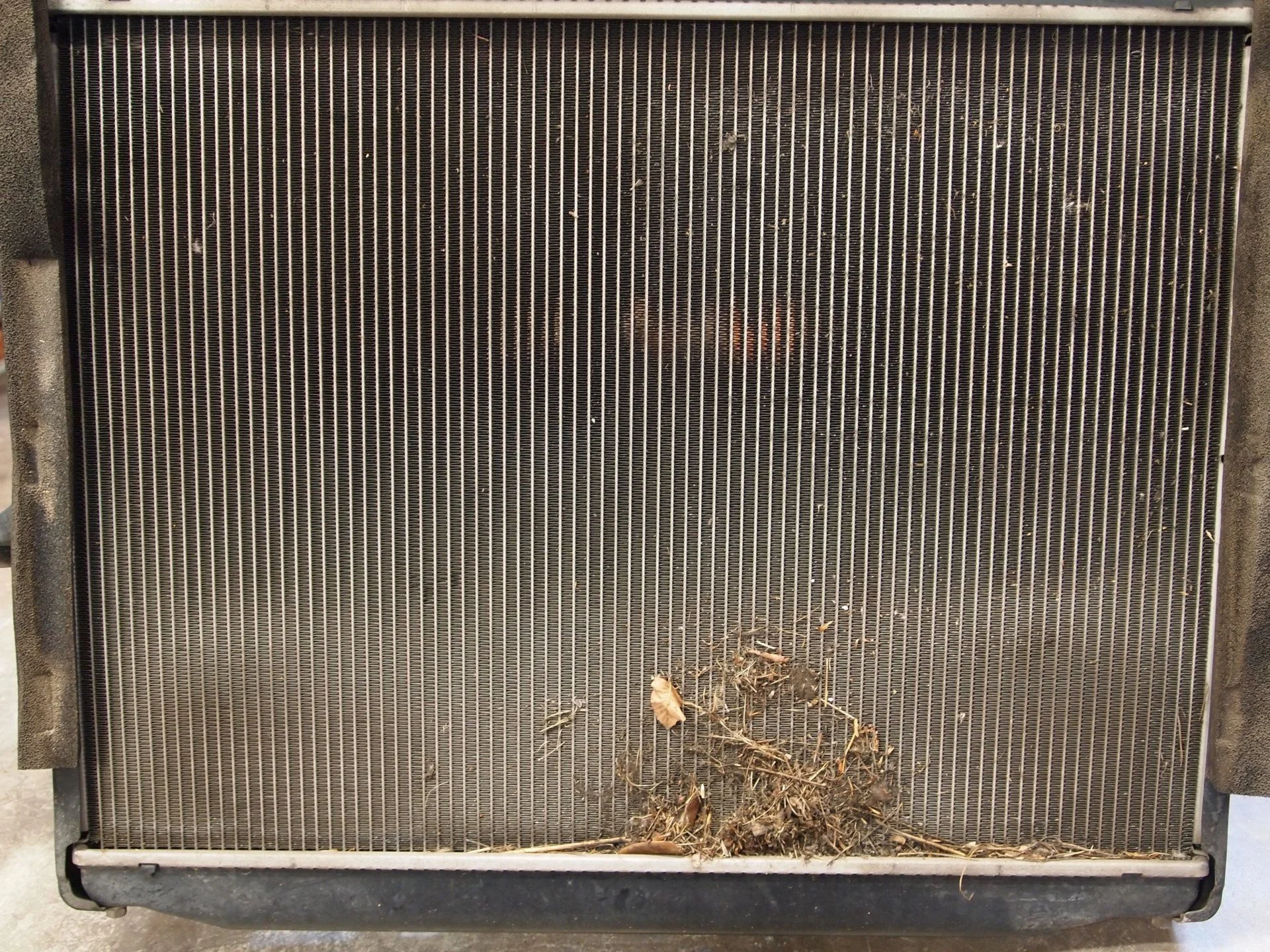

I'd also watch FT and ECT, IAT, RPM, speed and IAT in real time, logging this data on your drives. Very likely your engine is running hot. May be spiking under certain conditions.
What I'd do if here.
  • Log data on drives.
  • Coolant system service, starting with radiator fin cleaning. Taking hard look at Fan clutch.
  • Tune, stopping all vacuum leaks. No leak is a good leak! Use OEM air filter.

Once these lines removed. They tend to then fit back loose. If you can easily rotor, replace it. Partsouq is great sour in your part of the world.

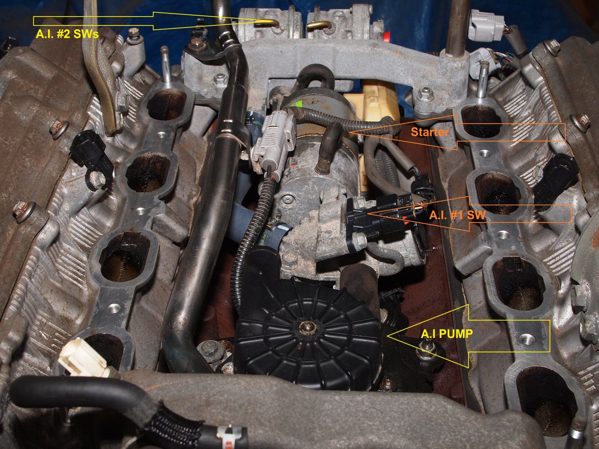

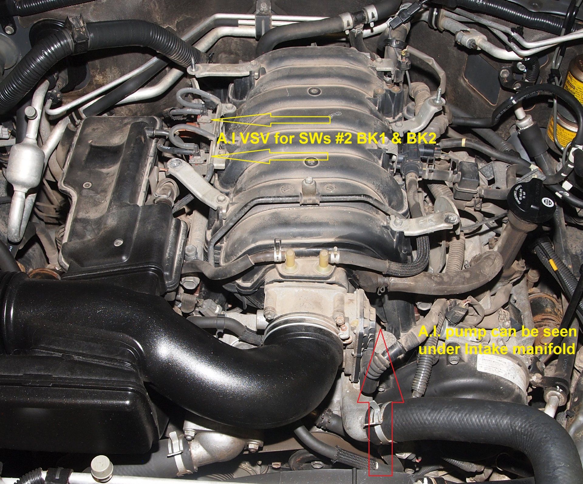

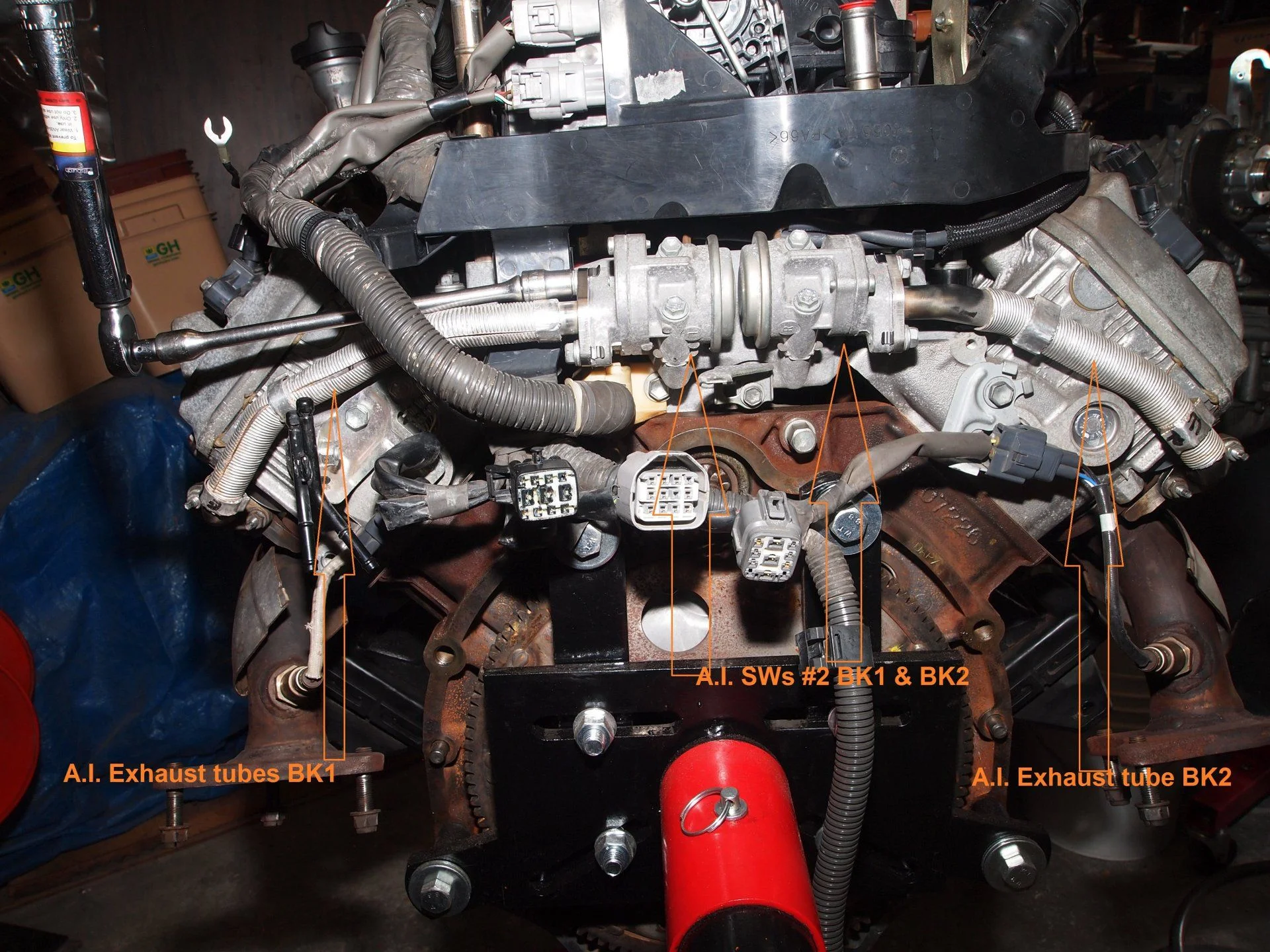

Since you do not know what it is. You'll not likely have seen inside A.I. pump to see the filter. But here is what I'm asking about.
A.I pump is under the intake manifold (IM) of the VVT engines. It is required in 100 series made for USA market, as part of pollution controls.
A.I. pump can be seen by looking under the IM from LH front of engine with a flash light. It is black plastic and sits in front of starter. If you have the system, the A.I. VSV for SWs #2 BK1 & BK2 can easily be seen on top RH side of intake manifold with vacuum lines connected to them.
I need to know if this filter is gone or still in the A.I pump. It can only be seen with intake manifold off, or A.I. pump out of the engine so it can be looked into to see the foam filter.
