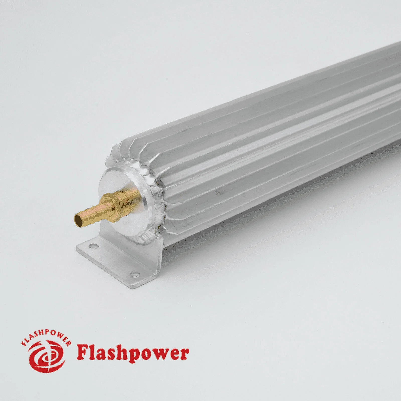

I've one now we're trying to get ECT (engine coolant temp) down. One thing we're going to try is a new fuel pump. It had a crank no start, after a heat soak (boiling fuel). It's possible it's running lean at times due to heat soak and high outside air temp (OAT). Thinking is, heat increasing resistance in wiring and pump motor. The shutting down, may be clue of a bad fuel pump during heat soak. Slowing flow and pressure of fuel delivery to rails/injectors. Causing a lean running condition (hot cylinder head temps). Also fuel heating, may also reduce fuel delivery to cylinders, as molecules expand. Also adding to lean condition.
