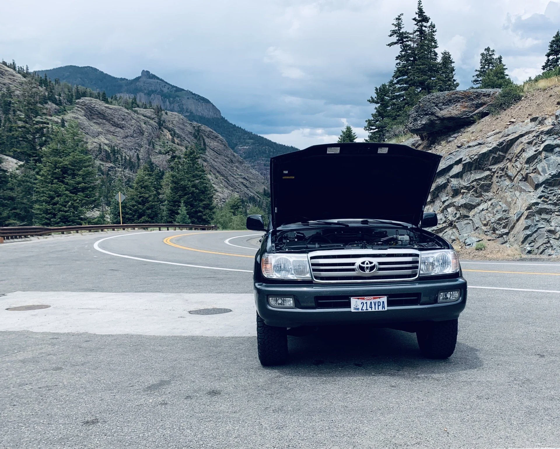

I'm a believer... Last summer I stopped at the Bear Creek Falls overlook between Ouray and Silverton and the truck wouldn't restart. After letting it sit with the hood up for about 30 minutes, it finally fired. It hasn't had a problem since.
We started the day in Grand Junction so we were on the road a few hours and the truck was hot. The fuel pump had been replaced a few months earlier with a Toyota OEM replacement, but am still running the original charcoal canister.
Said truck, caught while behaving badly:

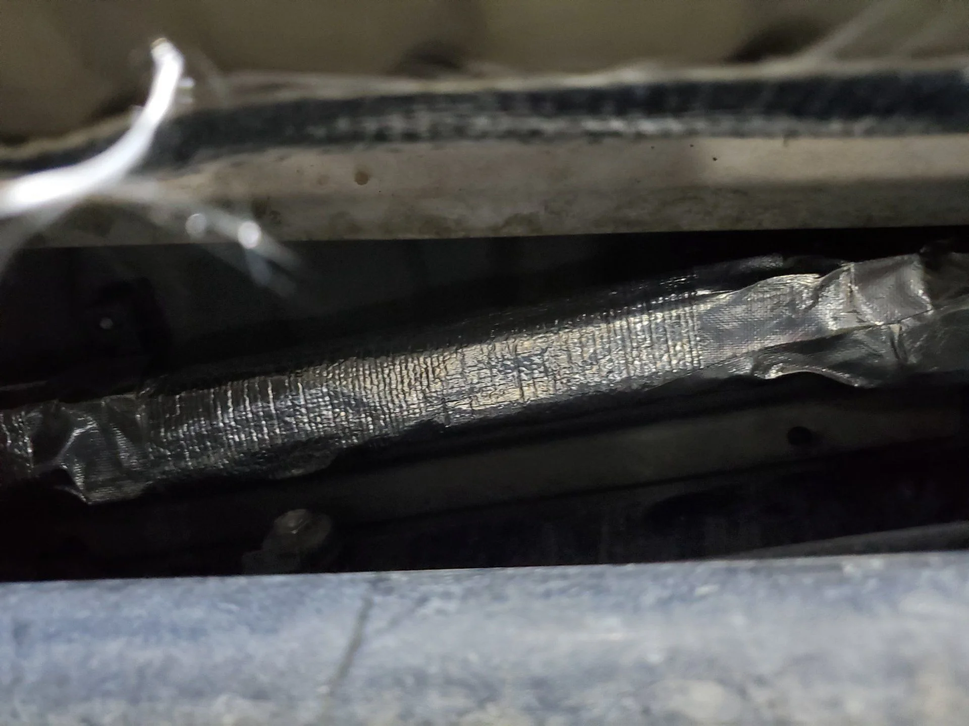

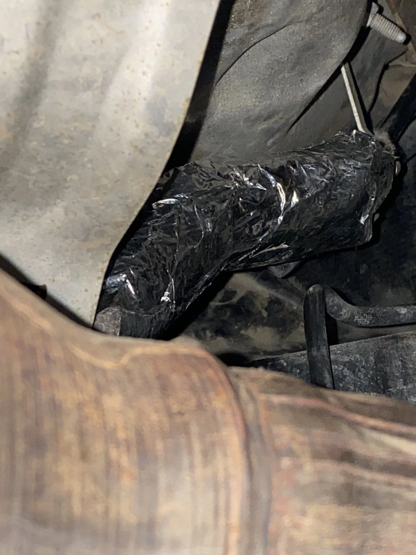

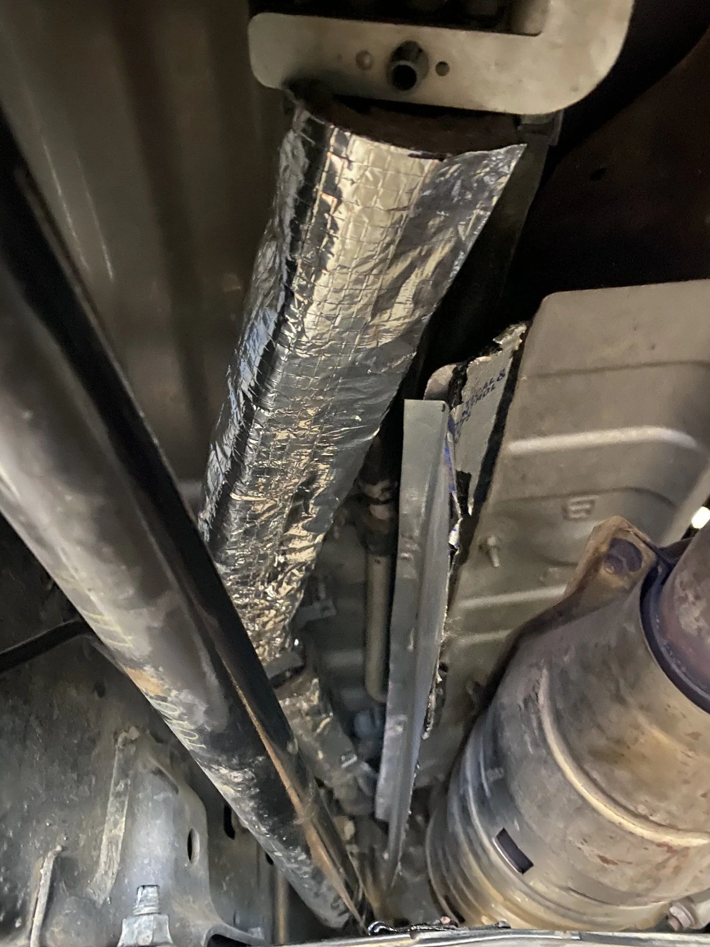

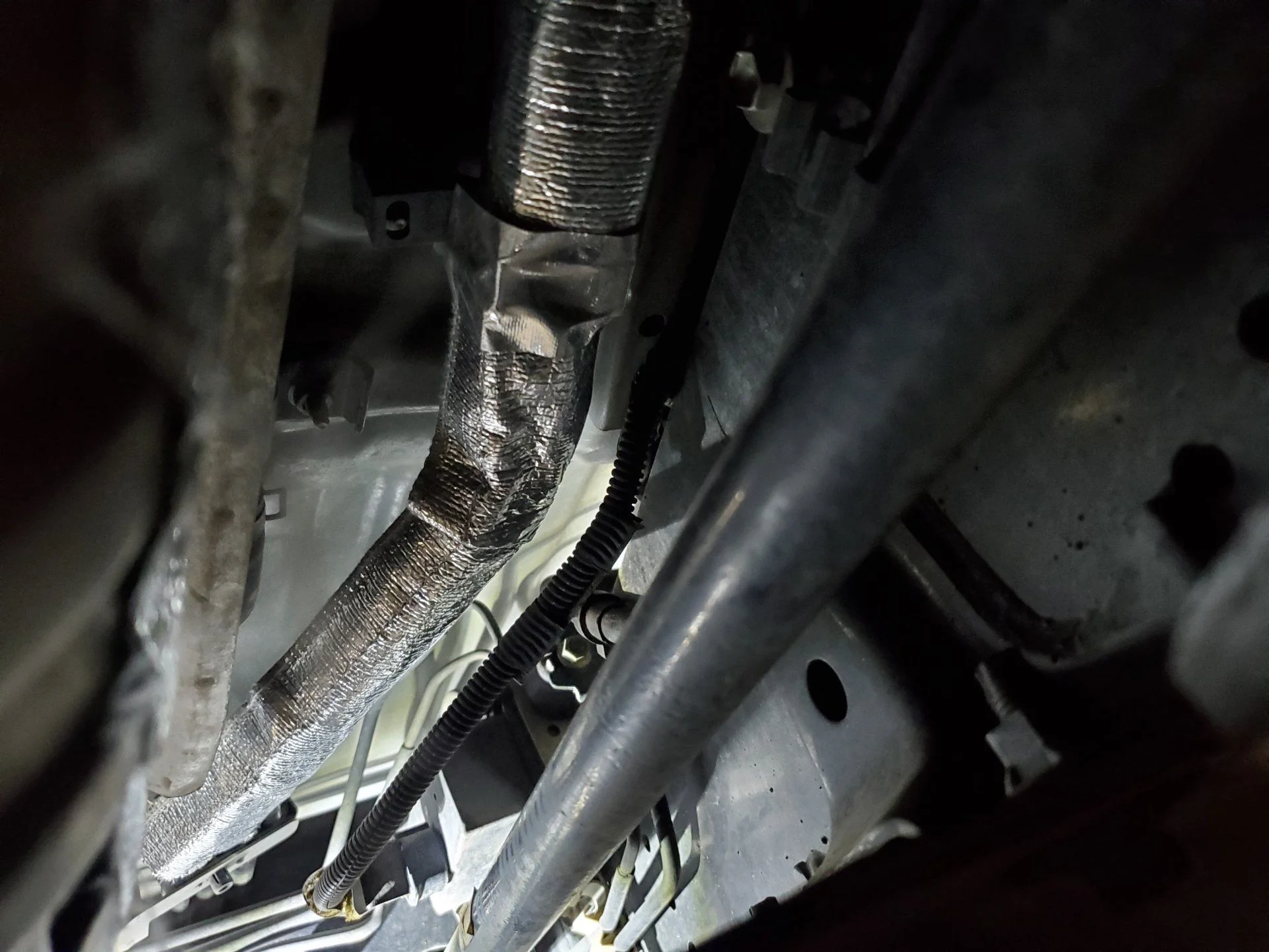

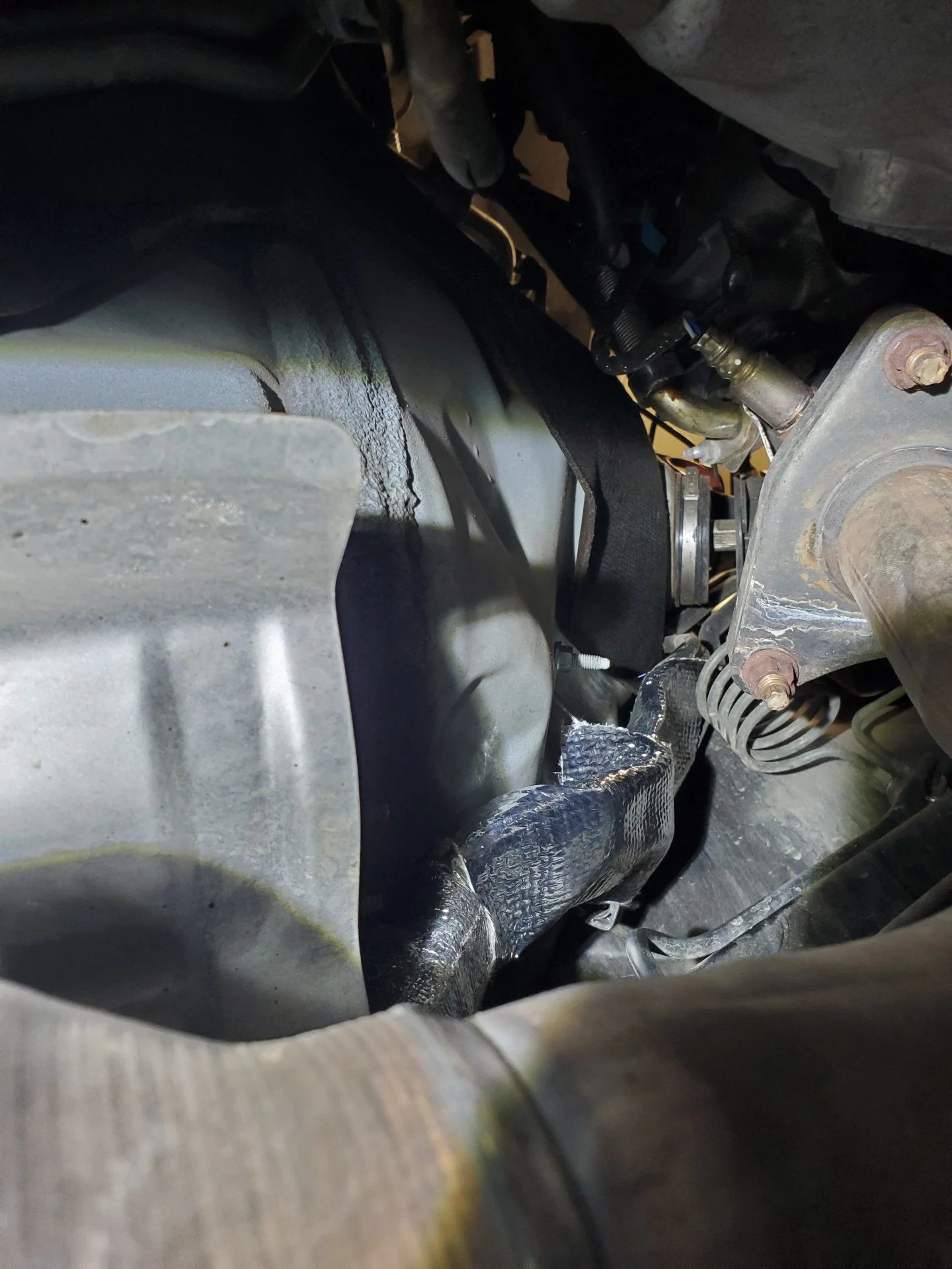

I had a trip planned to Yellowstone with the family and prior to taking a trip, I took the time to wrap the fuel line with heat shield mat. the material I use a similar to the one I have attached to a link below. I used it on my firewall of my race car and I had an extra supply laying around so I don't know the exact brand. I believe any product similar to this would work fine.
Amazon product ASIN B073RLZPJ7
the trip entailed a total of 2800 miles through six different states in temperatures varying from the mid 30s and up to 113°. Elevation changes from 1500 feet up to 8000 feet. And there were absolutely no issues! on a recent trip, a couple of months back, I drove in the mid 70s temperature from 4000 feet elevation up to 10,000 feet, and although I had no issues. When I shut off the vehicle I had trouble starting it and had to give it a few minutes as I heard hissing from the gas cap after opening it. But this most recent modification of wrapping the fuel line seems to have resolved everything.
below is a picture of the fuel line and the return fuel line wrapped, just before and next to the sheet metal heat shield i attached.
and below are the fuel lines past the cat, running up, parallel to the exhaust pipe, to the engine compartment.
^ That was some of the heat shielding I was looking at as well, but unsure if one is better than another, or more suitable for this purpose.
any of the heat shield mats work the same, as long as there is a barrier between the cat and the fuel lines.
07 lx470. New to me this year in January. First off thank you for this thread!! Had the first issue 4 weeks ago driving on a hot day. Stopped at a light after having both A.Cs going on a 95 degree day ( Albuquerque) and car lacked power and almost stalled. Got it home, took it to mechanic. He cleaned the mass air censor. Thought it was fixed then drove again last weekend 102 degrees, both a.c.s going ( brand new baby 4 months old ) and it did it again. Didn't look at fuel but it died 3 houses from my house in the middle of the street. Turned it off waited 5 minutes, it started right up got it home. Took it to my mechanic again, could not figure out anything and then I found this beautiful thread. In process of heat taping and trying to buy fuel pump, will change out gas cap. Went to Auto zone, O'Reillys, and advanced auto parts and bought out what they had. Wanted to ask what this hose goes too? Bleeder? I will try to repost after I figure out which fuel lines I need to rap. Any detailed pics would help. Thanks again for this awesome thread!View attachment 2373104View attachment 2373104View attachment 2373106View attachment 2373104
the three lines you see running parallel to the cat , on the left side of the cat, are the fuel line and the fuel return line.
