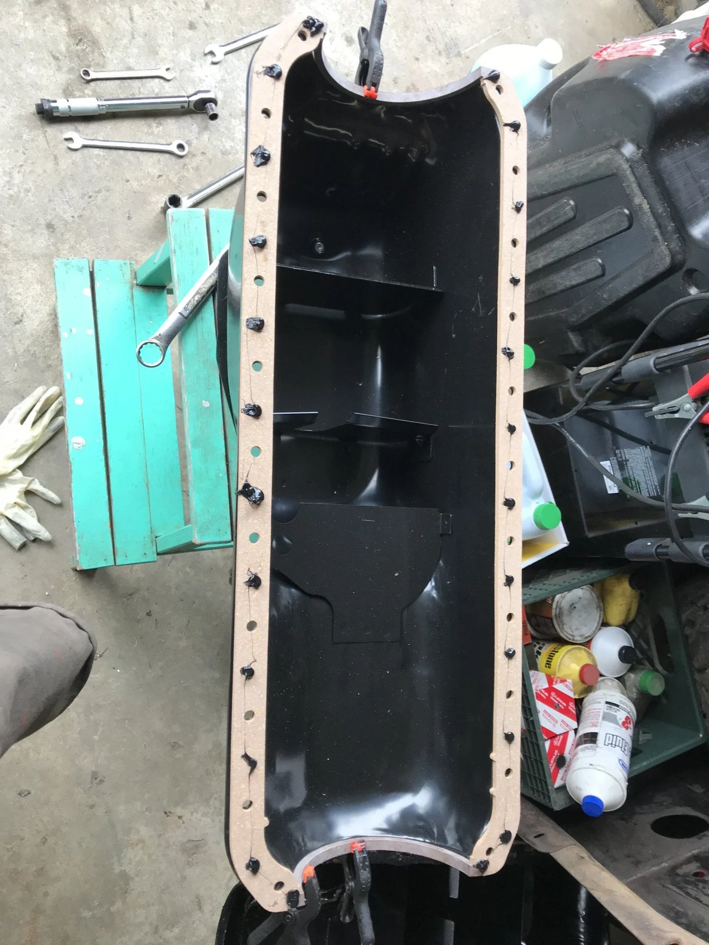

Finally got around to redoing the oil pan for the second time. This time with a new pan. This made it somewhat easier I guess. I learned a couple new tricks this time around.
1. SnapUps. These things are well worth it. Buy 12 of them or 3 packs so you can put them in every other hole.
2. Get two longer bolts than the stock pan bolts. You use these to help you "land" the pan as the stock bolts are a bear to get seated cause they are so short and the cork needs to compress slightly to get the bolts to grab.
I also bought a 1/4 inch Harbor Freight torque wrench and torqued all the bolts in sequence working my way from the middle outwards. Setting the wrench to 55inch pounds then going back around again to get to 69inch pounds.
I also dumped the coolant again and put a new oil cooler hose on as I forgot to do this when I had the rad off and it started leaking.
There is still a slight oil leak seemingly coming from the timing gear cover so i tightened those down a bit by hand again. We'll give it a few more heat cycles and see if it needs another couple turns.

Nice job man. Really like the snapup's idea! Wish I had those when I was doing the oil pan on my old crawler..

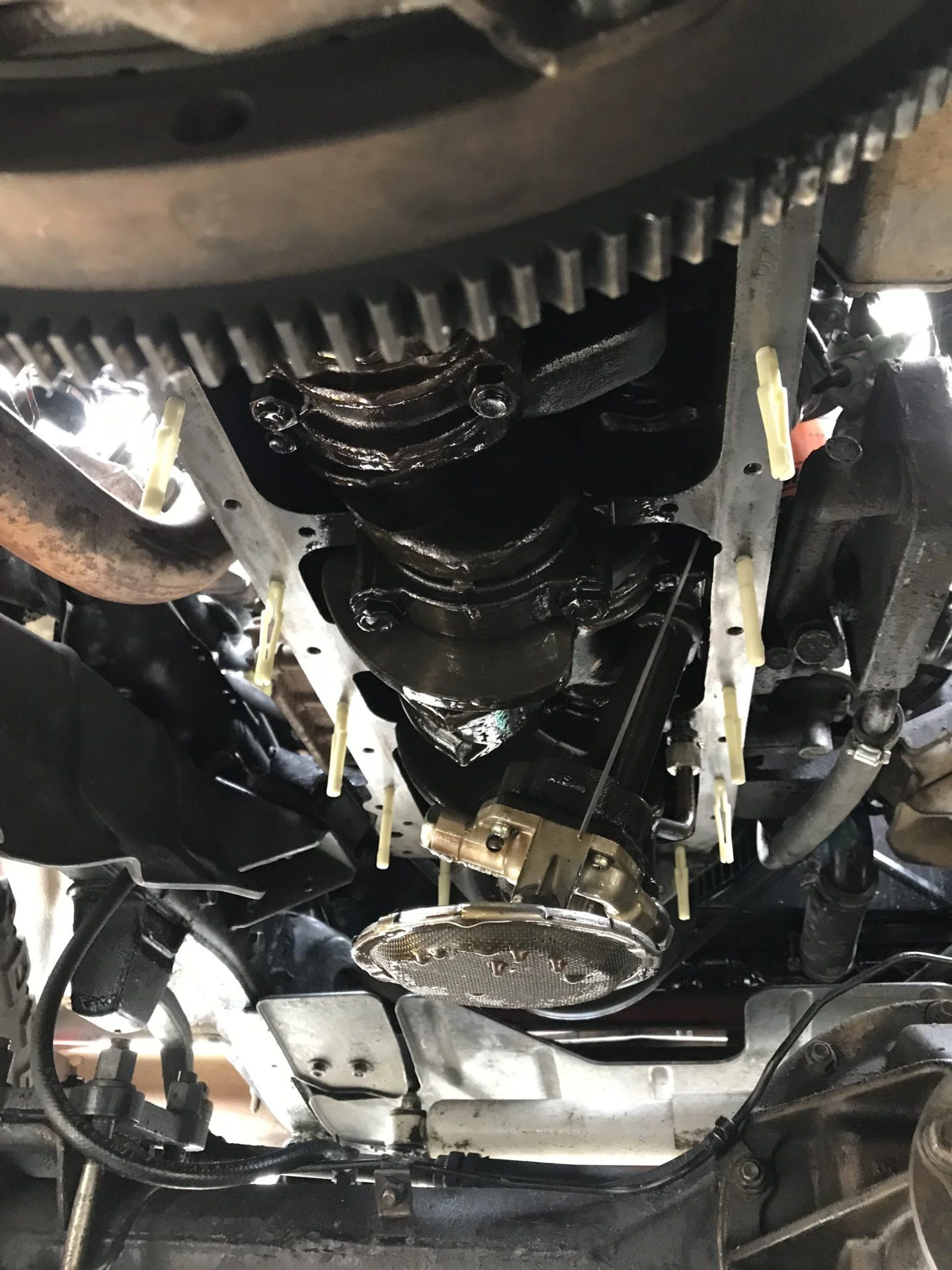

Could it be the oil squirter? I’m not there yet on my engine restore, but I have read many times that the oil squirter that screws into the timing plate gets screwed in too far and hits the block pushing the plate out just slightly enough that it causes a leak, and it comes from the bottom of the timing cover.
There’s no need to even touch the squirter if your doing the timing gear cover gasket. When I had my cam out which THEN allowed me to take timing gear plate off I didn’t even touch the squirter. It was staked and there was no need to break the stake and mess w/ the in or out depth of the squirter.
Yeah I did not mess with the squirter to re-do the timing cover. I had always read the squirter issue could be the cause of a plate seal leak, but don't recall ever reading it to be the cause of a TC seal leak. Maybe so but not something I had ever seen. I guess it could distort the plate enough to not provide a flat surface for the TC to seal to, but seems unlikely based on my experience. Can someone confirm that?

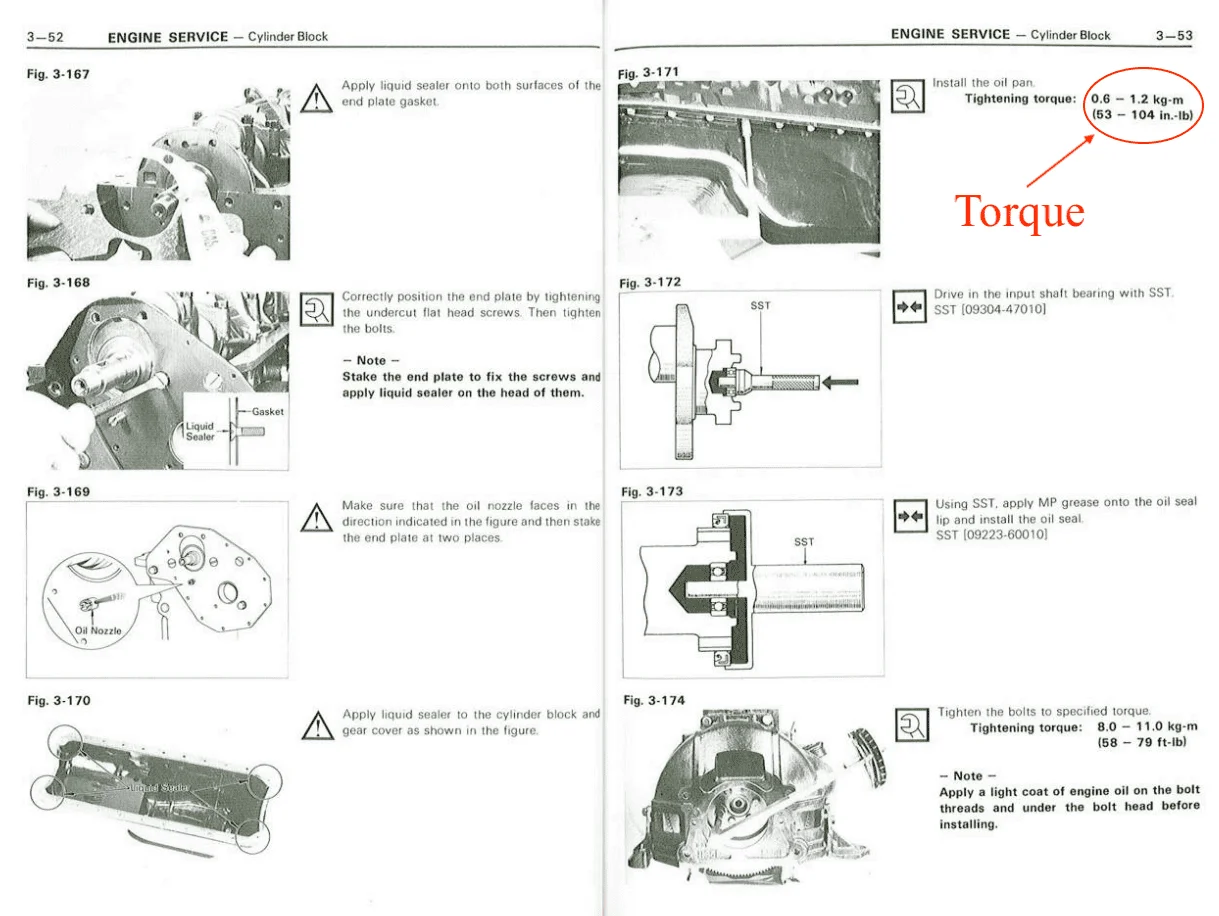

@joebattle1 did you really say you torqued the oil pan bolts to 75”/lb? My memory says they aren’t supposed to be more than 10”/lb.
He said, it’s just by the backside of the timing cover.
What I miss???
Yep being curious now, I checked my FSM and it says same as yours Joe. 53-104 inch pounds. Screw me and carry on. :)
@NeverGiveUpYota Maybe you're thinking in "Foot Pounds". Scared the crap out of me though... Had to go dbl check I wasn't crazy AND stupid. :D
That could be it. Even so tho if you divide 75 by 12, you get 6.25 feet/pound and 104 would be 8.66 feet/pound... so I’m not sure where I got 10. :meh:
3FE Manual says 69 inch lbs.
